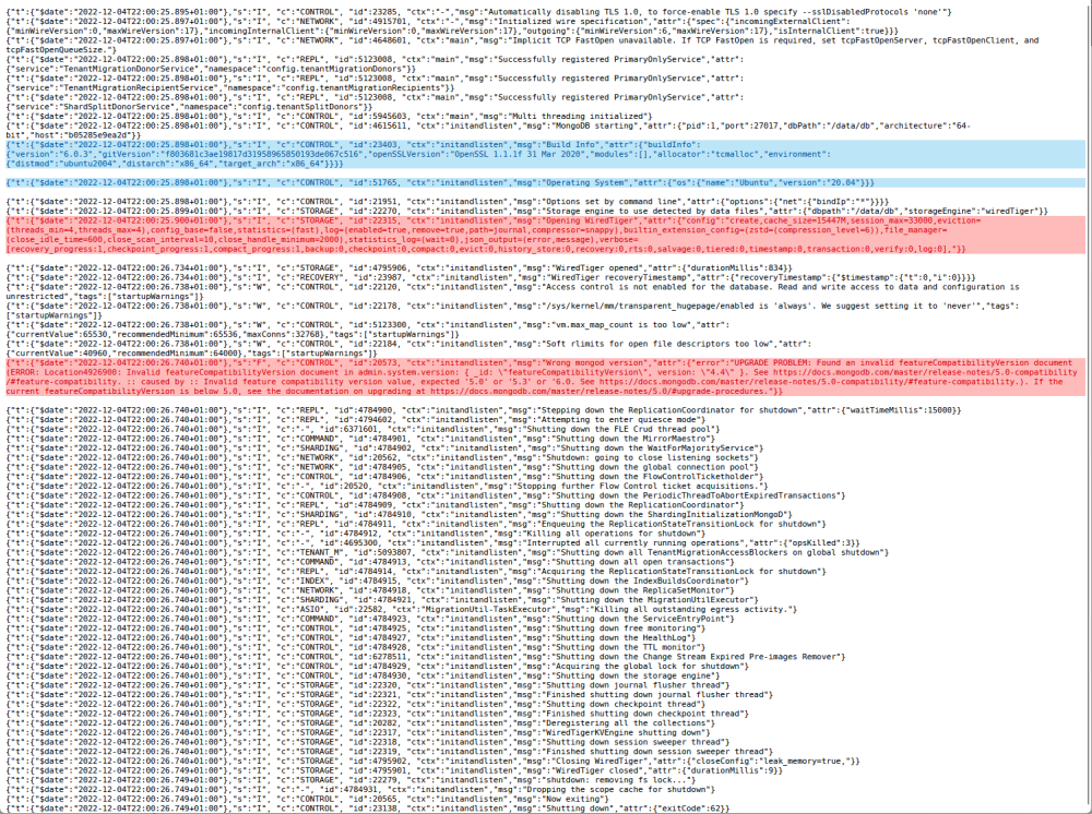

My MongDB container no longer stays running. This started after a recent update, but no other action taken or config changes. I see the following in the logs:
{"t":{"$date":"2023-08-23T08:35:12.363-05:00"},"s":"F",  "c":"CONTROL",  "id":20573,   "ctx":"initandlisten","msg":"Wrong mongod version","attr":{"error":"UPGRADE PROBLEM: Found an invalid featureCompatibilityVersion document (ERROR: Location4926900: Invalid featureCompatibilityVersion document in admin.system.version: { _id: \"featureCompatibilityVersion\", version: \"5.0\" }. See https://docs.mongodb.com/master/release-notes/6.0-compatibility/#feature-compatibility. :: caused by :: Invalid feature compatibility version value '5.0'; expected '6.0' or '6.3' or '7.0'. See https://docs.mongodb.com/master/release-notes/6.0-compatibility/#feature-compatibility.). If the current featureCompatibilityVersion is below 6.0, see the documentation on upgrading at https://docs.mongodb.com/master/release-notes/6.0/#upgrade-procedures."}}
Does anyone know how to solve this issue?
I just encountered the same problem with the same error:
{"t":{"$date":"2023-08-23T23:31:04.280+02:00"},"s":"F",  "c":"CONTROL",  "id":20573,   "ctx":"initandlisten","msg":"Wrong mongod version","attr":{"error":"UPGRADE PROBLEM: Found an invalid featureCompatibilityVersion document (ERROR: Location4926900: Invalid featureCompatibilityVersion document in admin.system.version: { _id: \"featureCompatibilityVersion\", version: \"5.0\" }. See https://docs.mongodb.com/master/release-notes/6.0-compatibility/#feature-compatibility. :: caused by :: Invalid feature compatibility version value '5.0'; expected '6.0' or '6.3' or '7.0'. See https://docs.mongodb.com/master/release-notes/6.0-compatibility/#feature-compatibility.). If the current featureCompatibilityVersion is below 6.0, see the documentation on upgrading at https://docs.mongodb.com/master/release-notes/6.0/#upgrade-procedures."}}
I did a quick google and followed some links but no solution was found.
I temporary forced the docker to use mongo:5.0 and all is good (for now)

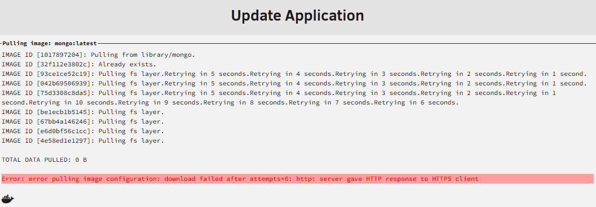

MongoDB update (official container) not working anymore since a few days (all other docker updates works fine). Any ideas?
Problem found/solved! My ADGuard DNS filter suddenly started blocking a page that is necessary for the update.

My MongoDB1 won't start anymore. I tried to upgrade to unraid 7.2.0 and it didn't come up, so I went back down to 7.1.4 and it still won't come back up. Any idea's what I need to do?
{"t":{"$date":"2025-11-02T09:13:34.550-06:00"},"s":"F", "c":"CONTROL", "id":20573, "ctx":"initandlisten","msg":"Wrong mongod version","attr":{"error":"UPGRADE PROBLEM: Found an invalid featureCompatibilityVersion document (ERROR: Location4926900: Invalid featureCompatibilityVersion document in admin.system.version: { _id: \"featureCompatibilityVersion\", version: \"7.0\" }. See https://docs.mongodb.com/master/release-notes/8.0-compatibility/#feature-compatibility. :: caused by :: Invalid feature compatibility version value '7.0'. Expected one of the following versions: ''8.2', '8.1', '8.0'. See https://docs.mongodb.com/master/release-notes/8.0-compatibility/#feature-compatibility.). If the current featureCompatibilityVersion is below 8.0, see the documentation on upgrading at https://docs.mongodb.com/master/release-notes/8.0/#upgrade-procedures."}}
I have the same problem. I use MongoDB for Your_Spotify, but the database just stops itself. I cannot see any logs either
It gives you a link to the upgrade procedures. Just follow them.
And also dont use :latest if you dont know the consequences of it.
But if you need the TL;DR:
1) Change image to mongodb:8.0
2) Start Container
3) Connect to the admin database: docker exec -it MongoDB mongosh admin
4) Run the upgrade command: db.adminCommand( { setFeatureCompatibilityVersion: "8.0", confirm: true } )
