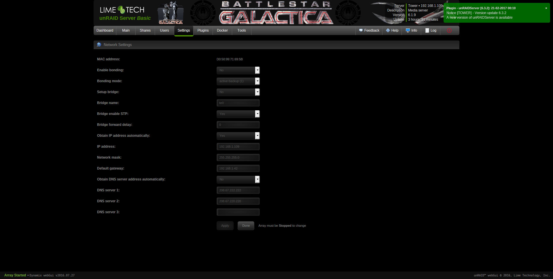

Regarding DNS, I'm using OpenDNS. I tried several settings but no success. The suprising thing is it worked for a while, as I have this unRaid NAS for about a year already.
Here is the screenshot

3 minutes ago, Corius said:
ok, so, I did the manual update, by replacing the bz* files on the flash drive, and after the reboot I just can't open my unRaid in firefox. I can access my shares in windows explorer though. How do I get back my NAS in firefox ?
here is my diagnostics if needed:
tower-diagnostics-20170222-2223.zip
Try using      http://192.168.1.109
If you can, the your router does not 'know' that that  IP address is called "tower".
And can you reach your router using     http://192.168.1.42 ?    If not, you have the wrong entry for the Default Gateway.
