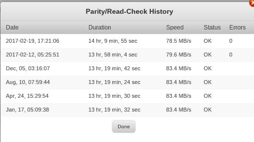

This upgrade DID, however, add even more time to parity checks.    I know it's irrelevant, but it's nevertheless a bit frustrating to see these times keep getting longer.  The system shown below is a dual core Pentium E6300 -- an older setup (one of the main UnRAID servers sold by Limetech several years ago) with a PassMark of 1761.  It does NOT show 100% utilization during the checks (although it tends to stay at 50% or a bit over) ... but this used to take under 12 hours (v5), then grew to a very consistent 13:19 with v6.1;  then 13:58 with 6.3.1, and now takes 14:10 with 6.3.2.  All of these times are with NO GUI active during the checks -- I start the check; let it run overnight; and then look at the GUI the next day to see how long they took.
Just curious if those with higher-powered systems are seeing this same increase in times (I suspect not -- it's probably just due to the older CPU and/or only 2 cores).

As I noted earlier, I upgraded two of my servers to 6.3.2 with no issues.
This upgraded DID, however, add even more time to parity checks.    I know it's irrelevant, but it's nevertheless a bit frustrating to see these times keep getting longer.  The system shown below is a dual core Pentium E6300 -- an older setup (one of the main UnRAID servers sold by Limetech several years ago) with a PassMark of 1761.  It does NOT show 100% utilization during the checks (although it tends to stay at 50% or a bit over) ... but this used to take under 12 hours (v5), then grew to a very consistent 13:19 with v6.1;  then 13:58 with 6.3.1, and now takes 14:10 with 6.3.2.  All of these times are with NO GUI active during the checks -- I start the check; let it run overnight; and then look at the GUI the next day to see how long they took.
Single or Dual parity?  I will run checks on both of mine tonight and report tomorrow morning.

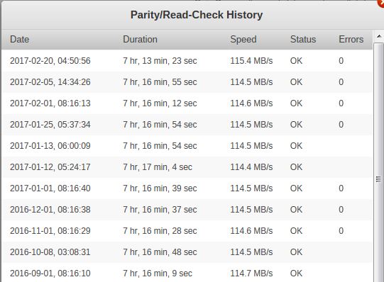

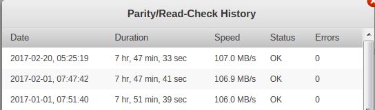

Here are the results of my two servers.  Spec's for both are listed below:  (Since this is the new BBS software, I am not quite sure how it will look.  So I apologize if there is an issue. I sure so miss the preview feature of the old software...)
Top Screen shot is for the Dual Parity Test-Bed Server.  Bottom screen shot is for the Single Parity Media Server.  (New software hides the descriptive file name!)
