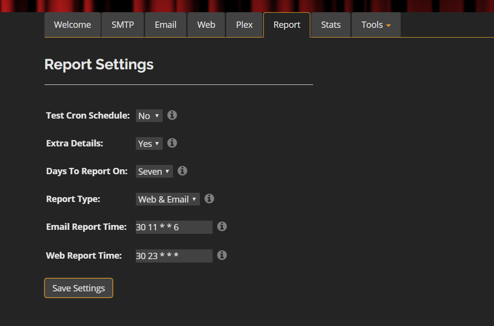

For whatever reason, it has suddenly stopped sending automated emails according to the cron schedule. Test reports work fine. On-demand reports work fine. But it doesn't automatically send per schedule. Been this way a few weeks now it seems.
Anywhere I should look, specifically, for issues?
What does your report settings page look like in the GUI?
Also show me the output of the following command:
docker exec NowShowingv2 sh crontab -u xyz -l
sh: can't open 'crontab'
that's what I get when running the command.

12 hours ago, Chad Kunsman said:
Here we go:
/ # crontab -u xyz -l
30 23 * * * webreport -d &> /dev/null
30 11 * * 6 emailreport -d &> /dev/null/
I executed crontab from within the container and it worked, then. Result has been pasted.
@Chad Kunsman and @nerbonne

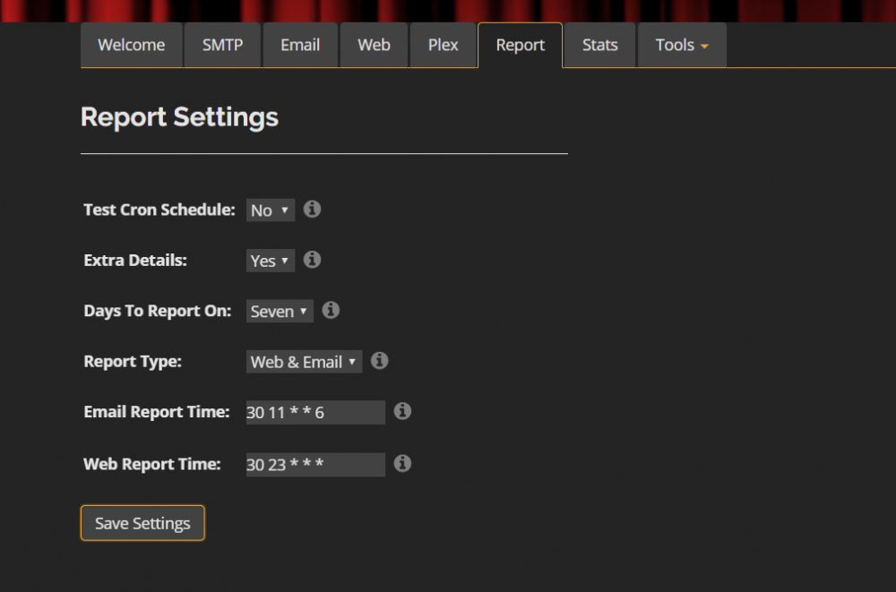

Alright, so the internal cron looks like it set correctly to what you specified in the GUI so I don't see any issue there.
Try this next. Go into the web gui. Set test cron schedule to 'yes' on the report tab. Select web & email for report type. The enter in cron times for the web and email. Make the cron's like 5 minutes apart and to go off in the next 30 min's. This should only send an email to your main plex account and also generate the website.
Wait like 5 minutes after your last cron time to give the report time to run. Then show me your NowShowing and Docker logs. Also let me know what time you specified in your cron settings to cross-reference the log timestamps.
