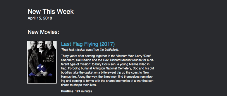

This isn't a major issue, but I notice that I never get extra details even though I have them enabled (not even really sure how they should appear).
Edited by wgstarks
spelling
The web does not have extra details. Only the email. That would be too much information to try and fit cleanly on the website.
If you run a test email with extra extra details and then again without you will see the difference. Extra details adds ratings and actors names and director and things like that

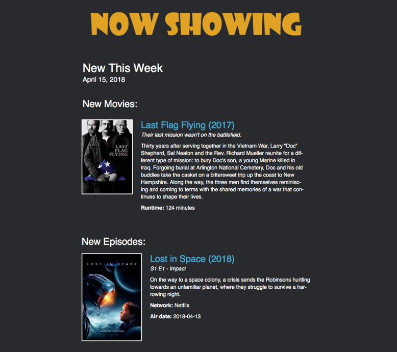

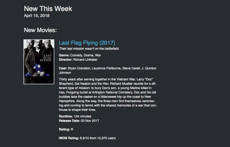

It works for test emails but not for the scheduled ones.
Here is a test email-
Here is a scheduled email with the same settings-

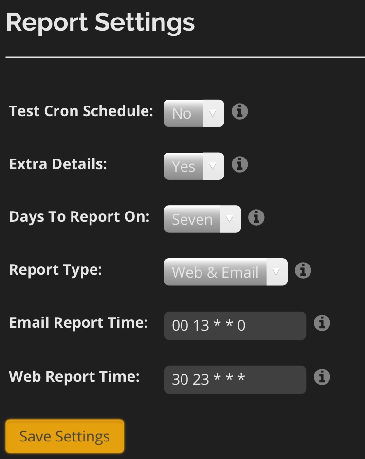

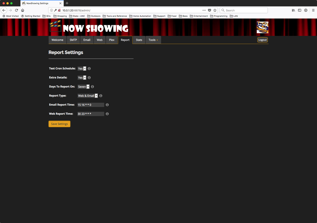

Settings-
Here is the email-
As you can see there are no details included. I've attached my advanced.yaml (redacted).
This only happens when running the report from the cron schedule. If I use "test" or run it on the command line everything works.
Is there a way to increase verbosity in settings so that the cron schedule will generate a more detailed log?
advanced.yaml

I see you have test enabled in your advanced.yaml file, what happens when you set it to disable?
Absolutely right. Set test to no and everything works.???
