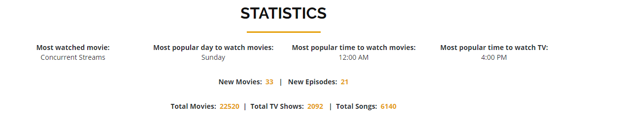

I take it there are no more updates to this docker? I posted a bug back in February on Github that has gone unanswered.
Most watched movie: Last Man Standing (2011)
Most watched TV show: Queen
Most listened to artist:
Most popular day to watch movies: Sunday
Most popular time to watch movies: 9:00 AM
Most popular day to watch TV: Wednesday
Most popular time to watch TV: 10:00 AM
New Movies:  5   |   New Episodes:  22   |   New Seasons:  2
Total Movies:  6698  |  Total TV Shows:  278   |  Total Songs:  22118
Also the color in E-Mail is totally unreadable. It should be the same as the website.

Last post - I just noticed in my stats that the most watched movie is 'Concurrent Streams'.  I've checked in Tautulli and it's reporting correctly The Force Awakens, so the problem isn't there I think.
861469136_FireShotCapture060-NowShowing-192_168_50_15.thumb.png.5fb7f0e3c14f9c75dd28d03e411afc8d.png

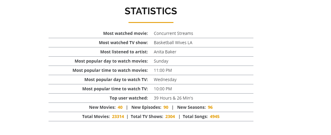

Is anyone else having problems with 'Concurrent Streams' also appearing in stats even if not selected in the first position on the page?  If I select the last 3 options after Concurrent Streams for stats it doesn't appear, but it does if I select any before it.streams.thumb.png.50d08a6ea705606d328b7fed2aa75e8a.png
Happening with me as well.
