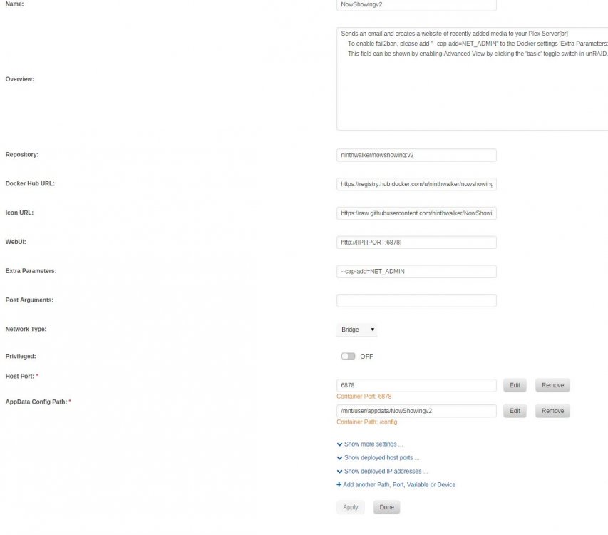

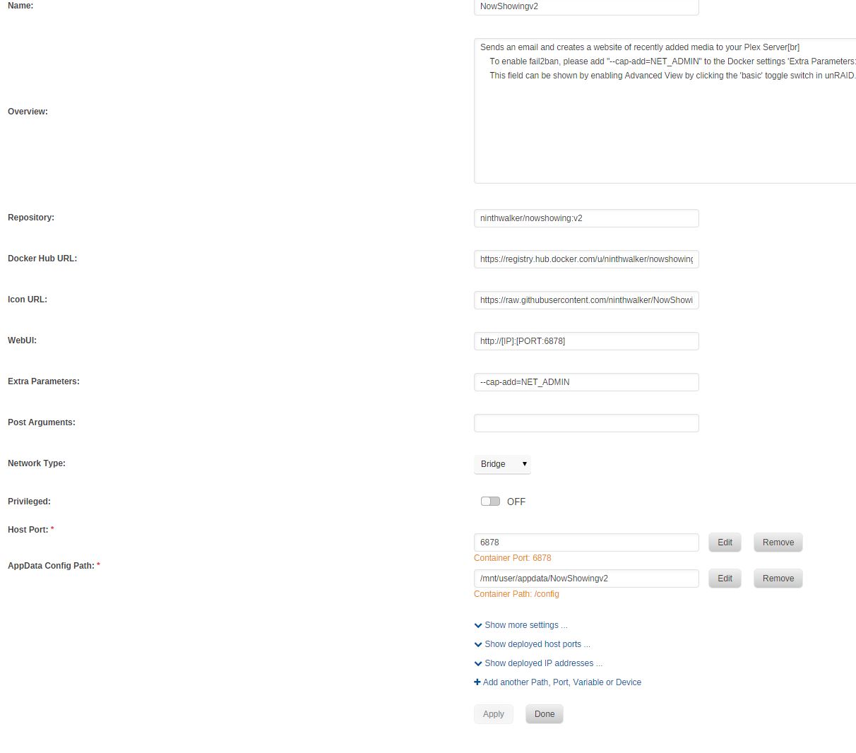

Am I missing something?  I'm trying to install this docker through CA, but the template page I'm seeing doesn't look anything like the others in this thread.  It's missing quite a bit of info.  Yes, I've checked Advanced View.
On 3/6/2018 at 9:46 AM, jedimstr said:
Will 2.0's Library filtering also allow me to skip my HAMA plugin agent based Anime Libraries?
I was an avid plexReport user, but had to stop using it and the subsequent NowShowing replacement because they just failed when encountering my non-standard Libraries.
The new version will allow you to skip any libraries by name.
So if all your anime is on a library called 'Anime' then you can specify to skip that one and it should continue to report on the rest.
I plan on being done end of month with the new version.
It looks like you grabbed the new v2 beta one I am working on.
I am making tweaks to that version still so it isn't quite ready.
(The template looks a lot different since the new version has a web interface now.)
