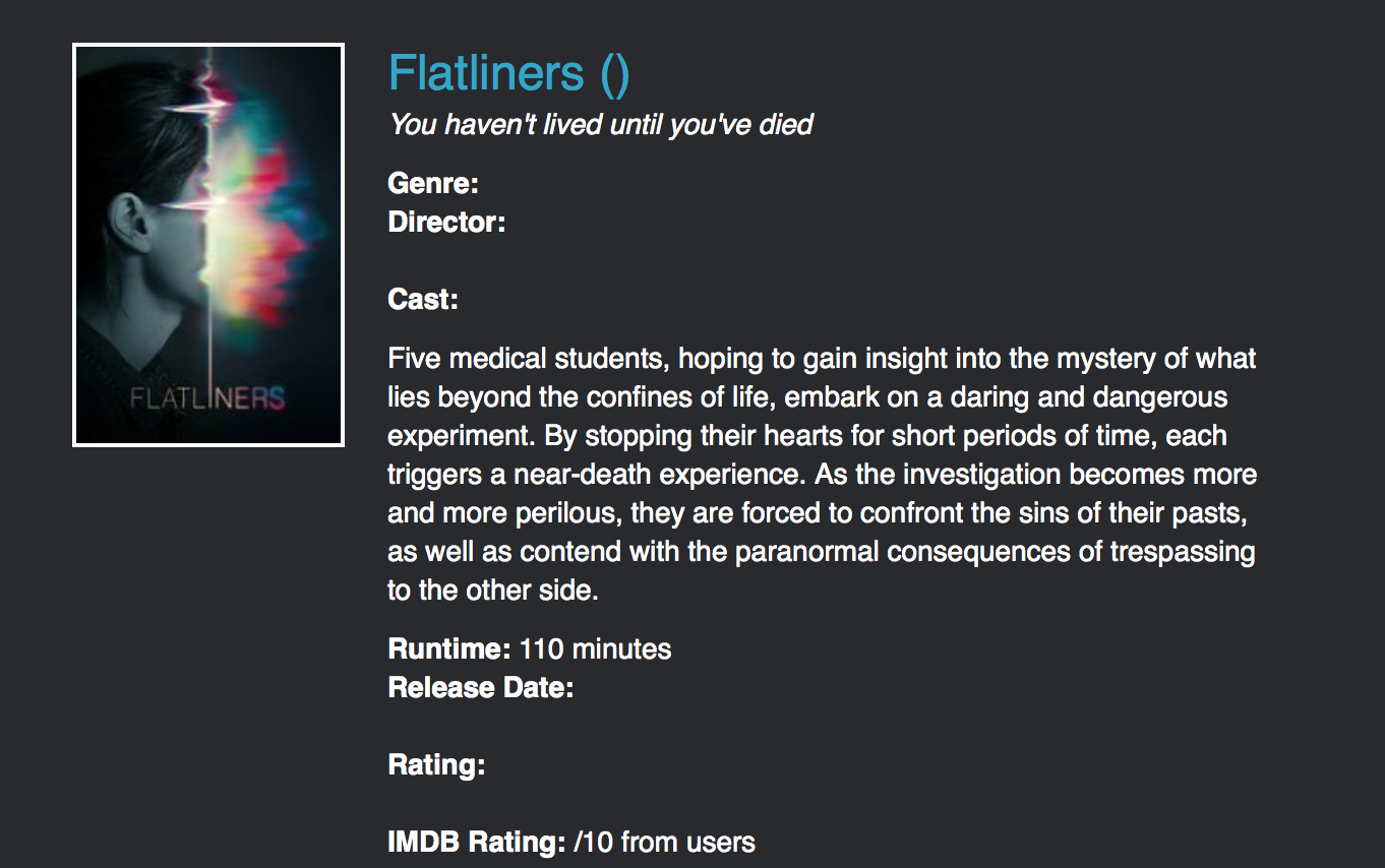

I seem to be getting the issue where the year is not showing up.  Everything else seems to be working fine.  Running the dev release. Anything I can try?
Thanks,
-devros
Use the production branch. This was fixed a while ago. The API that nowshowing uses for metadata was changed and the code had to be updated for that.

Switched branches and all is well.  I thought I had read somewhere that this was fixed in the dev version.  Happy to be on the production branch with everything working.  Thanks for the quick reply!

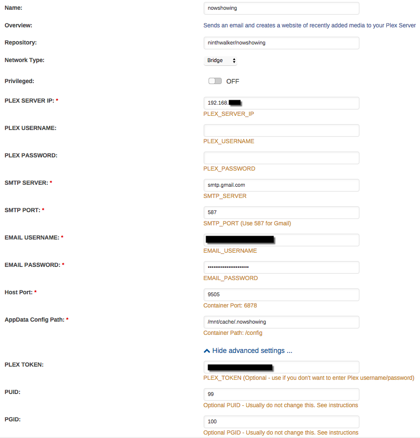

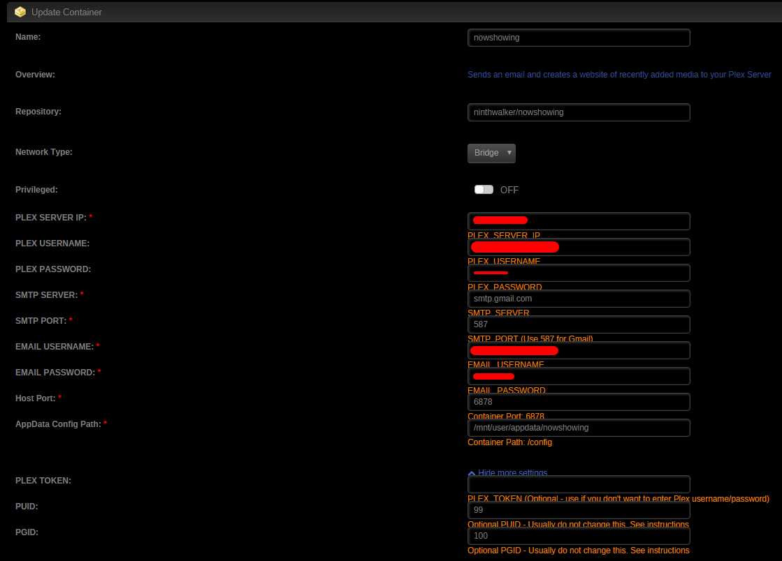

I've attached my docker container setting for nowshowing container. Before I dive in any deeper I'm hoping someone can point me in a better direction.
thank you,

Very new unRaid user here with limited linux experience. I'm struggling to get this docker to make a report but feel like I'm missing something simple.
When I try using: "docker exec nowshowing webreport"
I am getting:
"/usr/local/sbin/webreport: end of file reached (EOFError)"
My configuration is shown below but please let me know what other info is needed to help resolve this likely silly goof-up. I have tried using both my username (it has spaces) and my email for the Plex username field.
5a7b9b1515988_Screenshot2018-02-0718_10_02.thumb.png.c6e3535d7510d8943c781060ab68c155.png
