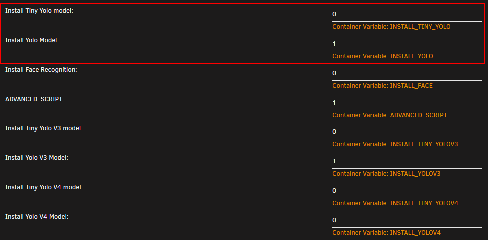

On 10/17/2020 at 2:54 PM, dlandon said:
I have updated the docker with ES 6.0.4.  This will get rid of the compatibility message on the latest version of ZmNinja, but you have to make changes to the objectconfig.ini if you are using hook processing.  Read the note at the bottom of the first post about how to update objectconfig.ini.  If you are not using hook processing, there is nothing you need to do after the update.
Now that the docker installs versions of Yolo, can I safely remove the INSTALL_YOLO docker variables?
Had to re-install the docker for other reasons and those variables are gone.
Edited by PTRFRLL
