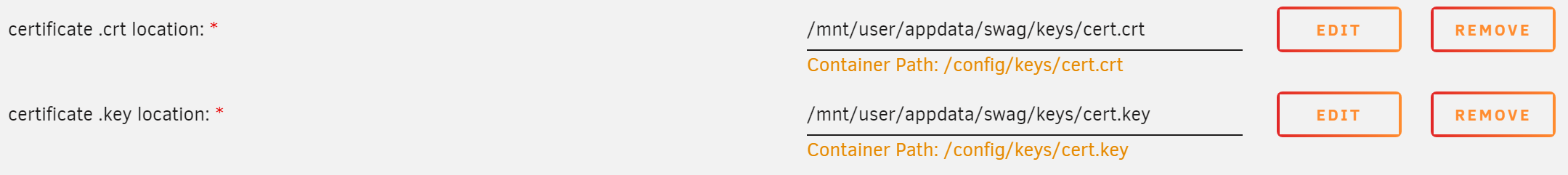

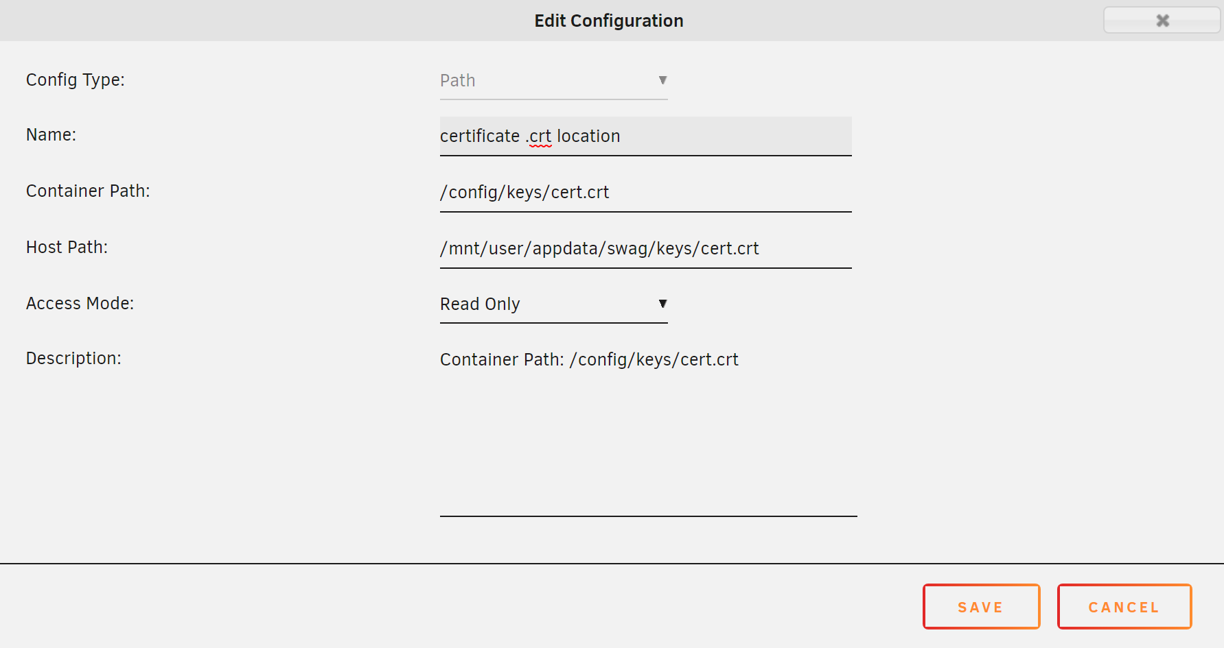

1 hour ago, Jokerigno said:
Hi all, does anyone knows if it is possible to use swag to generate a trusted certificate for ZM avoid warning messages when open ui?
Yes.  Not sure if this is best practice, but here's what I have configured and working:
1. You need to own your own domain so you can assign zoneminder.YOURDOMAIN.ETC
2. Also I have both SWAG and ZM on a separate bridged network per spaceinvanderone's video(s) (along with other stuff).
3. Assign a wildcard cert to yourself so you don't need more than one cert.
4. Point zoneminder's cert folder contents to your swag certs as below:
5. Make sure you setup as read only on both, just in case
So far this works fine for me and doesn't seem to have any serious security faux pas.

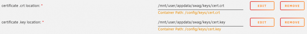

I'm pretty sure if your using a duckdns style setup that this will work with your subdomain only cert setup because ZM uses a subfolder, but I haven't used/setup that sort of config.  Obviously this only covers ZM getting the cert and not swag rev proxy, for that I used the following for my subdomain config, which is basically the default subdomain config:
