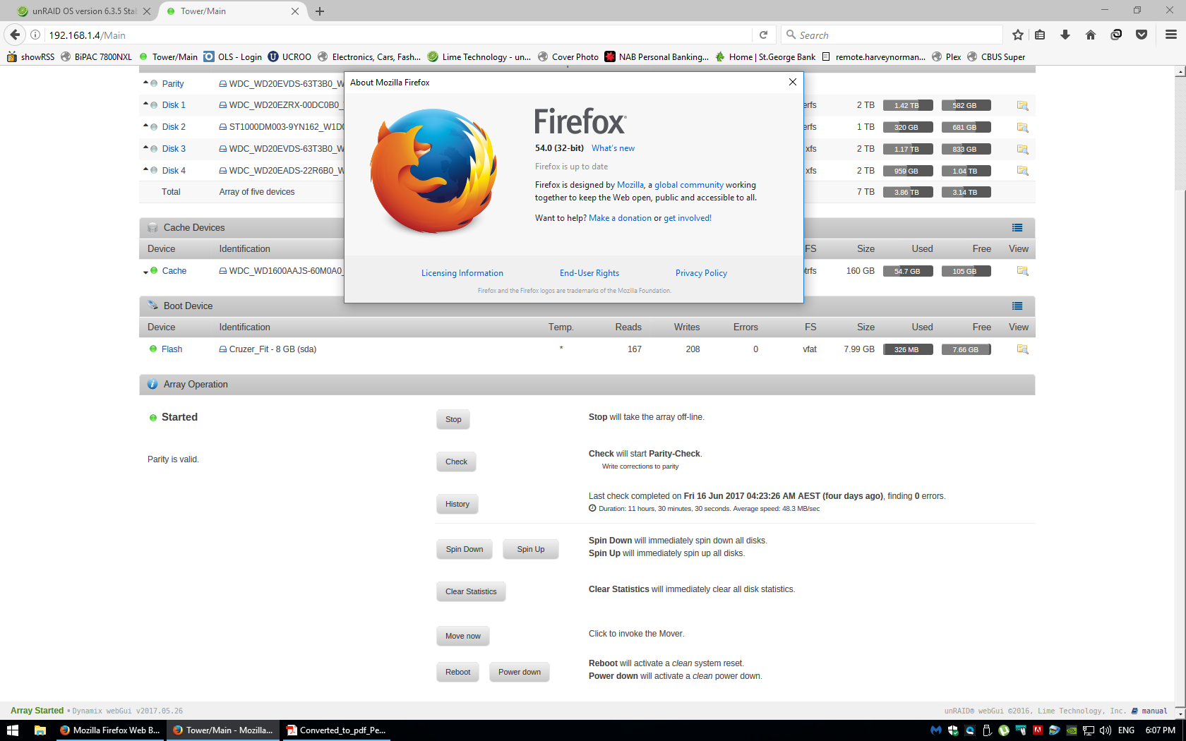

On 17/06/2017 at 0:18 AM, Frank1940 said:
@bonienl
I cleared the browser cache and that didn't fix the problem.
Additional information:  The browser is Firefox version 54.0 (64 bit).   That is the latest Firefox version of this release variant.  (A second observation is that I am having the same problem with version 6.4.0-rc3.)

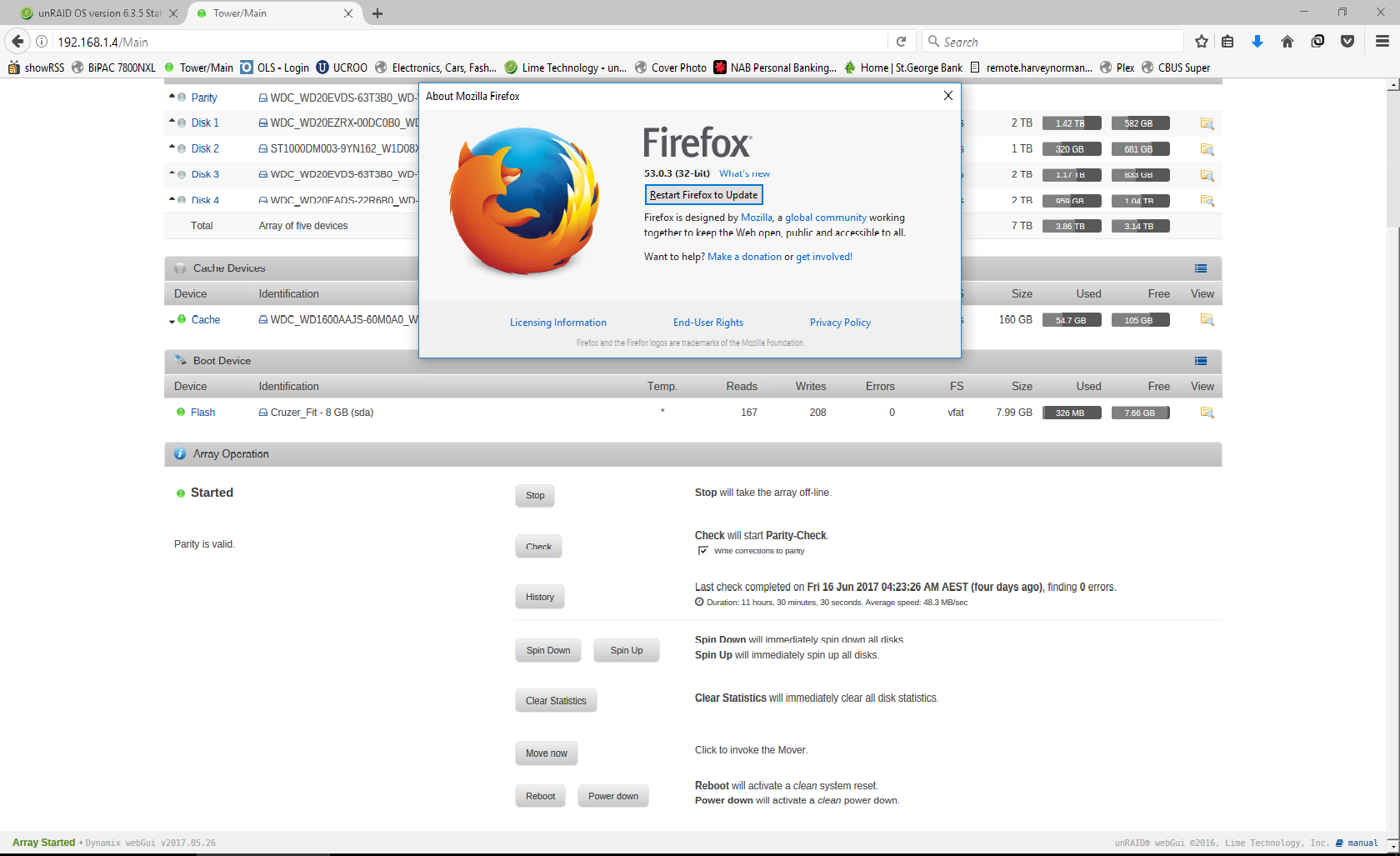

On 17/06/2017 at 0:23 AM, bonienl said:
Firefox version 53 works fine, but version 54 exhibits your problem.
Just checked this also and can confirm the checkbox does disappear when Firefox is upgraded to V54.0
Screenshots attached
There is a bug report with Mozilla. Problem is known, and fixed. Just need to wait for a version with the fix.
Unfortunately, this may be as late as the second week in August if I can read the Firefox release schedule correctly...
