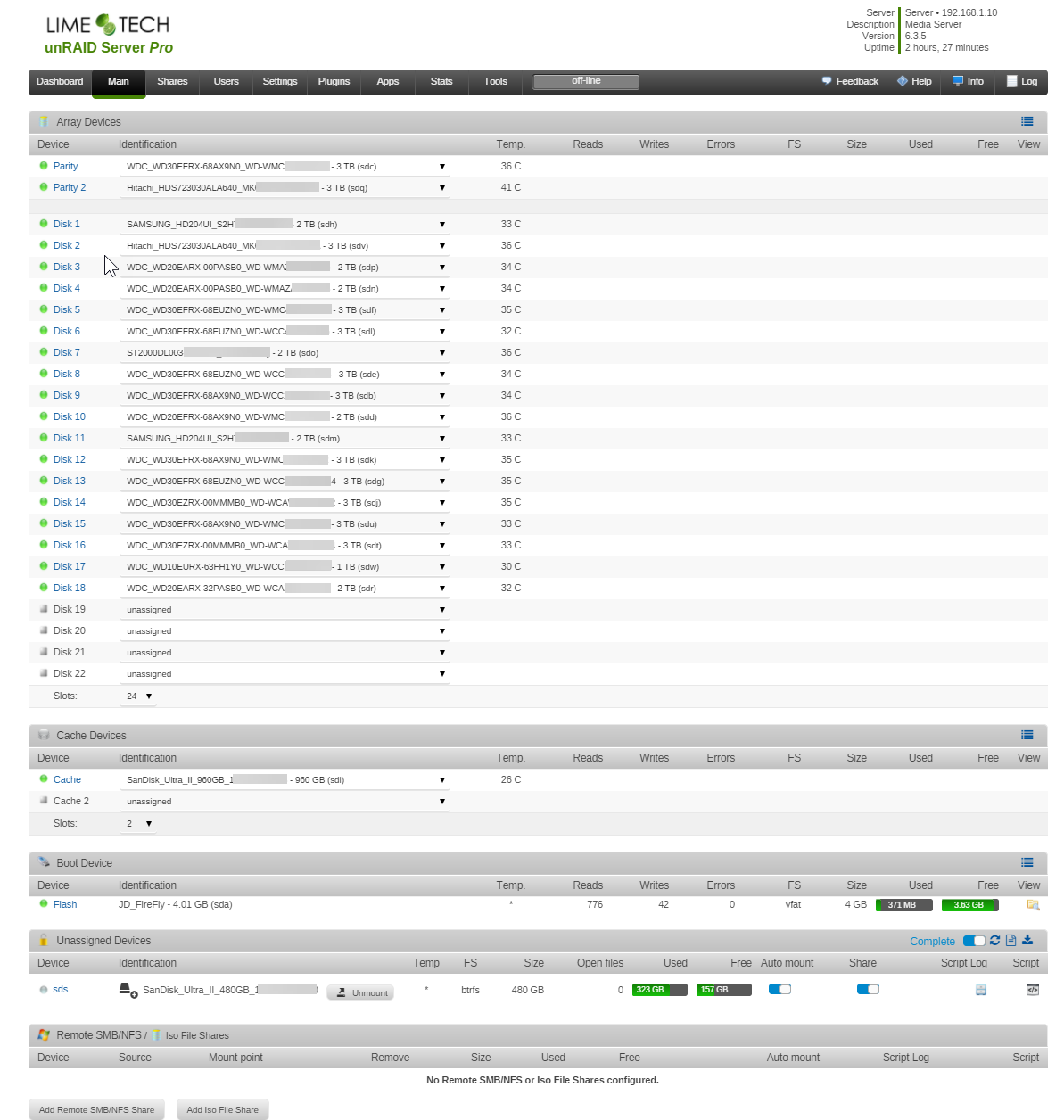

Upgraded to 6.3.5, unable to get past the mounting phase without it locking up now.
Forgot to check here first. I'll add my logs a little later, already spent too long on a day off on this ;) (but I wanted to report it at the very least!).
Edited by brimnac
Correct spelling

Since my machine locks up at the mounting phase (Unassigned Drives and the Flash drive mount still work), I don't know which log to get. The ones I see in my "logs" folder, via the "Flash" share, all look really old. Is there a path or file name I should be looking for?
On the console/SSH type diagnostics, a zip will be saved to your flash drive, upload it.
Thanks for that. I did it once at the very beginning of the mounting process, and it created the zip successfully. I tried creating it again, a little later in the mount (which still wasn't working), and PuTTY locked up. I lost the connection to my server.
I've turned off my Dockers, I've loaded Unassigned Devices before starting the array, I've updated all the other apps I can think of. I have to head out of town for work for a couple of days, so thank you for any help (my wife appreciates it more, since anything I can finish before I leave she'll be able to use ;-)).
I have had issues with past upgrades, but there's always been a fix. Thanks for any help that can be provided!
server-diagnostics-20170612-1840.zip
Edited by brimnac
Grammar, words. Added picture of main array.
