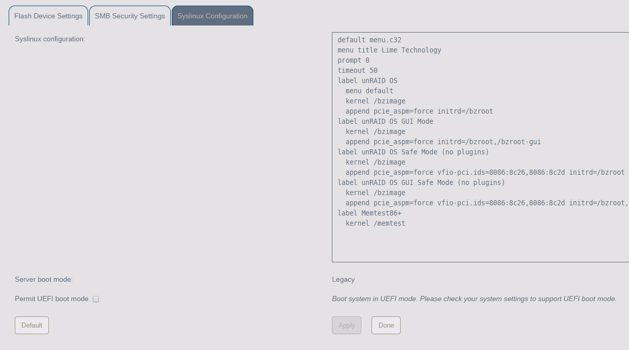

You mean something like this?
Well it's a bit more complicated.  Under the hood all this would do is check if /boot/EFI exists vs. /boot/EFI- directory.  (Also, you can tell how the server was booted by looking for the existence of "/sys/firmware/efi" which will not exist for Legacy boot).
But existence of /boot/EFI on its own does not of course guarantee UEFI boot, it simply permits, or makes possible UEFI boot.  Whether or not motherboard actually uses UEFI boot is subject to motherboard bios settings outside control of unRAID.

I'd put this in the 'Syslinux Configuration' section, kinda like how "Share status" and Delete is handled, that is,
Add label something like "Server boot:"  Legacy/UEFI [determined by existence of /sys/firmware/efi
And a checkbox that says, "Permit UEFI boot".

5 minutes ago, bonienl said:
Is this more to your liking?
Winner Winner Chicken Dinner!

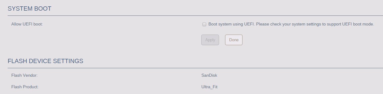

I'm purchasing a UEFI motherboard soon hopefully. What is the procedure for changing the USB?
Figured it out, for anyone looking... Main - Flash - Tick Box at the bottom!
