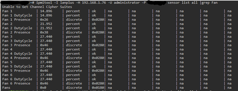

Hello, has anyone been able to adjust their fan thresholds with ipmitool? I can't see what they're supposed to be as they just come as "na" when I run the command so I'm not sure what would be a safe value to set it to. Additionally I tried using raw commands but none went through, I can't seem to find HPs documentation for it. I have a DL380 Gen9.
If this should be posted elsewhere let me know, I'm new.

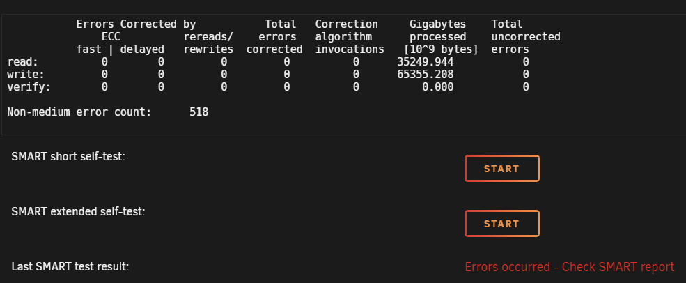

So i am running an HP HBA 222 on my DL380P G8 with 3,5" HP SAS Disks attached. They show up just fine on unraid, smart is partial readable compared to my Crucial MX500s - on the HP Disks, i am getting the following error:
Non-medium error count: 518.
The numbers seem to be not increasing, only when booting up, it adds like one counter to it. Should i be worried or is it possible to get rid of those errors?

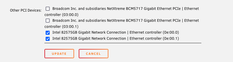

i'm new in virtualisation with unraid. In my HP Proliant ML310a Gen8 is a 4-Port Intel Pro Gbit-Network Card installed. In the VM Manager Settings i have PCIe ACS Override set to Downstream and AVFIO allow unsafe interrupts set to yes.
Now i have 4 separate IOMMU Groups for each Ethernet Port on the Intel Network Card:
IOMMU group 17:			 	[8086:10d6] 0d:00.0 Ethernet controller: Intel Corporation 82575GB Gigabit Network Connection (rev 02)
IOMMU group 18:			 	[8086:10d6] 0d:00.1 Ethernet controller: Intel Corporation 82575GB Gigabit Network Connection (rev 02)
IOMMU group 19:			 	[8086:10d6] 0e:00.0 Ethernet controller: Intel Corporation 82575GB Gigabit Network Connection (rev 02)
IOMMU group 20:			 	[8086:10d6] 0e:00.1 Ethernet controller: Intel Corporation 82575GB Gigabit Network Connection (rev 02)
Group 17 and 18 are used for my Server-Network Connection to my Switch. Group 19 and 20 i wanna pass through to an Virtual Machine (Ubuntu). For this is have activated the Checkboxes for IOMMU Group 19 & 20 in Tools/System Devices and have activated this setting with BIND SELECTED TO VFIO AT BOOT. After the reboot of Unraid i can select the two PCI devices in the Settings of the VM. But if i wanna start the VM i become an error message:
Execution error
internal error: qemu unexpectedly closed the monitor: 2021-06-27T12:16:08.524836Z qemu-system-x86_64: -device vfio-pci,host=0000:0e:00.0,id=hostdev0,bus=pci.4,addr=0x0: vfio 0000:0e:00.0: failed to setup container for group 19: Failed to set iommu for container: Operation not permitted
The same thing happens if i want to pass hrought the HP Broadcom Networkdevices.
What is wrong here?
Thank you!
Execution error
What is wrong here?
Thank you!
look in your logs to see if the following appears
Device is ineligible for IOMMU domain attach due to platform RMRR requirement.  Contact your platform vendor.
if so, this is the fix:

Hello all,
I’m coming back on the hardware passthrough problem since I’m having a wierd issue.
I’m running unraid pro 6.9.2 on an Hp Ml350 with 16disks installed. Bios P92 (2015) out of warranty and not upgradeable anymore. 10Gbe mellanox card as the only ethernet connction in use. Two Vm are up and running reasonably stable. I have the integrated quad nic not in use at the moment, the four nic are located in the same IOMMU group and are bonded to vfio at startup. I can’t see them in the unraid dashboard. so I tried to set up a Pfsense Vm to play with.  The machine did not want to passthrough the nic card giving the “inelegible hardware error..” which is related to the rmrr issue in Hp server.
I then pathed the image and added ‘intel_iommu=relax_rmrr vfio_iommu_type1.allow_unsafe_interrupts=1” to the flash.
Grep command says rmrr are relaxable, so I assumed the patch worked.
when I set up the Pfsense vm I check the broadcom cards (NetXtreme BCM5719) to pass through, I removed the virtual network adapter.
As soon as I start the Vm to begin with installation the whole system hangs, crashes and reboots with parity check and the VM tab in dashboard not enabled.
If don’t passthrough the nic card, just virtual nic adapter, the pfsense install starts normally without issue.
Any help would be welcome, I’m posting my log file and some screen shots
thanks in advance
homeserver-syslog-20211208-0857.zip
5 hours ago, mo679 said:
Hello all,
thanks in advance
for some reason I'm unable to view your syslog... I can't unzip it. not sure why.
Are you using the onboard raid controller? A long time ago I ran into problems with it even being enabled causing issues when trying to also use onboard networking.
are you booting in legacy mode?
Thanks sir for your reply, I’m not using the onboard raid, I removed the board and connected directly to the motherboard, I’m also using an Lsi pcie card.
I patched the image following the aforementioned instructions and seems active,
I will post a new syslog
Complete diagnostics please
Hello, i tried using virtual adapter, without passtrough and the pfsense Vm booted up but then hangs since it finds no nic cards, just to see if the installer was valid.
I’m booting in uefi mode.
i found a rom firmware p92-2.72. From 2019, my bios is from 2015, might it be the rmrr issue was addressed?
thanks in advance
