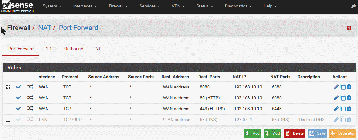

I'm having difficulty getting this one to work. I end up unable to access the Dockers remotely from the WAN.
First, I forwarded ports in my firewall:
Then I have installed and configured traefik with this traefik.toml config:

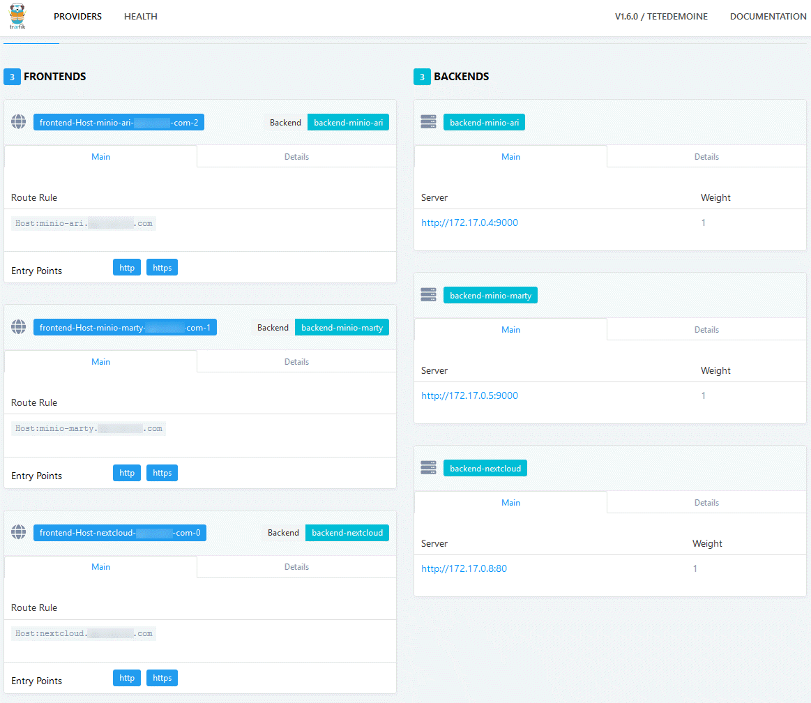

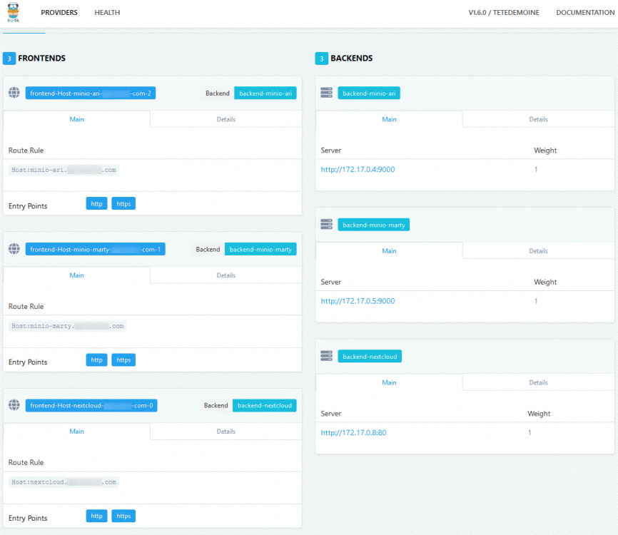

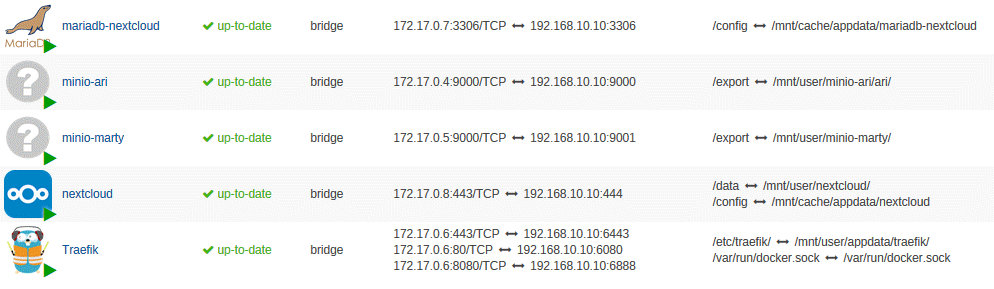

So I have these dockers running:
And then here's what I see in Traefik's Web UI:
But I still can't get to the dockers from the WAN. Trying to get to the NextCloud and Minio dockers using the host addresses listed in Traefik (e.g. https://nextcloud.mydomain.com) without success.
What am I missing here?
Thanks,
Ari
adoucette: the linuxserver nextcloud container only exposes the tls port (443), are you sure you can use port 80?
In order to get my services set up with Traefik I had to add this to traefik.toml (top level) in order to allow self signed certs in the containers running on https
insecureSkipVerify = true
You will also have to set the labels for the service
traefik.protocol=https
traefik.port=443
Edited by JimL
