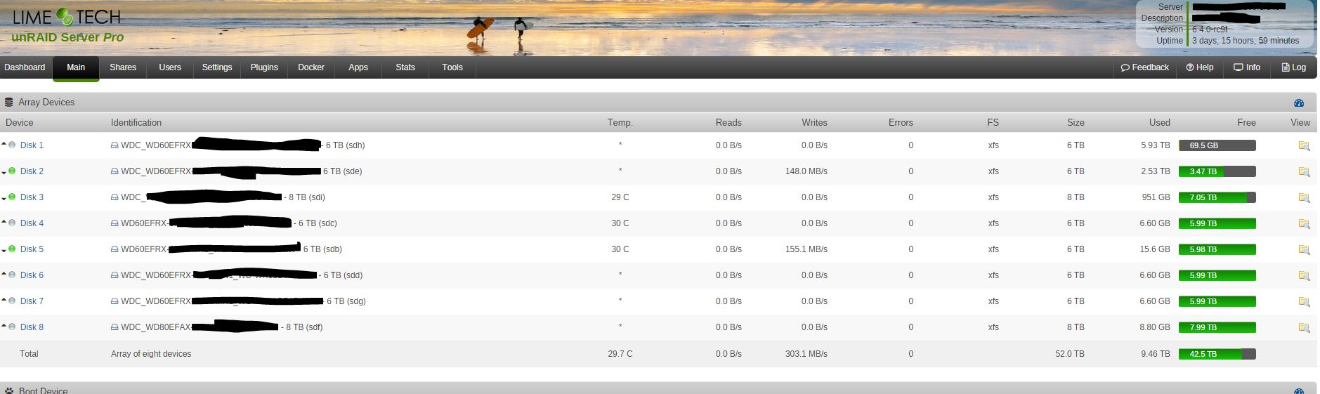

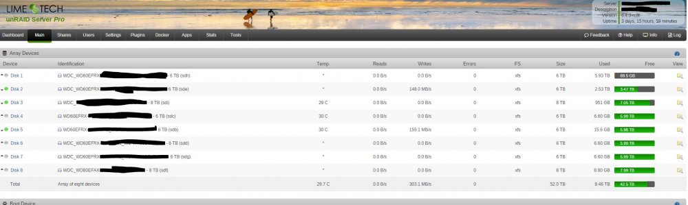

August 26, 20179 yr Author 55 minutes ago, tr0910 said: What is you use case where you are needing better write speed? It's a weak case perhaps but I love to tinker. I now have two UnRAID Pro Servers, 14+ disks each, one primary, one for backup. On the backup server, since it's new for me, never had a backup before! I tried to use split level and am in the progress of migrating a bunch of data from individual disks through the UnRAID user shares to force split level. Even though I'm not using parity a disk, its an unprotected array, it's time consuming because I can only write to one disk at a time. If I could migrate for example two source disks (1st disk Movies, 2nd disk TV) at the same time each to a user share that is not overlapping on physical disks with each other using, then parallel disk writes would be achieved. I think I can manually force this to occur through modifying the excluded/included disks of the share, so it's led me to some more theories on how to achieve this even if I had parity enabled. Perhaps in this there is a method for the future, when I want to push a backup from my primary server to my backup server, of both Movies and TV in parallel and achieve dual writes in the process. I have an idea of how this would work achieving parallel write speeds even with there being a parity drive (thus overcoming the limitation imposed now by a parity disk) I just need more time to write it and build diagrams. Edited August 26, 20179 yr by Lev
