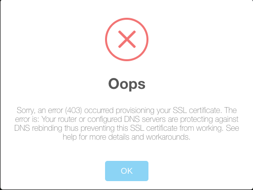

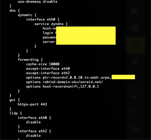

I still cannot provision SSL
I have the binding on my Unifi USG set as seen in my first screenshot using cat /config/config.boot my USG has not rebooted or been force provisioned while i work on the config.gateway.json

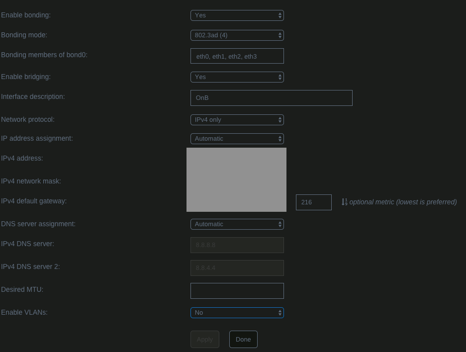

The array is stopped, the Use SSL/TLS is set to auto
I still get the error that my DNS is not allowing binding. (I have unraid set to use Automatic DNS and the USG is using Googles: 8.8.8.8, 8.8.4.4
not sure what else i can do any suggestions?

yeah looks like no matter how valid the config.gateway.json value is i cannot get my USG to bind unraid.net
i go into boot loop with valid json file (verified at jsonlint.com)
my config.gatway.json looks like this in full (not including all the lines)
        "dns": {
            "options": [
                "rebind-domain-ok=/unraid.net/"
my controller (a docker in inraid) reports this
Configuration commit error. Error message: { "DELETE" : { "failure" : "0" , "success" : "1"} , "SESSION_ID" : "1674bc4a090de16838a5f358b7" , "SET" : { "error" : { "dns options rebind-domain-ok=/unraid.net/" : "The specified configuration node is not valid\n"} , "failure" : "1" , "success" : "1"}}

Your json file should look like this:
  "service": {
    "dns": {
      "forwarding": {
        "options": [
  "service": {
    "dns": {
      "forwarding": {
        "options": [
I believe that was the first way i tried it.
trying it again to see.

alas I still get the issues i posted earlier about...an immediate "Opps there was an error" message telling my its cannot rebind
