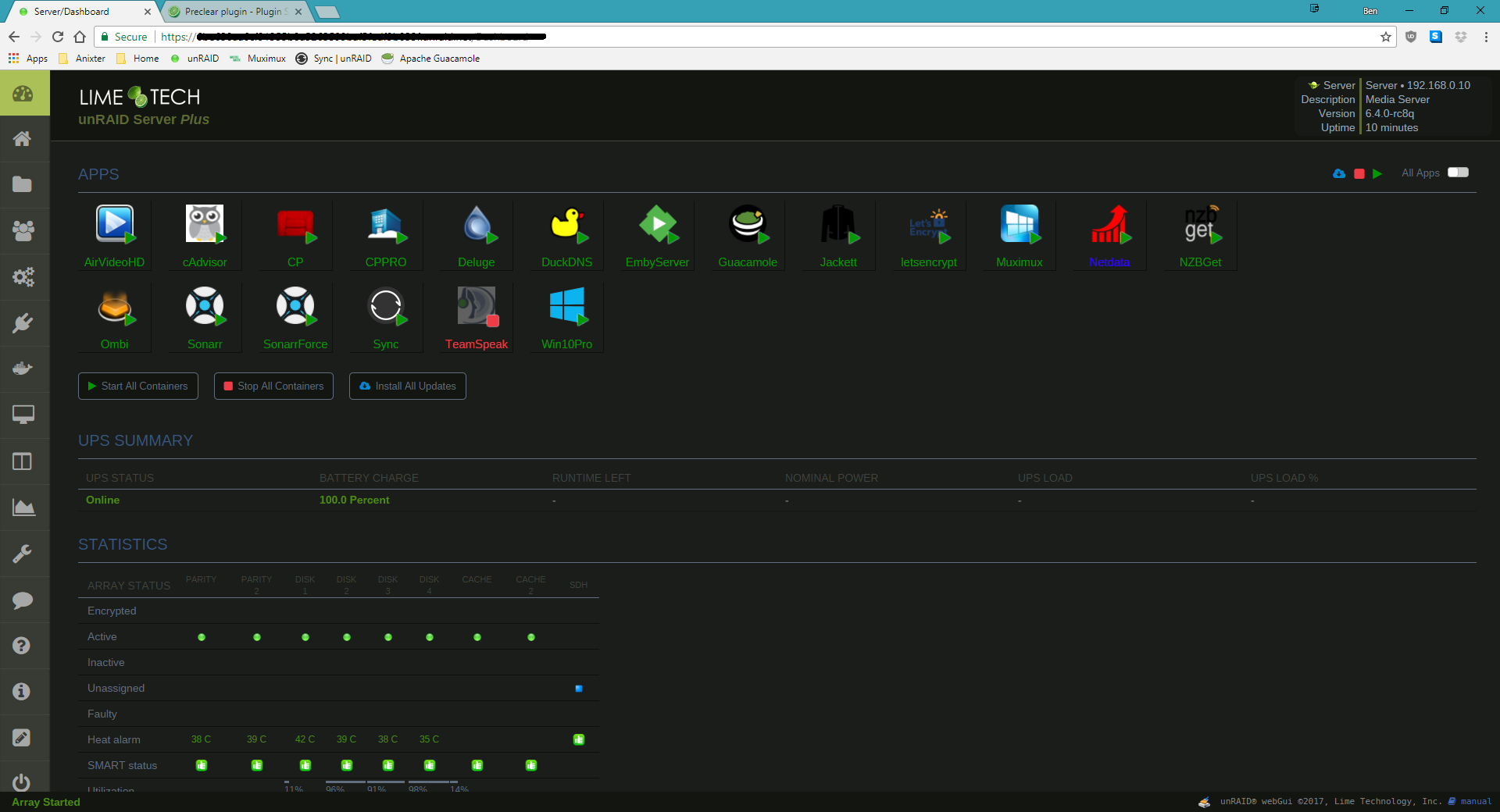

Not sure who needs look into this one, might be just a GUI issue or the plug in.... just added a new drive for a preclear to expand the array. The smart status icon for the unassigned drive is showing in the heat alarm row.
Thanks, this is a known issue and fixed in the next release.
