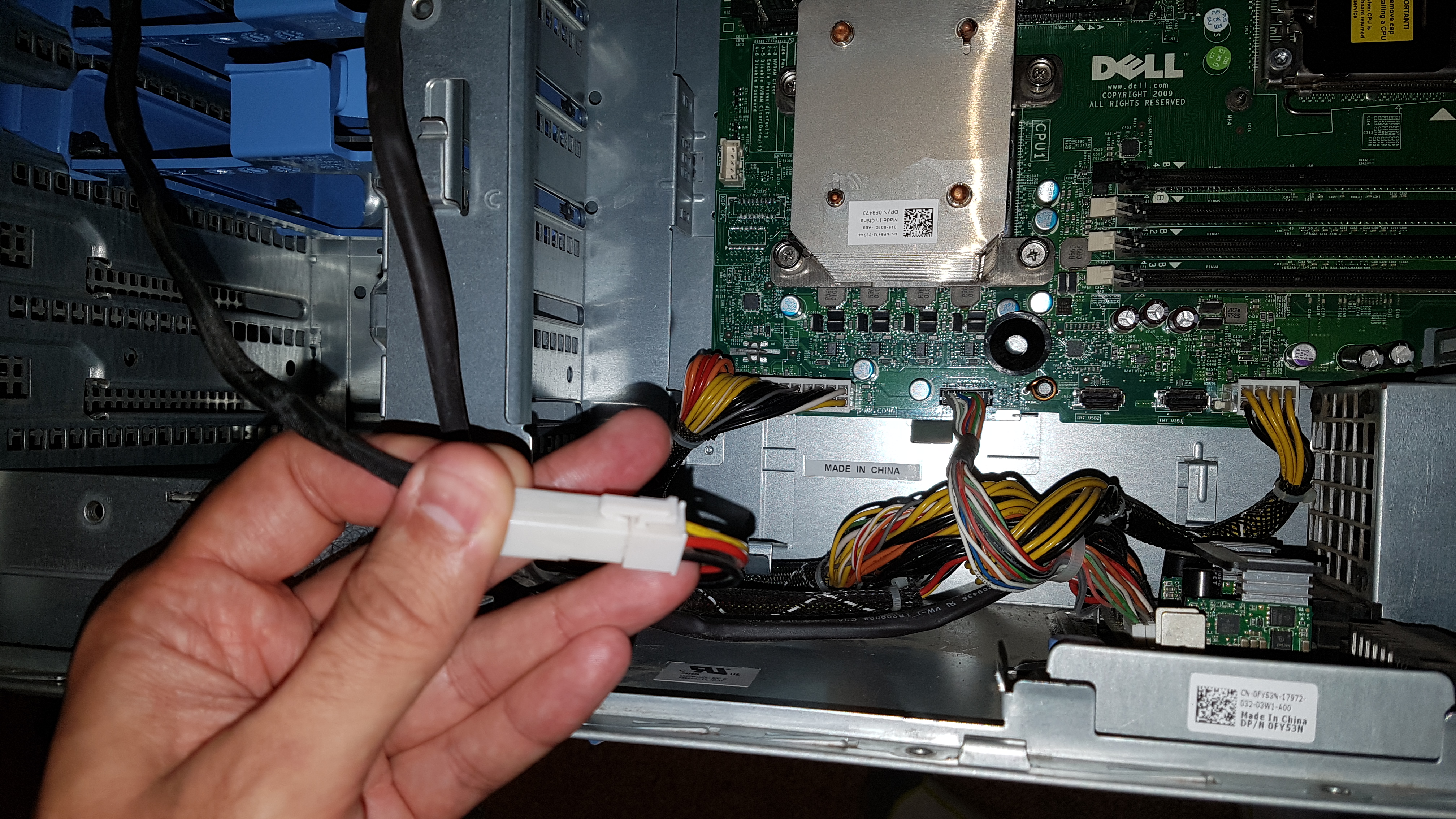

I've got no issue at least trying - but I can't seem to figure out how to power the drives - the existing power connectors plug into the data connection slot too?? Should there be some different power leads somewhere??

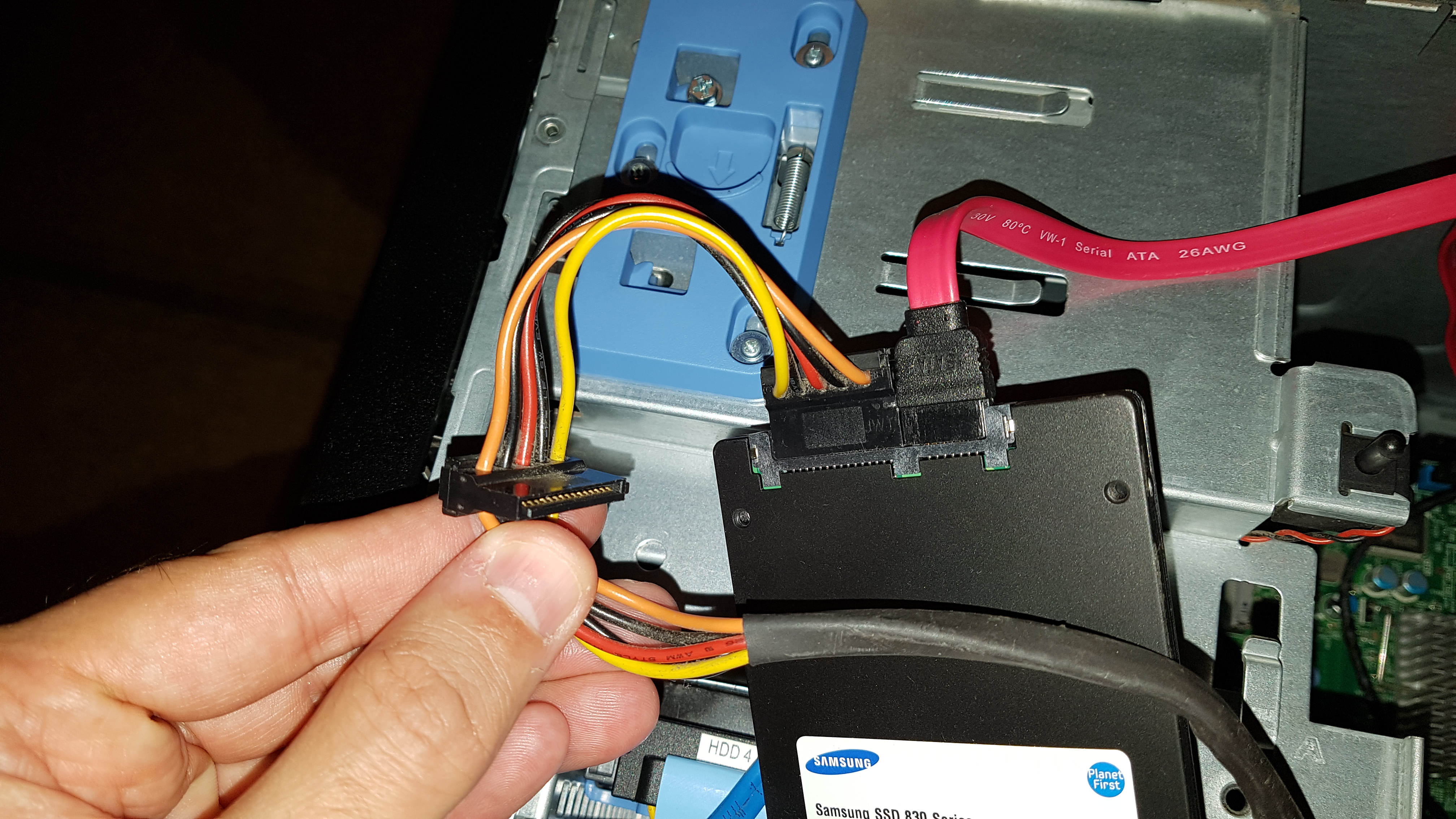

I've had a look and the power cabling and there is the following small square connection that (I assume?) can be unplugged and replaced with a regular hard drive power connector?
There are two "normal" power connectors, one of which I'm using for the SSD as follows!
Can anyone tell me what new cable I need that will fit into the above small square connection?
It's probably a custom cable, you can use a splitter or two on the existing SATA power connectors.

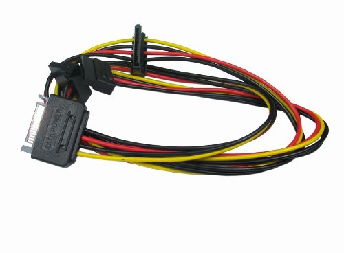

Thanks for the continued help - so if I bought a couple of these and plugged them into the two existing SATA power connectors, this would give me 6 power connectors and I can then just rig up the drives as I would usually would by plugging them into the SATA ports on the motherboard?
Is there any detriment to running that many devices off a single cable from the PSU?? (as opposed to finding some sort of cable that would use one or both of the "spare" 4-pin connectors?

SATA connector is the weak point, the cable can handle it, each can be split in 2 without issues, 3 is usually OK but it could push it.

The SATA splitters you bought should fit on the power side of the existing SAS connectors since they're backward compatible with SATA.
Oh wow - I can't believe I didn't think of that! So I basically leave the SAS power ribbon as it is but then plug a SATA power splitter into one of the existing plugs and in turn into the HDD's and use a regular SATA cable to the motherboard? (with the end connector that usually goes into the RAID card just left unconnected or would I still need the card plugged in?)
Correct.

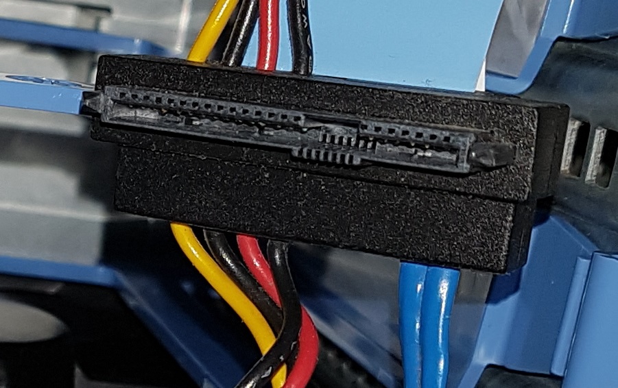

Here is a pic of the existing connections off the power ribbon:
And here is the male connector from the splitter:
I could be wrong but the "notches" either side of the 15-pint connections don't look as though they will fits in/around the moulded part on the SAS connection?? (or am I completely getting this wrong and have got hold of the wrong end of the stick all together??)
OK, I thought you were talking about the L notch on the SATA plug, one or both of those notches may need to be removed, but it's not a problem as long as the adapter stays firmly connected.

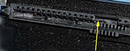

I'm asking because I don't know but wouldn't the notch on the Sata power cable fit into the notch I'm pointing to with the arrow on my graphic?
Sadly it doesn't - but on the up-side all I had to do is chop off the notch nearest the "L" shaped end and it slots in beautifully! :D

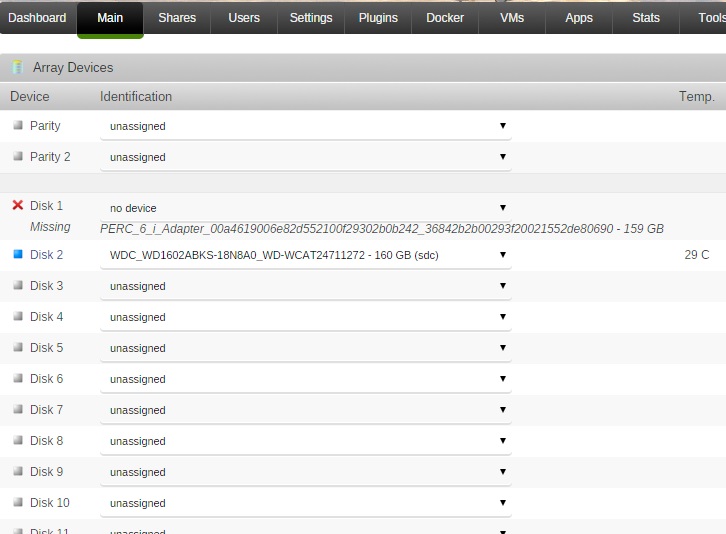

However, now I've taken the RAID card out completely and connected the HDD via the splitter and a regular SATA cable into "SATA B" on the motherboard - unRAID still seems to want to find the drive via the "PERC" adapter in the "Disk 1" slot!?!?! (as seen below!)
I can't seem to remove it - although it does find the drive fine and I can assign it to "Drive 2" no problem - I know this is just a niggle  but it's the sort of thing that will bug me - is there any way to remove the original configuration??
The PERC controller was identifying the disk differently, now is as it should be, you just need to do a new config:
Tools -> New config
