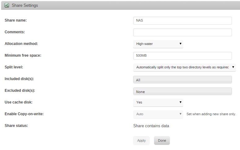

OK, I've got my parity disk up and running with no errors - but I'm wondering how data will be written to the array now I've got an additional disk in there?
I've got a "master" user-share set up as "NAS" rather than having individual shares (I'm pretty much the only one in the house that uses the server anyway!) so what happens now if I copy a movie to the array for example?
My share is set up like this:
Within Krusader I used to just have 1 disk showing but now there are (obviously 2) - I want to make sure all movies are kept in the same folder so they are picked up by Plex - will unRAID "create" a duplicate movies folder on the 2nd disk and treat it as a single folder??
Yes, when that happens depends on the allocation method and split level chosen, high-water is the default and the most used, you can turn on the help for an explanation of how allocation and split levels work.
Also, minimum free space should be set to twice the size of the largest file you expect to copy to that share.
Definitely turn on the help as Johnnie suggested.  High-water is the default and recommended.  It's going to put a lot of data on one disk, then move to another.  The OCD among us (myself included) may balk at that, but it's really easiest to use high-water and let unRAID do its thing.  Other strategies such as loading the disks equally or putting certain data on certain disks are hard to manage over time and can be less efficient for unRAID.

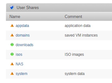

I've just noticed that some of my folders have a little orange triangle to the side rather than a green circle - when I hover over it tells me "Some or all files unprotected"!?!? Anyone know why this is? I thought once my parity drive was up and running my array was protected??
That means that some files from that share are on a single cache device, i.e., unprotected if that device fails, if the share is correctly configured running the mover will turn it green.

Here is a screenshot of the folders - it's not just my "NAS" folder!?!?
*update* I ran the mover and the "NAS" folder is now showing as green - but the other 3 are still unprotected??
Edited by stevep94
Those are cache only shares by default, so it's normal unless you have a cache pool.
