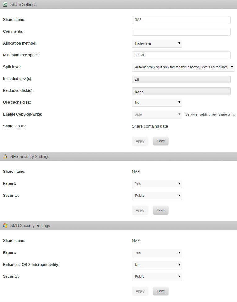

Right, I've installed my new 2TB drive (I didn't bother with Preclear because I couldn't get unRAID to recognise the make/model etc and the advice in the Prelear thread was a bit over my head!)
Anyway, drive in and formatted and so I've set up a user share as follows:
My understanding is that "high water" means the system will fill each disk to a similar level (once I put other drives in that is!) - however, how does this work if I put around 1.5TB of data on this drive before adding another - I presume once the 2nd drive has been added it will just fill up with data until it's as full as the first and then distribute alternately?
Wasn't sure about minimum free space so just put 500MB??
Split level stumped me a bit but am I right in saying that by selecting to "automatically split only the top 2 directory levels as required" means that my main share (that I've called "NAS") and then the subsequent sub-directory can be allocated to any drive and then all subsequent directories are kept together?
So NAS>Movies could be on either drive (again, once there is a 2nd drive in there) but then any sub-directories within "Movies" will be allocated together??
Finally I've not used the cache disk for the initial data transfer but I assume I can change it back to "Yes" once I've got everything set up as I want?

Each page in the webUI has help. There is a help button, it is a toggle, and if you turn it on you will get help for each page until you turn it off. User share settings are explained there in the help.

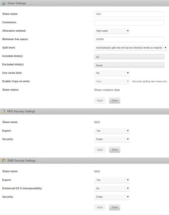

Anyway, before I do could someone give me a bit of a pointer on share security? (and thanks to @trurl for the tip on the help button but it doesn't really answer my query) - When I created my "NAS" user share I put both SMB and NFS as "Public" meaning that I could click on Network>UNRAID>NAS on my Windows PC and it just displayed the folder structure in Windows Explorer.
However, since then I've tried setting it to Secure (which my understanding is that it still doesn't require a login but restricts to read-only?) and then further to that I put it as "Private" - the thing is I'm not sure what details I need to input in the Windows Credentials part to gain access via a Windows 10 PC??
I've obviously got the server login itself set up as "root" and the password I chose at the time - however, this doesn't let me log in (in fact nothing seems to let me in via Windows anymore - even though I've since changed the security back to "Public"!?!?!)
Do these sorts of changes require reboots to the server before they are made active??
Thanks as always for any help!
You will need to set up users in UnRaid and then for each share you can set R/W permissions on a per user basis. I think there is issues with Windows saving credentials when accessing network shares but I generally just use the same username and password for both my UnRaid user and Windows Login, seems to work for me. I only use the root account for logging in to the GUI or SSH.

Also, I've got the main "NAS" folder set as "Public" which I thought meant that all users had read and write access - but when I've come to save a document to the drive via Windows Explorer, it's telling me that I don't have the appropriate permissions!
I can write to the root "NAS" directory but not to any of the sub-folders - is there a setting I've missed that allows you to do this??

Well it looks like I have managed to sort my ppermissions issue - I ran the "New Permissions" script and I can now write to sub folders within my main NAS folder!

Future reference:  Don't run the "New Permissions" tool if you also use docker applications and don't explicitly exclude your appdata share.  You have the potential to impact the ability of your apps to properly run.
Instead if you ever have a need to run New Permissions (with properly configured apps though you should never really have to run it), install the Fix Common Problems plugin and then run Docker Safe New Permissions instead.

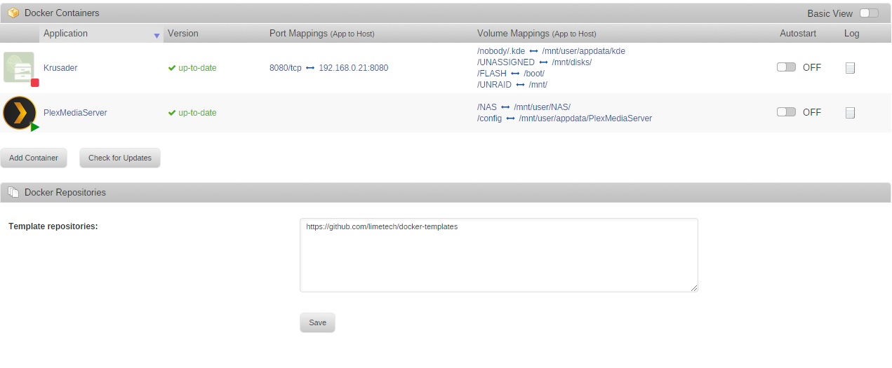

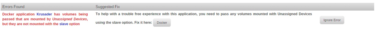

Now before I do I thought I'd run the "Fix Common Problems" plugin and it's found an issue with a mounted volume not using a "slave option" as follows:
If I click on the "Fix it here: Docker" button I get the following but I'm not sure where to go from here?
The volume mappings are all simply as per one of the tutorial's I watched on Youtube - but I can honestly say I don't understand them!?!?
Is this a crucial error that needs fixing? I'm also thinking that it relates in some way to the Synology NAS that I've got mounted - which when I pull the drives is actually not going to be needed - so does it need fixing if this is the case??
