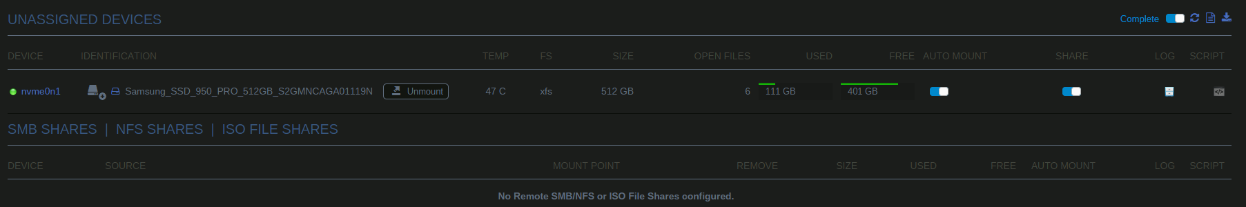

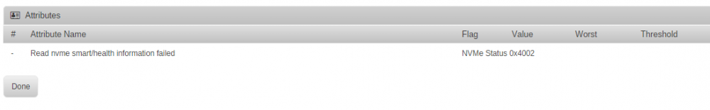

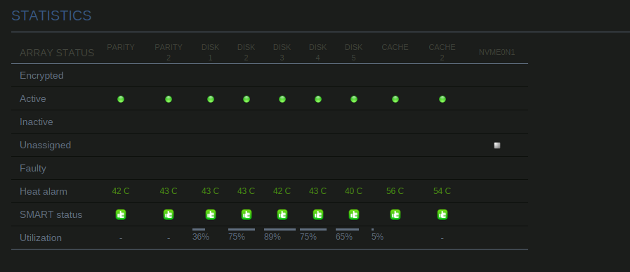

    • Finally fixed reporting of temperature for NVMe devices (hopefully).

    Are you sure? On the GUI for SMART attributes it shows "NVMe Status 0x4002", that's the output when you use nvme0n1 instead of nvme0:
    59f43ad4ca8c6_Screenshot2017-10-2809_06_38.thumb.png.e93bbe090e919a7afb44af85e2da97b6.png
    smartctl -A /dev/nvme0n1
    smartctl 6.5 2016-05-07 r4318 [x86_64-linux-4.13.10-unRAID] (local build)
    Copyright (C) 2002-16, Bruce Allen, Christian Franke, www.smartmontools.org
    === START OF SMART DATA SECTION ===
    Read NVMe SMART/Health Information failed: NVMe Status 0x4002
    Right, that's a bug in attributes reading. Need to correct that.
    Thanks :)

    NVME as an unassigned still wont show correctly. The plugin however works fine.
    Edited by Lebowski
    This is expected, the Dashboard status doesn't include temperature reading for unassigned devices.
    I'll make an update to include this.
    it's also showing as offline?
    It is shown as offline because its status reading is "unknown".
