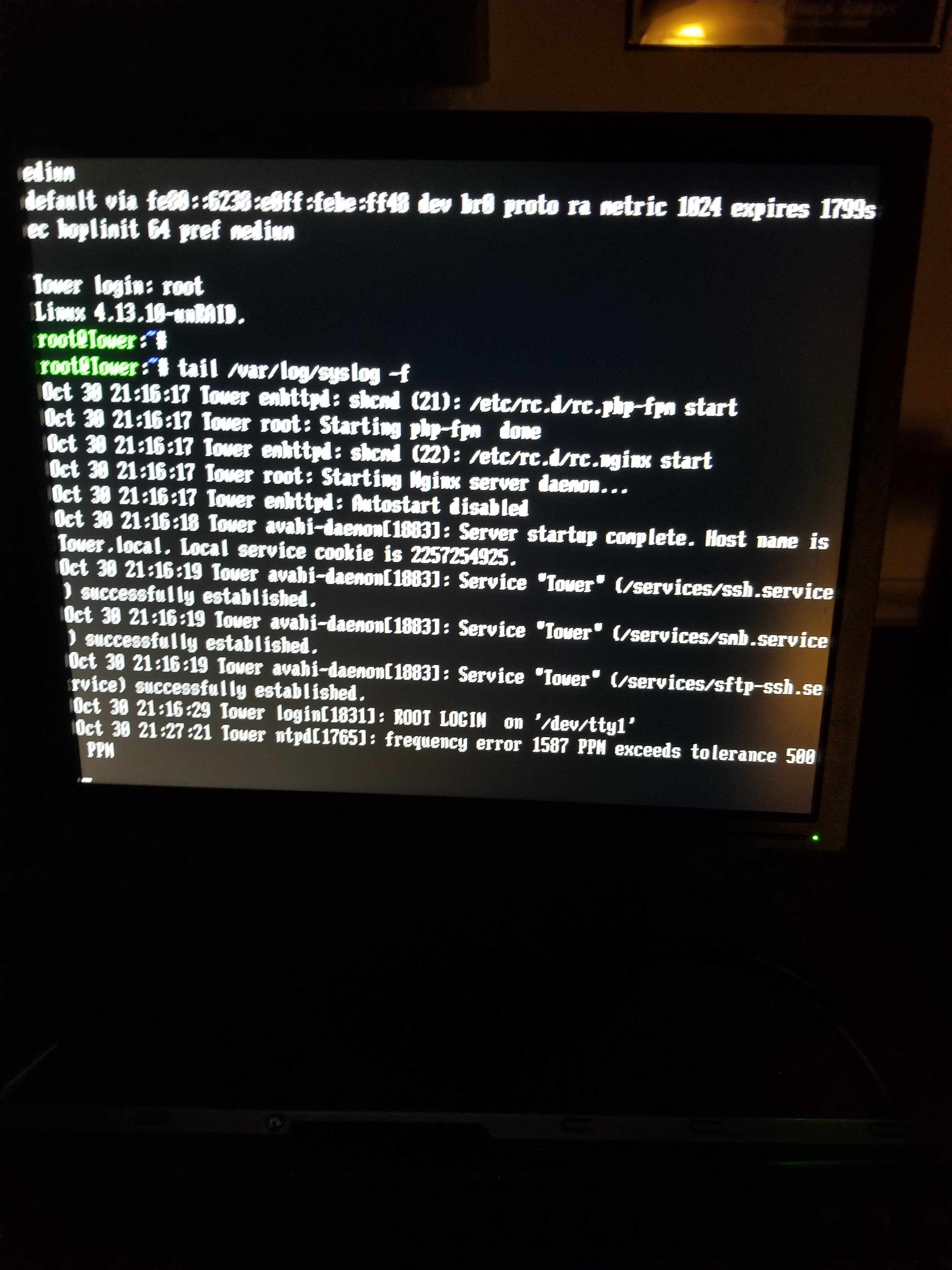

I just started with unRAID and for some reason my system won't stay up for more than an hour. This is what posts to the screen:
And this is what posts in safe mode:
This is on a Ryzen 1600X with nothing attached but the ram and an AMD RX 550 graphics card.
tower-diagnostics-20171030-1937.zip

Check that you are up to date on bios and have C-states turned off to begin with. 6.4 has a fix for them but baby step yourself to stable. I’ll let smarter people than I troubleshoot to diags.

I have a 1600x on a Gigabyte gaming 5 with the latest bios(F9a) and i had 2 crashes. One was from overclocking for some reason. It would crash maybe a hour later, guess unRAID doesn't like the OC. The other was while running the docker backup plugin which also happened when i was using my 7700k as well, so a random thing but would happen every now and then. I've been stable besides that for the last couple days.
Is that OC beyond the boost frequency or just the built-in boost? I'll disable both because there does seem to be an issue with the clock.
I'll also disable C-states just for good measure.
