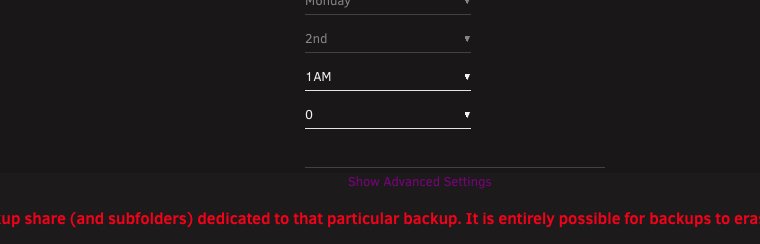

Feature Request:
The "Show Advanced Settings" link is very hard to see on the dark theme.
Perhaps you could change the color?

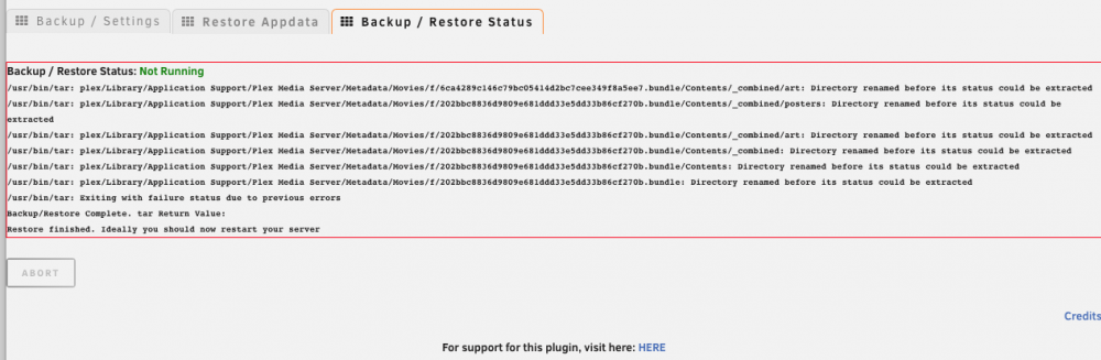

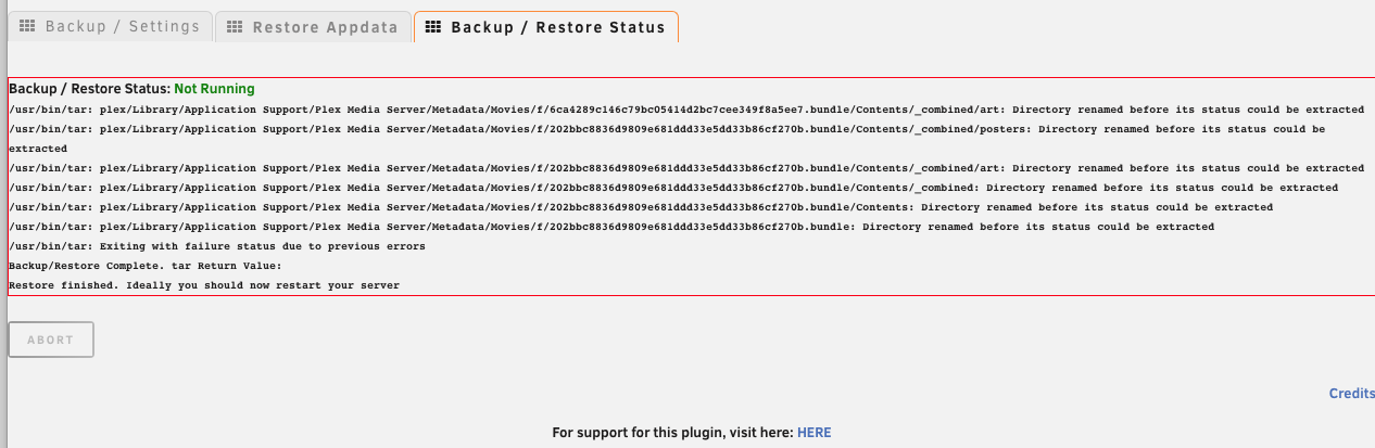

I have having the worst luck, and in need of help... please.
I have followed another guide to remove bad drives that are having failures (new one sitting here ready to be put in), and had to run the new config for the drives. then, then forgetting to screenshot the cache drives, i winged it. I then ran the parity check. The next day, I found that all my dockers images are missing BUT thankfully I have been running the backup every week, as much as a couple days ago...
However, the issue now is that when I restore it, it fails and states: "Directory renamed before its status could be extracted" (see screenshot) Not sure what i did wrong.
I've added a diagnostics to help my my headaches.
Where did you find this "guide"? Sounds like it led you down the wrong path. New Config isn't typically part of drive replacement, assuming they actually needed replacing. Possibly it was simply a case of the much more common bad connection. And even if you do New Config, it shouldn't forget your disk assignments unless you tell it to.
Please consider asking for advice before trying to fix these sorts of problems in the future. Are you sure you didn't actually lose data winging it like this?
Also, your system share has files on the array, and your docker image is twice as large as recommended.
Thanks
Yeah, I don't know.  I first thought that mover might have done something at the time, but it looks like the restore finished 2 minutes before mover was set to kick in.
Thank you for replying, i feel pretty stupid right about now.
I looked at the mover schedule just now and changed it to daily, it was hourly, just to see if it helps.
I ran the restore again, and it failed again. Can this be done manually through the terminal?
Thanks again for the help
