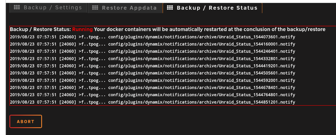

I just noticed the other day that my backups stopped working with the process having been hung for two months.  I rebooted Unraid, manually initiated a backup, and it still hung on backing up notifications.  I'll try removing the boot drive from the backup and try again, but it really needs some way to notify users if the process is ongoing for far too long (e.g. two months ;p )
Here's where it gets stuck, with the 'Abort' button doing nothing:

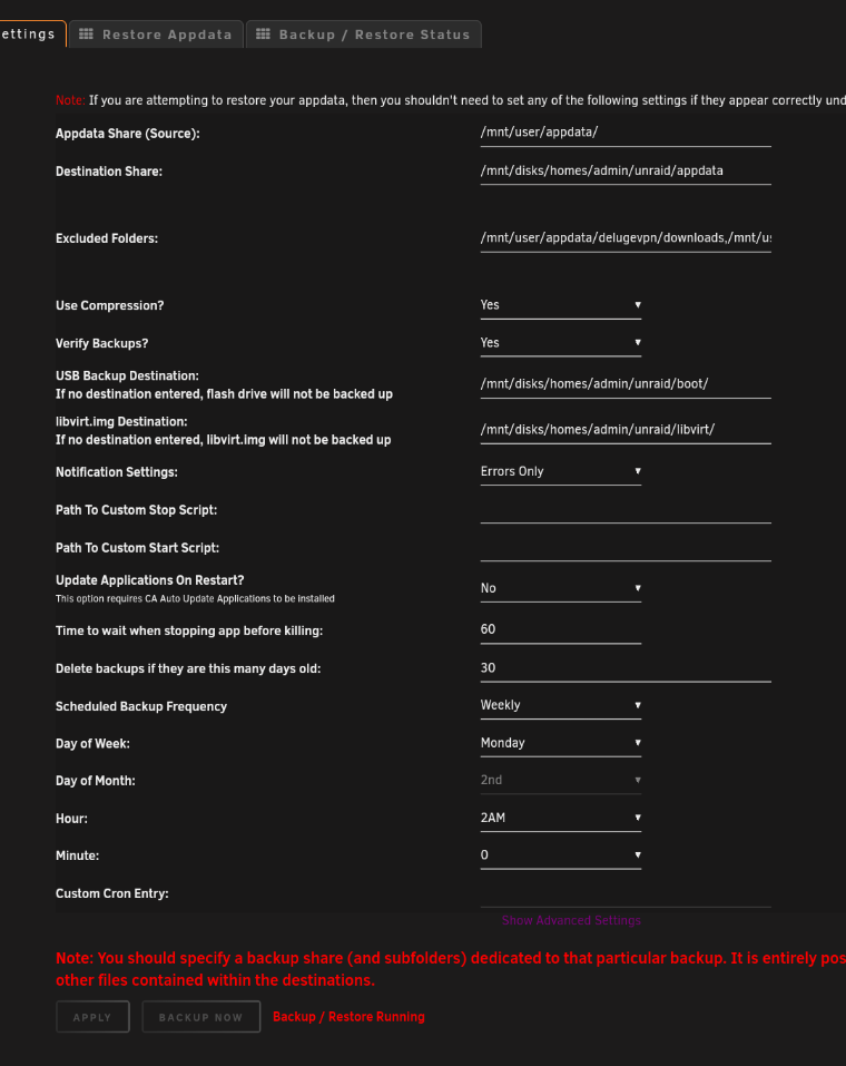

Here are my settings:

Post the diagnostics
