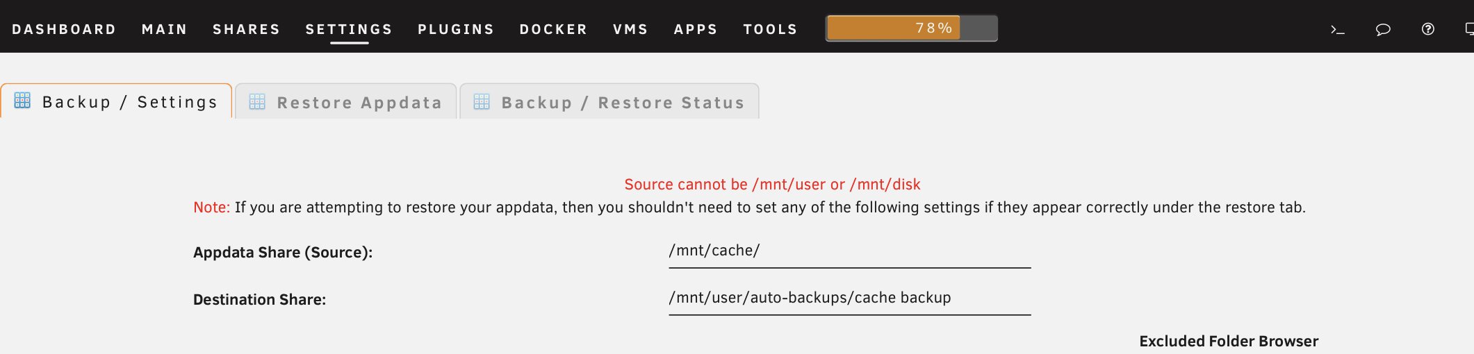

Is anyone using this plugin to backup random non-appdata folders on their cache? Seems like it could be as easy as changing the source to mnt/cache and then using the "Excluded Folders" to deselect those I don't want to backup? Basically trying to backup the appdata folder and a few others that are only on the cache.
Everywhere in the plugin it refers specifically to the appdata folder so I wanted to make sure there isn’t anything specific to just that use case before trying to set this up.
Nothing says that you can't do that

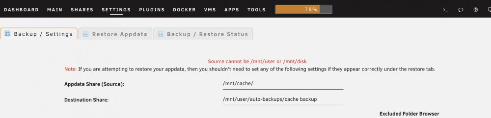

Hi Squid, I’m trying to set this up but I’m getting the error msg below. Am I doing something wrong or is it not possible to backup all folders on my cache drive minus a few excluded ones?
Ok.  Looks like I lied.  Must've had a reason that I set the plug-in like that, but can't think of why right now. 🤔
2 hours ago, bonienl said:
Don't you need "appdata" in the source path?
He was trying to adapt it to backup the whole cache
Maybe to prevent overwriting the source
I *think* I have that test in there due to what happens on a restore.  A fail-safe because when restoring, any excess files from the source are deleted.  (and also to prevent a source and destination overlap)

I made a manual backup to app data and flash drive to a external HDD, i set use compression to YES, but when i looked on my HDD the Flash drive is not compress, is compression not working if i use a external HDD ?
