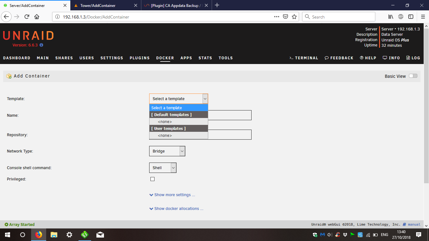

Hi could I get some help with restoring a backup on another machine.
I restored the appdata back up which was around 26gb rebooted server, but when I go to docker all the templates are empty. The appdata was not originally on cache drive but now are so do I need manually change something for docker to know where to look for the appdata?
/mnt/user/appdata/ (CACHE ONLY)
1815134174_Screenshot2018-10-2713_40_17.thumb.png.71e3e07e2f88cfc185069b6a7489a179.png
Edited by bally12345
The templates are on the flash drive. How did you lose them?
Ahh ok, created a new flash drive and only copied over plugins folder. Migrating 2 old machines to 1 new one and only copy over the plugins folder from 1 machine, will copy the other machines folder to the flash drive and see if that solves it
If you want to keep your configuration when you create a new flash, you should copy the whole /config folder from the old flash. It has your disk assignments, share settings, docker templates, plugins, ...
And be sure to backup your flash when you make any changes to your configuration, especially when you do anything to change disk assignments. You can always download a zipped copy of flash from Main - Boot Device - Flash - Flash Backup.
The Issue I had, I had 1 machine with my disk shares and all the data, 2nd machine purely to run docker so there would be 2 configs and 2 sets of plugin folders etc
Everything is working just need to copy of the templates. Would I need to copy the plugins and docker.cfg?
That worked, copied over using MC and templates now showing, will need to manually update all the mappings and fingers crossed everythings works.

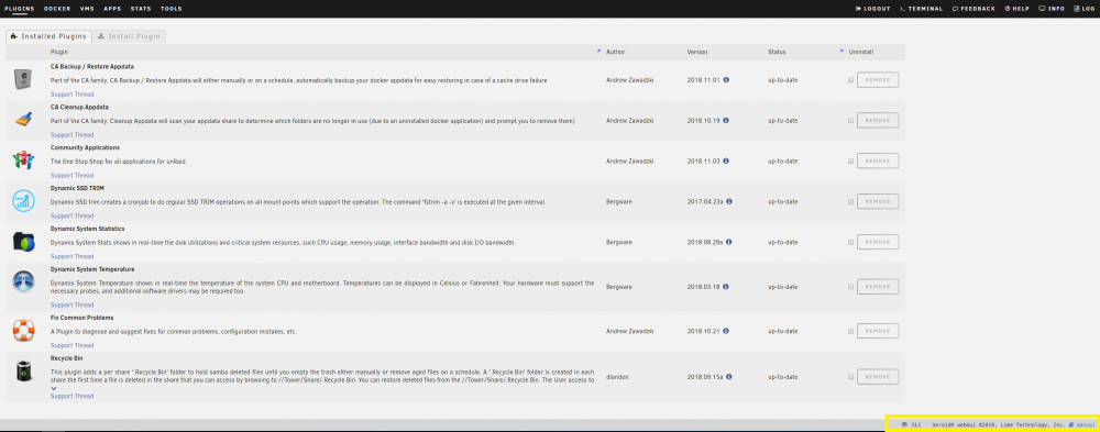

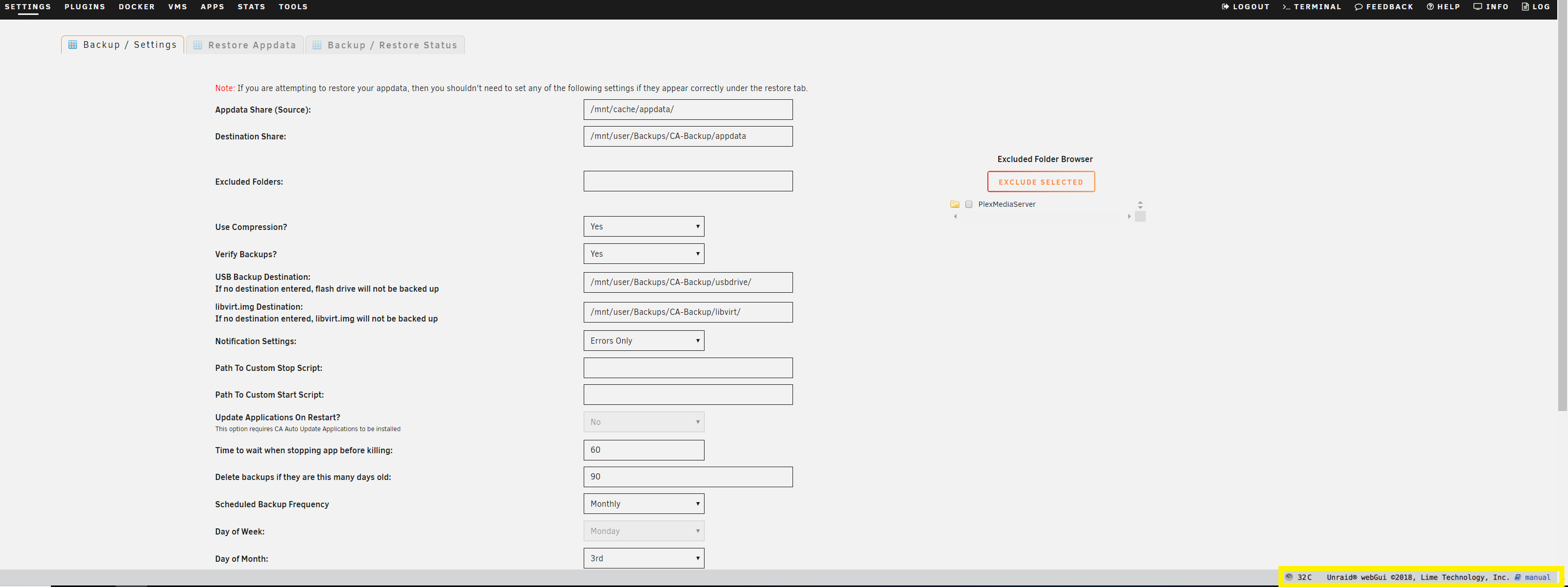

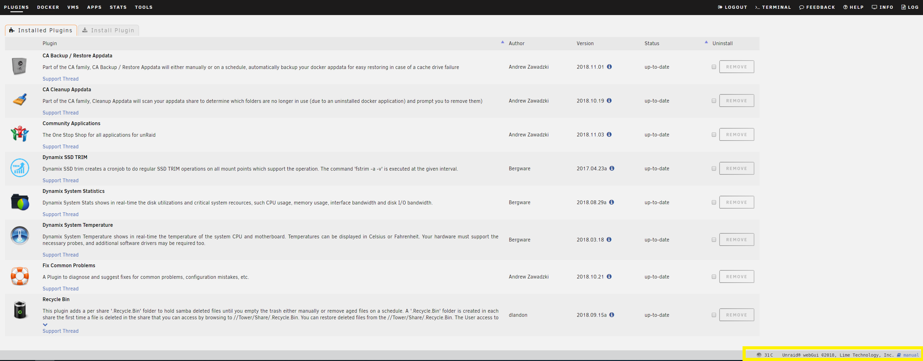

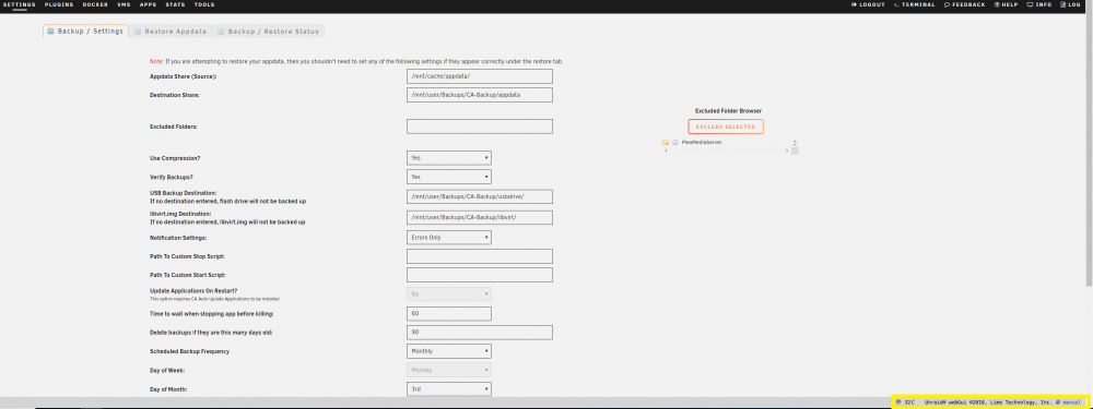

Noticed that this plugin's text/font is set differently than anywhere else in the unraid webui:
Regular Menu:
Backup Menu (Settings):
Edited by cybrnook
3 minutes ago, cybrnook said:
Noticed that this plugin's text/font is set differently than anywhere else in the unraiod webui:
lol  k.  Low priority for me ( it took me ~2 hours prior to the release of 6.6 to find where CA caused the same thing on the footer - wasn't the most enjoyable experience of my life ;) )
Just doing my part and reporting the issues is all...
