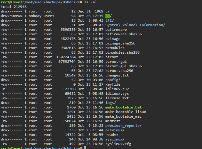

I have this docker run nightly. I'm only have issues with the "USBBackup" section. It backs up. However I dont have permissions to do anything with the files that are backed up. I try to copy files to another machine. Then back up online.
I am getting access denied error.

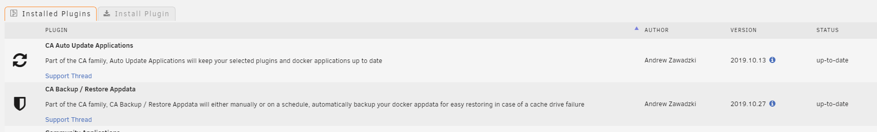

2 minutes ago, Squid said:
Has the backup run since you updated the plugin
Sent from my NSA monitored device
My appdata ran as of this morning. Its set to daily.  The appdata i can access fully. Move/delete/copy etc
But when did the update get installed.   The screen shot suggests that when that backup was made it was still on the older version.
Run one manually and see if it's any different (or wait until tomorrow)
It appears that was the gold. I never ran after upgrade. But that i did it works perfect. Thank you.
