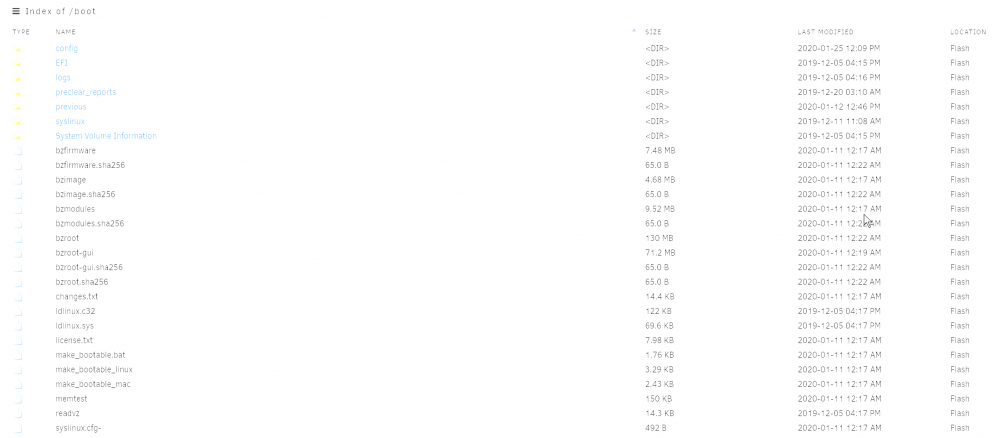

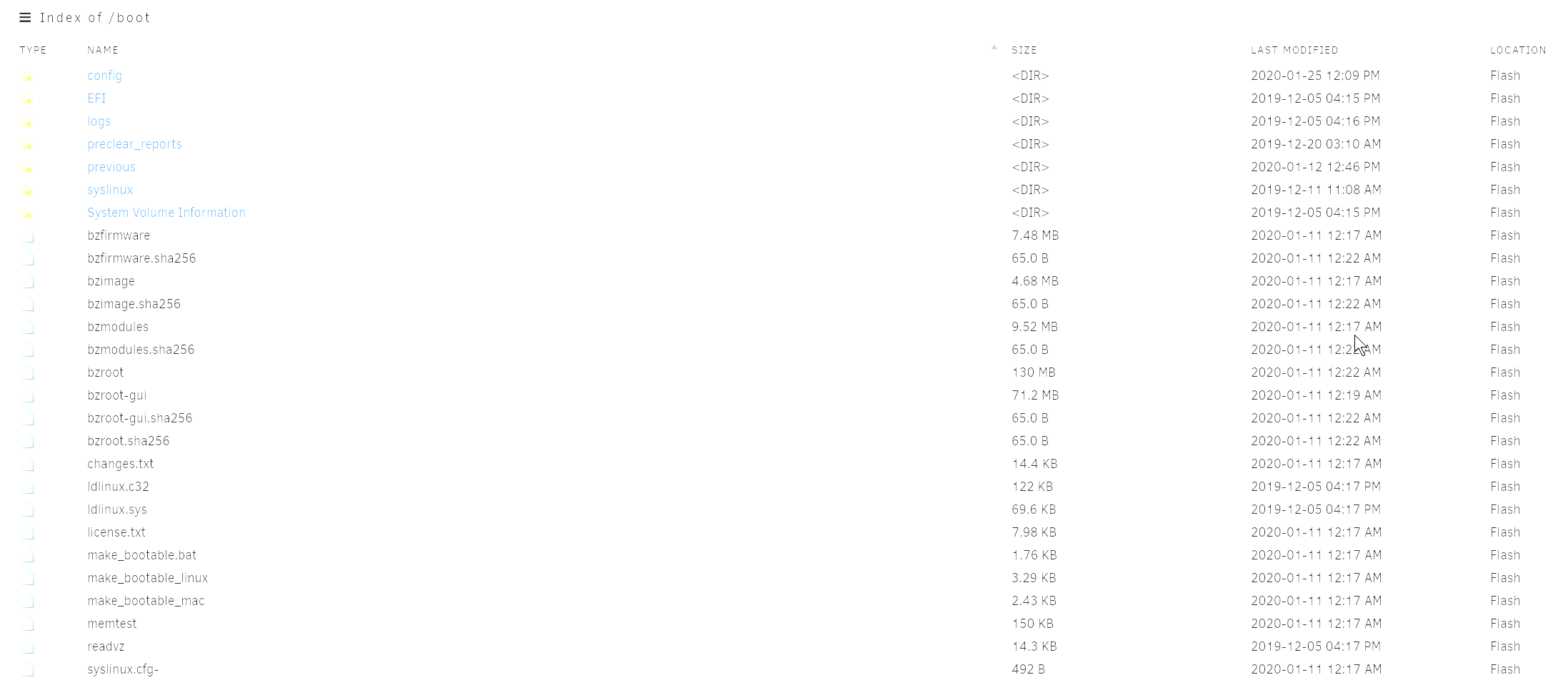

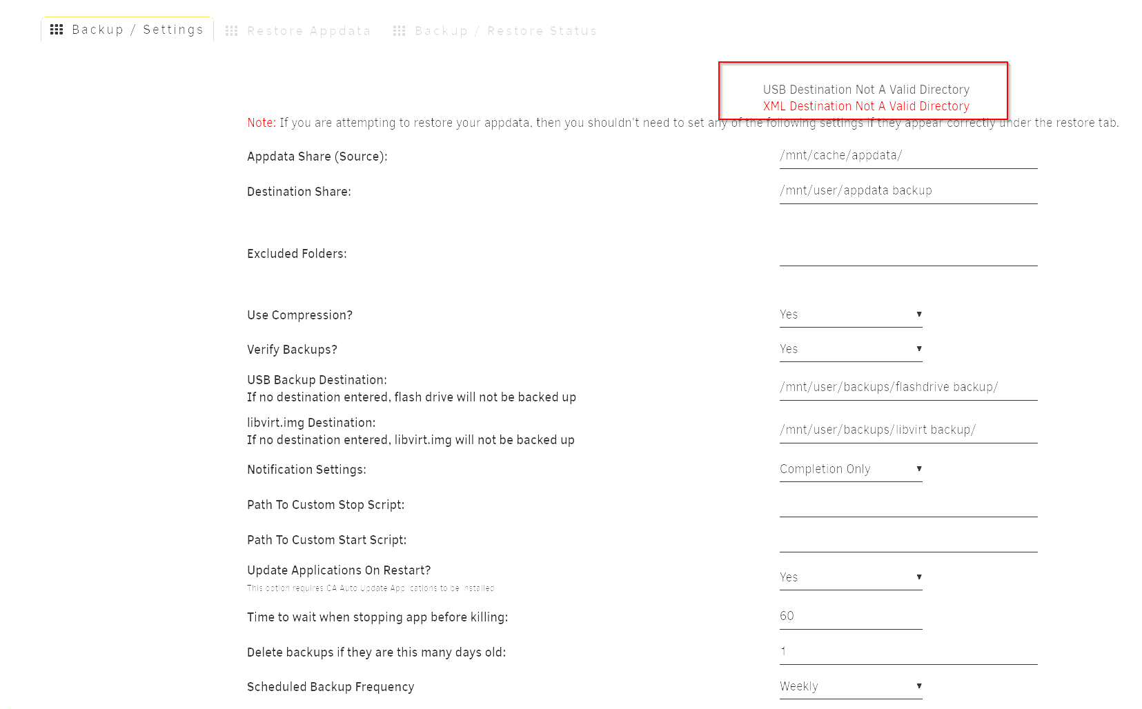

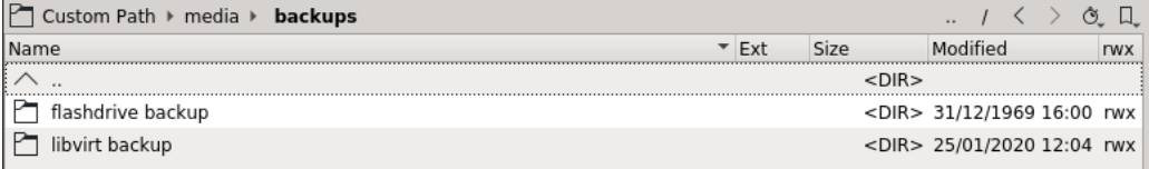

Another question.  Why is the backup date 1969?  In case your wonder if it's getting the date from the folders or the files on the root, the next picture shows nothing states 1969.  Any ideas?
Probably because your date/time is out to lunch on the server.  Set it properly in the BIOS, and also replace the battery.
That would make sense because when I created the unraid server, that motherboard has issues with the battery/RTC.  Does that mean that NTP is not up and running when the server starts writing to the unraid thumb drive and hence the date/time is being pulled from the RTC?
More likely tnat you dont have ntp enabled in settings
