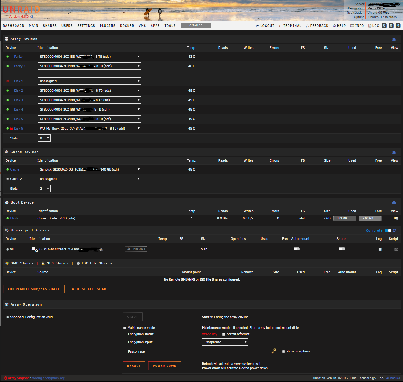

The problem came today when I had to shut down the array. Like an idjit, of course, I forgot the passphrase.
I have tried, methodically, over 170 passphrases in iterations I would/should have used. I will try some more tomorrow before calling it moot, but, wanted to ask the best way to minimize the loss if it doesn't work.
There is only about 3-4tb data on the encrypted drive... and I think I can replace most of it easily.
What is the best way to bring this back online, encryption off/lost, with the 4x8TB of existing, un-encrypted data, then add the two "new" drives, then the dual parity.
I am assuming a 'new config', no parity drives, no encrypted drives, just the 4x8tb as a fresh array (with data), then add the two as encrypted, stop, and add the 2 parity, and let it calculate parity all at once. (Preserve cache+data slots? or near-blank slate new?)
I am aware I will lose the data on the encrypted drive, and, the emulated (empty) drive should lose nothing. I just do not want to lose the other 4x8tb (about 28tb data). I am fairly sure this can be done. And, yes, I will be using a keyfile with a backup after this. My memory is simply not sharp enough anymore. The purpose of the encryption is simply warranty snooping protection, so, I do not need to keep my tinfoil on that tight in this case. I will assume, also, that the parity drives are holding the encrypted raw bits/sums so, the parity atm would be of 0 help.

No need for a new config, just click on that disk, change the filesystem to a non encrypted one, start the array and format the disk, if you want to use encryption again just change back to an encrypted filesystem and format again.
