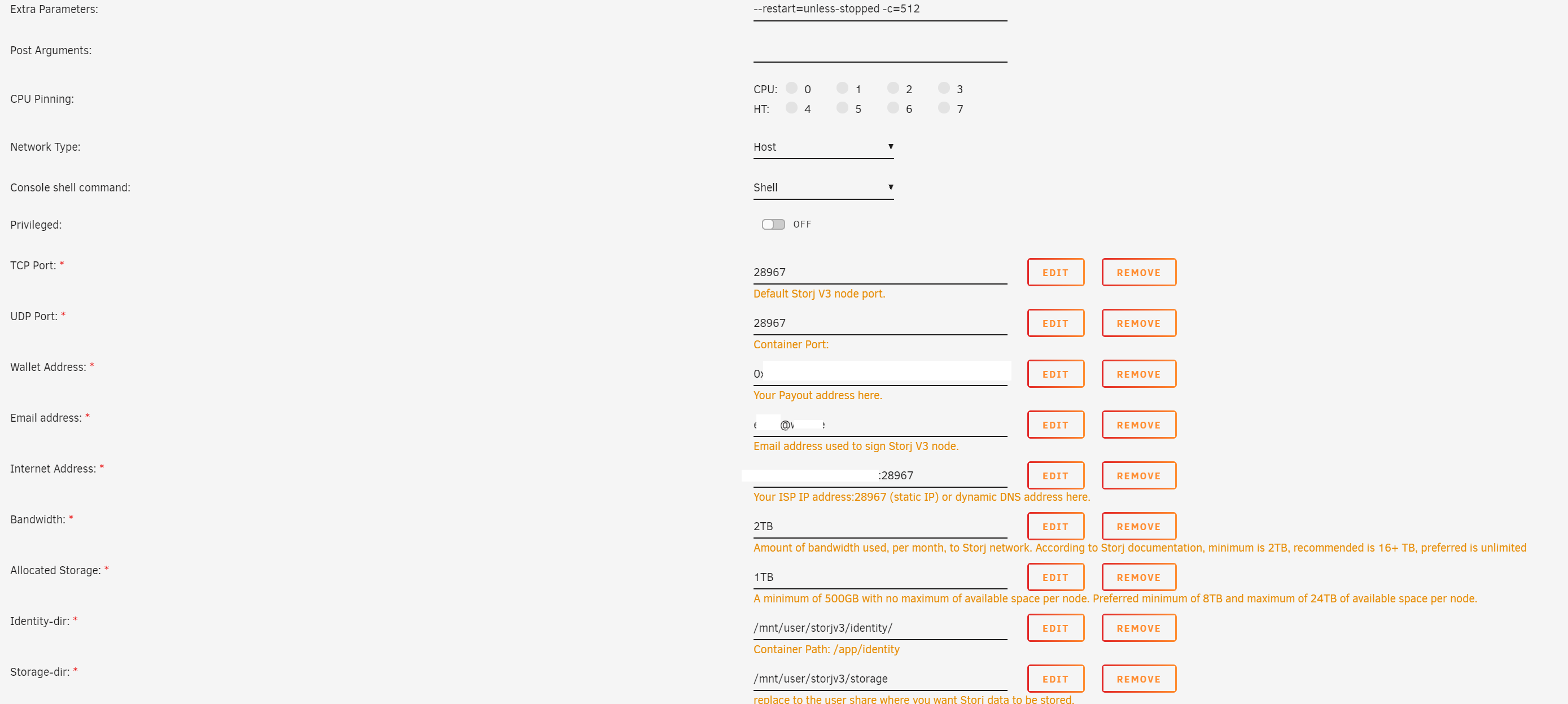

A few problems
1.) you say enter your email, really only email? Ive got a token email:something ?! Should i enter this token, or really just email?
2.) Ive set up my identiy (/mnt/user/storj/storjv3/identity) and when i start i just get
 file or directory not found error: open identity/identity.cert: no such file or directory
edit: ahh, i have to manually do that... you should point that out.. xD
My brain cant work out how they did it that complicated, wtf, srsly? Maybe we need to launch a rocket first...?!
What is wrong with them? I mean, srsly its 2019 and i need a command promt in windows to create and .. omg
Edited by nuhll
What a piece of crap they build xD
2019-07-01T05:40:44.015Z [34mINFO[0m piecestore:monitor Remaining Bandwidth {"bytes": 2000000000000}
2019-07-01T05:40:44.015Z [33mWARN[0m piecestore:monitor Disk space is less than requested. Allocating space {"bytes": 282630311936}
2019-07-01T05:40:44.015Z [31mERROR[0m piecestore:monitor Total disk space less than required minimum {"bytes": 500000000000}
2019-07-01T05:40:44.014Z [34mINFO[0m vouchers Checking vouchers
282630311936 bytes????

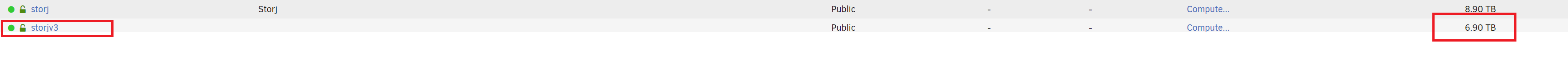

I even created a new share, just for this docker, and its not working. I tried giving it 1TB, 500GB, 2TB, 4TB. Dont work.
Also i get
"error": "voucher: unable to find satellite on the network: node not found",
but i think, thats because my node isnt starting because i dont meet the disk space.
On the share i have atleast 6TB free.
Does it work for you? Also its taking 9GB of RAM while DOIN NOTHING? XDDD
Thats the share.
Thanks for your help!
I think the problem is, that the container only sees <300gb of space, but i dont know why? I did my settings like in every other container on this world :D
Edited by nuhll
On 6/27/2019 at 8:08 AM, Jcloud said:
Please be sure to read Storj setup instructions at: https://github.com/storj/storj/wiki/Storage-Node-Setup-Instructions
Their video:
That is used in Step-3.
The Unraid Docker template runs this (from the setup link):
$ docker run -d --restart unless-stopped -p 28967:28967 \
    -e WALLET="0xXXXXXXXXXXXXXXXXXXXXXXXXXXXXXXXXXXXXXXXX" \
    -e EMAIL="[email protected]" \
    -e ADDRESS="domain.ddns.net:28967" \
    -e BANDWIDTH="20TB" \
    -e STORAGE="2TB" \
    --mount type=bind,source="<identity-dir>",destination=/app/identity \
    --mount type=bind,source="<storage-dir>",destination=/app/config \
    --name storagenode storjlabs/storagenode:alpha
The data on Storj is encrypted, the manual step is basically generating an encryption key and the token is signing it, similar to an SSL certificate is my guess.
What's wrong with a command prompt?  It's much easier to program; arguably just as efficient to execute as GUI; much lighter-weight on system resources.
From log file or console? I think that's due to being a new node on the network, if that's coming from the log file - give it some time to be on the network.
Did you run a command from console or was this in the log file?
All ive posted is from the log file.
Ive df -h ed into the container and its onyl 260gb free or something, how can that happen?
root@Unraid-Server:~#  docker exec -it StorjNode-V3 df -h
Filesystem                Size      Used Available Use% Mounted on
/dev/loop2               50.0G     20.4G     27.3G  43% /
tmpfs                    64.0M         0     64.0M   0% /dev
tmpfs                    15.7G         0     15.7G   0% /sys/fs/cgroup
shfs                    465.8G    200.5G    263.2G  43% /app/config
shfs                    465.8G    200.5G    263.2G  43% /app/identity
/dev/loop2               50.0G     20.4G     27.3G  43% /etc/resolv.conf
/dev/loop2               50.0G     20.4G     27.3G  43% /etc/hostname
/dev/loop2               50.0G     20.4G     27.3G  43% /etc/hosts
shm                      64.0M         0     64.0M   0% /dev/shm
/dev/loop2               50.0G     20.4G     27.3G  43% /root/.local/share/storj/storagenode
tmpfs                    15.7G         0     15.7G   0% /proc/acpi
tmpfs                    64.0M         0     64.0M   0% /proc/kcore
tmpfs                    64.0M         0     64.0M   0% /proc/keys
tmpfs                    64.0M         0     64.0M   0% /proc/timer_list
tmpfs                    15.7G         0     15.7G   0% /sys/firmware
I dont understand why /app/ is only so small, it should be the same size as the share??!
And about the cmd is fine. Its 2019. I know what happens behind the curtain, but the normal user just dont fuggin care :D tehy can make that easier, if they want.
Edited by nuhll
and its onyl 280gb free or something, how can that happen?
You mentioned making a new user share for this, is it using/on the cache-pool? That's my guess.
TRUE
how can that interfere, crazy.
Its working now, besides:
2019-07-01T06:28:30.218Z [31mERROR[0m vouchers Error requesting voucher {"satellite": "ID", "error": "voucher: unable to find satellite on the network: node not found", "errorVerbose": "voucher: unable to find satellite on the network: node not found\n\tstorj.io/storj/storagenode/vouchers.(*Service).request:127\n\tstorj.io/storj/storagenode/vouchers.(*Service).Request:116\n\tstorj.io/storj/storagenode/vouchers.(*Service).RunOnce.func1:103\n\tgolang.org/x/sync/errgroup.(*Group).Go.func1:57"}
Edited by nuhll
