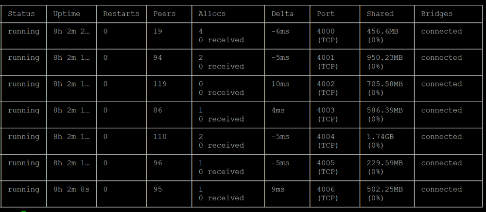

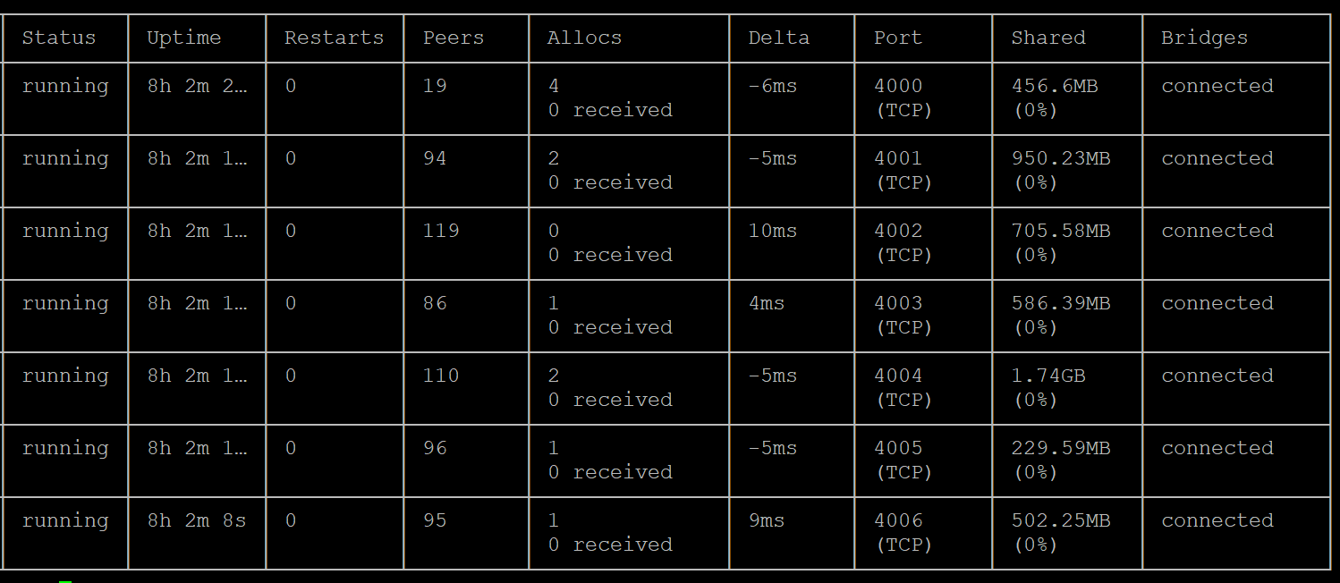

Till now:
(storj) 1 fresh new install with ur new docker - some reputation gained, but no files stored so far, so it makes sense that storjmonitor is not working
(storj1) 1 fresh install and then (stop) and copy old files over - i guess here it should report files stored, but didnt do
9 other nodes with just "old files with new docker"
none of them show any data till now, (for storj1-10)  im also concerned if they work correct, because i get many timeouts in log... also no increase in reputation.. but timeout goes down...?!

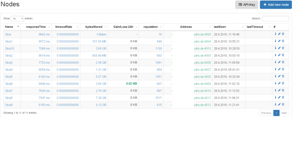

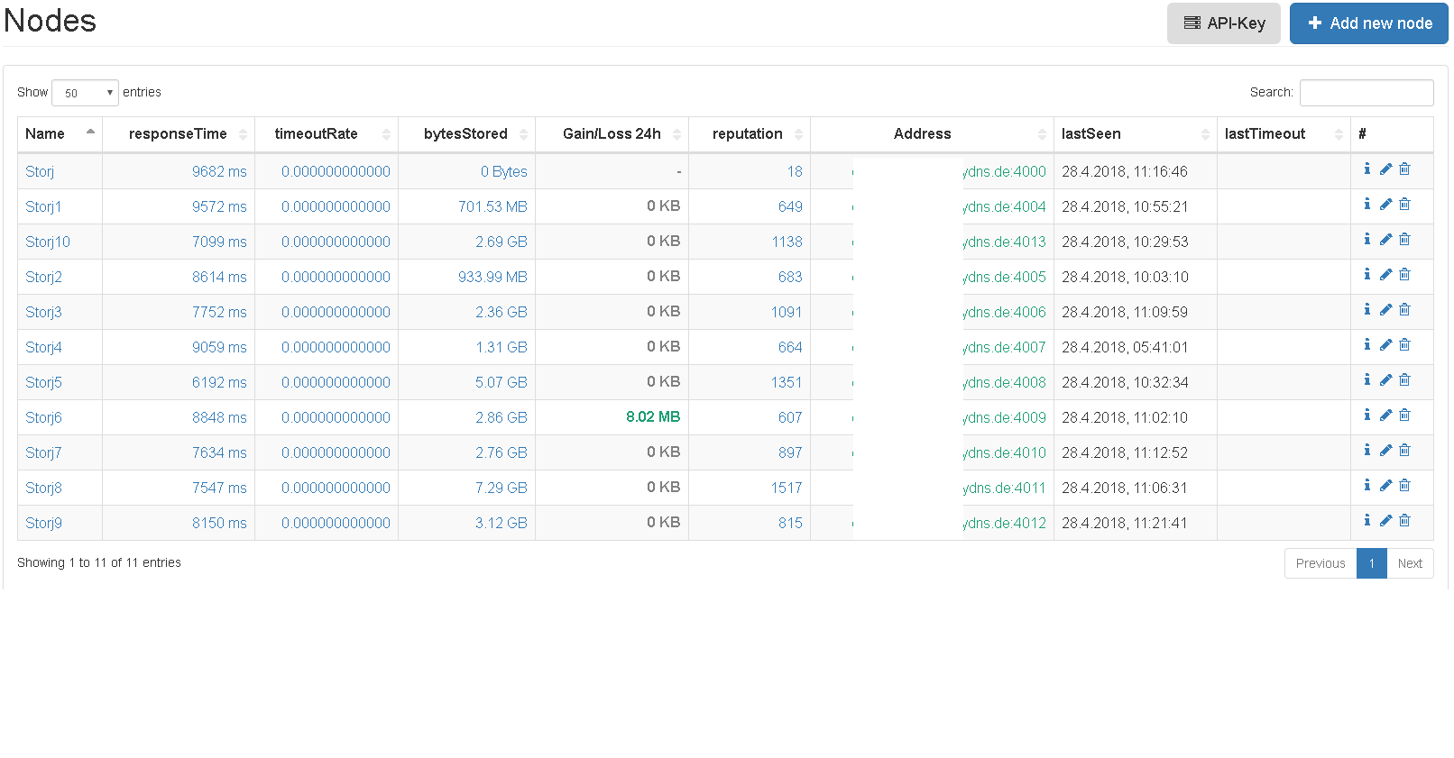

okay some nodes seem to work and report their size correctly, i just edited the storjmonitor.js and replaced the key with mine. Ill try to find out if all work or what i have done other then on others (like if its needed to +x it)
Edit2:
GOOD NEWS!
It seems to10 from 11 nodes are working, it doesnt matter if u +x it. U just need to replace the key in the conf.
If you want to keep the variables, then you need to make sure that ur original storjhmonitor.js has actually YOUR_KEY_HERE in it. So the replacement works.
Edit3:
Seems like all 11 nodes are running fine now. Its just confusing because you get invalid farmer data and or error (and it works 15 min later on his own) (i guess there are a max 1 connection per 15 min setting on their server or something)

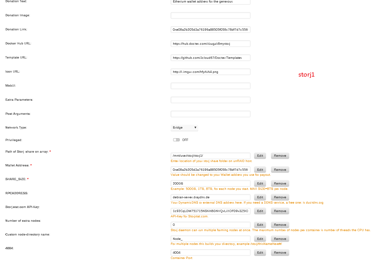

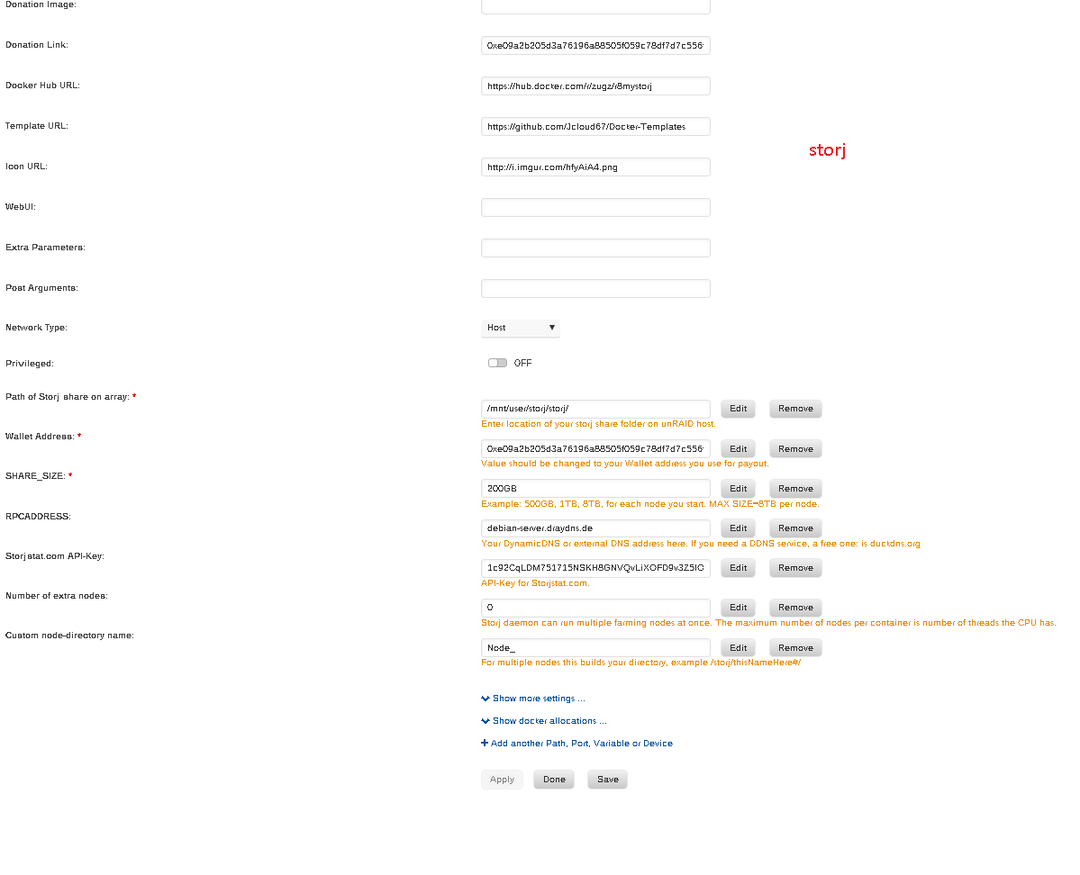

The webui template for Storj (oreandawe/storjshare-cli) has been updated for the Storjstat.com monitor script, and as best as I can tell, is working.
The template and container/repo zugz/r8mystorj also updated; for the time being please consider it experimental -- I haven't tested it yet, but did notice the ticker for downloads +1 in the process of updating the container image.
I still haven't managed to correctly configure auto-builds, for up-stream updates; I need to work on that this weekend (if time permits).

I found out why its not working.
In template you name your storjmonitor key "MONITORKEY", but in entrypoint its:
if [ -n "${STORJ_MONITOR_API_KEY}" ]; then
    sleep 10;
        sed -i "s/YOUR-TOKEN-HERE/${STORJ_MONITOR_API_KEY}/" /opt/StorjMonitor/storjMonitor.js;
        cd /opt/StorjMonitor;
        (/opt/StorjMonitor/storjMonitor.sh &) &
i guess you need to change MONITORKEY to STORJ_MONITOR_API_KEY or remove the "if"
Edit:
Yes it works, you need to change MONITORKEY in template to STORJ_MONITOR_API_KEY...., then its filling in the correct API Key. Its because that IF checks if this key is there, and dont start storjmonitor when the key is not there...
While you at it, you could add (or a working code)
logs=$(find /storj/log/ -name '*.log');for log in $logs; do cat /dev/null > $log;done
to the entrypoint script (dont work for me, i dont know why :()
