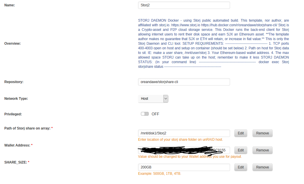

1.) add a second share for storj (i did storj and storj1)
2.) download this docker again, but change path from /mnt/usr/storj to /mnt/usr/storj1 [YOU DONT NEED TO CHANGE THE PATH INSIDE THE DOCKER!]
3.) start storj1, stop it
4.) change config file which was created in storj1 like payment adress, do not traverse, rpc adress, max tunnels, storage and max file size to your needs
5.) i always add the node to https://storjstat.com/index.asp#! for easy checking
6.) finish
Im just not sure by now if i need to change ports, if so, then also change ports.

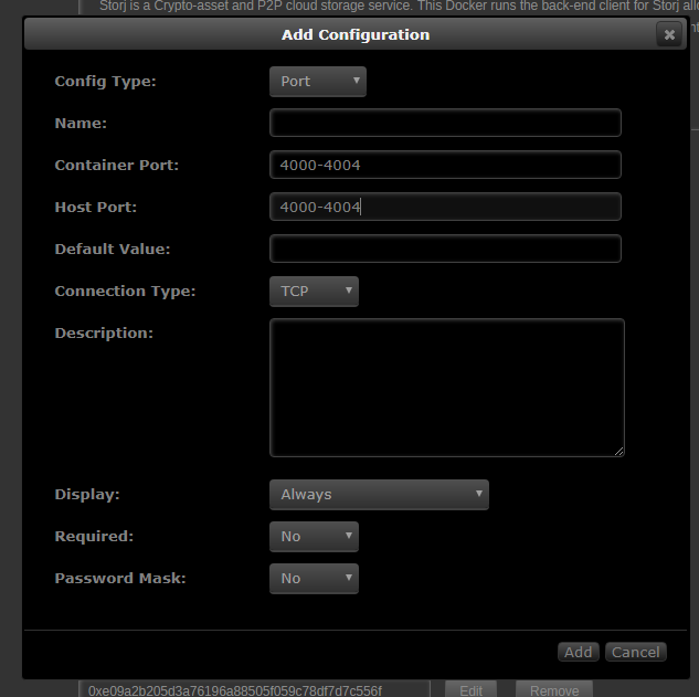

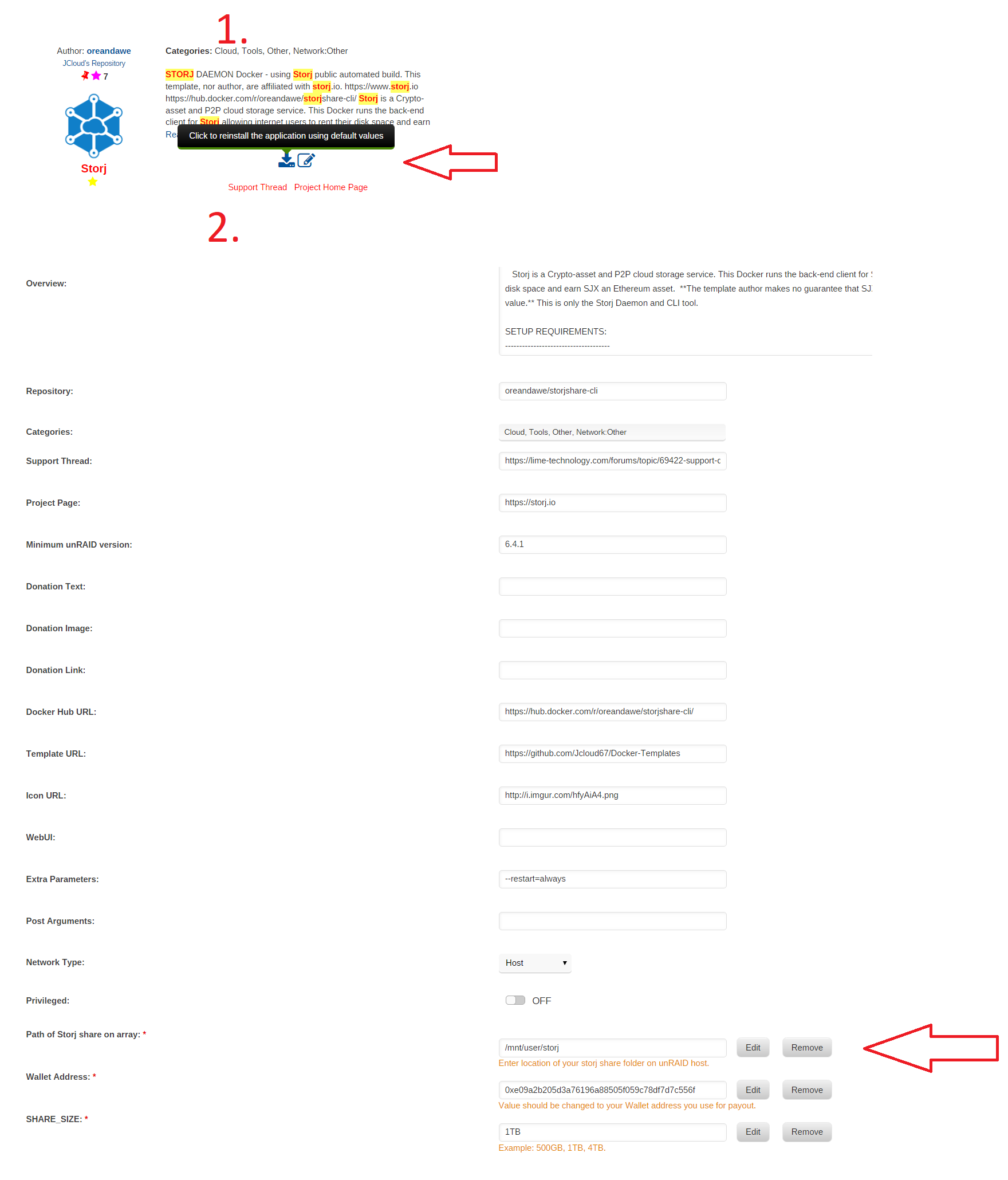

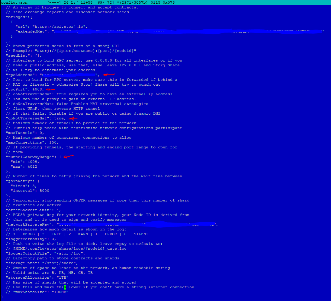

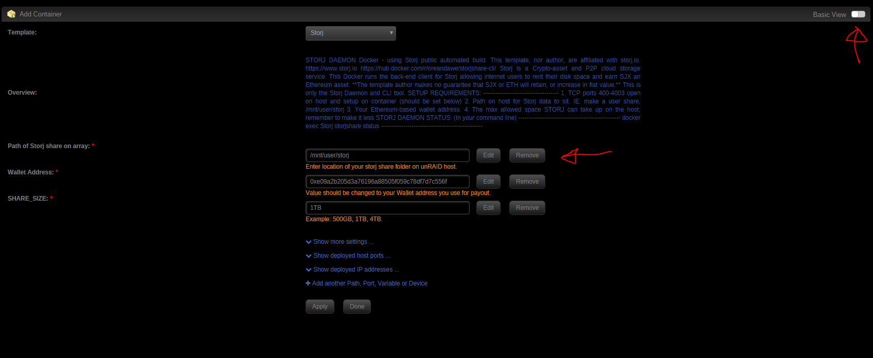

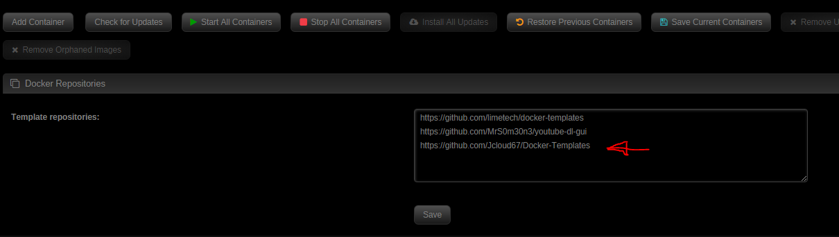

Figured out fool proof way to add additional nodes using multiple containers. I was not able to find the Storj container using community apps plugin, so here is how I did it:

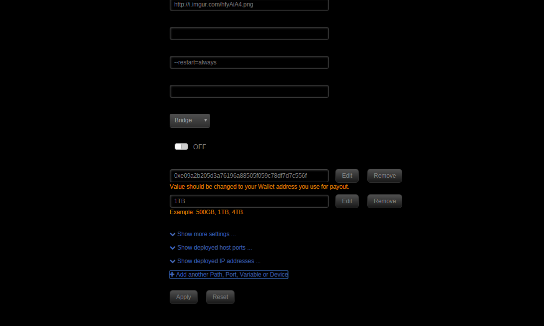

1. Add repository (address field with red arrow) and click "Add Container"
2. You will then see the container/docker configuration screen. Here you need to delete the line with address (red arrow) and switch to advanced view in the top right corner.
3. Then switch from Host to Bridge
4. Add storage location again (you have to use separate folders for each storj container/ docker) and the network ports you plan to use (I used a field of 4 ports for each container: 4000-4003 for container 1, 4004-4007 for container 2 etc.)
Install3.PNG.4a547110213209715248cd7b086a1739.PNGInstall3.1.PNG.35288f9fefb9d34716d325e322e0f820.PNG

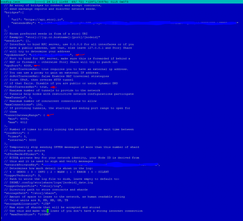

5. Launch the docker, then shut it down immediately and edit the config file located in the folder you pointed to earlier.
Edit the following fields:
"rpcAddress": "yourdomain.ddns.com",
"rpcPort": 4000,
"doNotTraverseNat": true,
"tunnelGatewayRange":  {
"min": 4001,
"max": 4003
6. Now you can relaunch the container. Everything should run fine... I have 3 running now... I think some steps are possibly unnecessary like deleting the storage field before reentering it as well as using 4 ports for each docker and specifying the tunneling ports. This config worked for me though, so here you go. Don't forget to forward your ports though the NAT and the firewall.

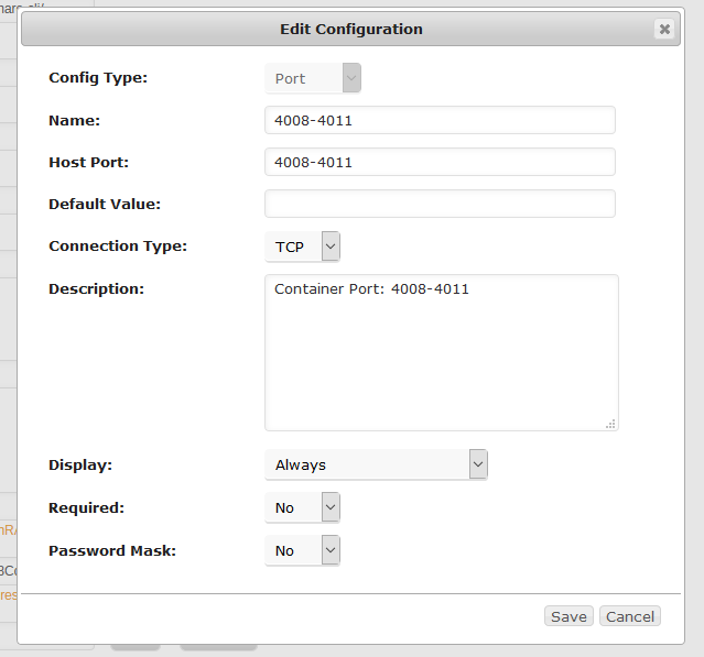

Clould you post an screenshot of your port mapping column in the docker tab?
In the port configuration in unraid I only have Host port not Container port...
@L0rdRaiden You need to first enable the advanced view and switch the container networking from host to bridge. You should then be able to see all the options you need. The screen shot of my view is in the post above.

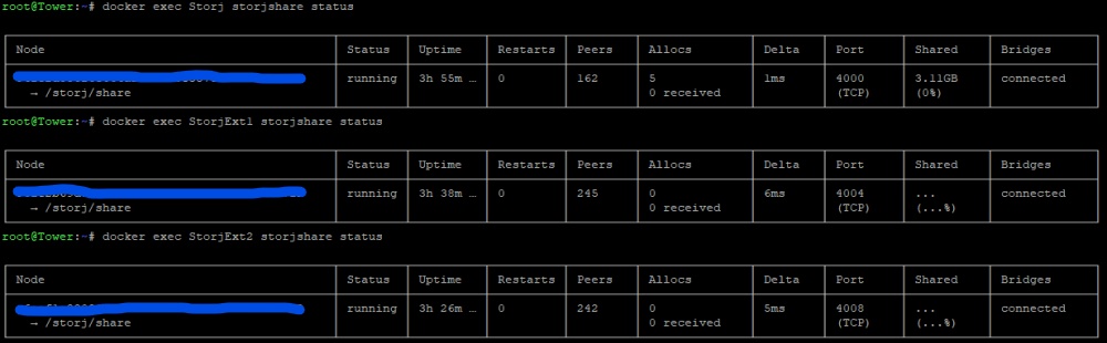

@MrChunky I have already running several Storj containers the problem is that despite having them in diferent ports and working unraid tell me that they are using the same ports.
THe json files have differnet ports 4000 4004 and 4008 and the firewall has open this ports and reporting the traffic correctly
Still in advance mode I don't see the container port field
root@MediaCenter:~# docker exec Storj3 storjshare status
│ Node                                        │ Status  │ Uptime   │ Restarts │ Peers   │ Allocs        │ Delta   │ Port     │ Shared    │ Bridges      │
│ dcea81e7741aeb8db49174ac5821d9035b00e532    │ running │ 2m 25s   │ 0        │ 129     │ 0             │ 18ms    │ 4008     │ ...       │ connected    │
│   → /storj/share                            │         │          │          │         │ 0 received    │         │ (TCP)    │ (...%)    │              │

@L0rdRaiden That's because your containers are in host/br0 modes. They need to be in bridge modes. the container port field is only relevant in bridge mode.

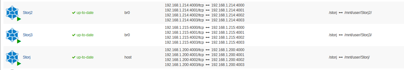

So in the firewall are you doing port forwarding of 4000 only for the first container or for the range 4000-4003?

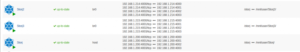

On the other hand I still don't get why unraid\docker reports the same ports for all the containers despite these are different as you can see when I post the storjshare status
Edited by L0rdRaiden
bc storj shows whats in his config
But that has nothing to do with unraid...
In my json files for the storj containers I have 4004 for Storj2 and 4008 for Storj3. If you look at the storjshare status they are using those ports not 4000
What response time are you getting? I have between 6 and 10 secs
2313 ms on old node
12645 (and rising) on new node.
Seems normal.
I dont really understand what you mean.
I saw on the pictures that the storj is correct configured ports. But that doenst has anything to do with unraid port forwarding.
On each docker you should be able to add just the ports this docker need.
I am talking about this picture where all use 4000
