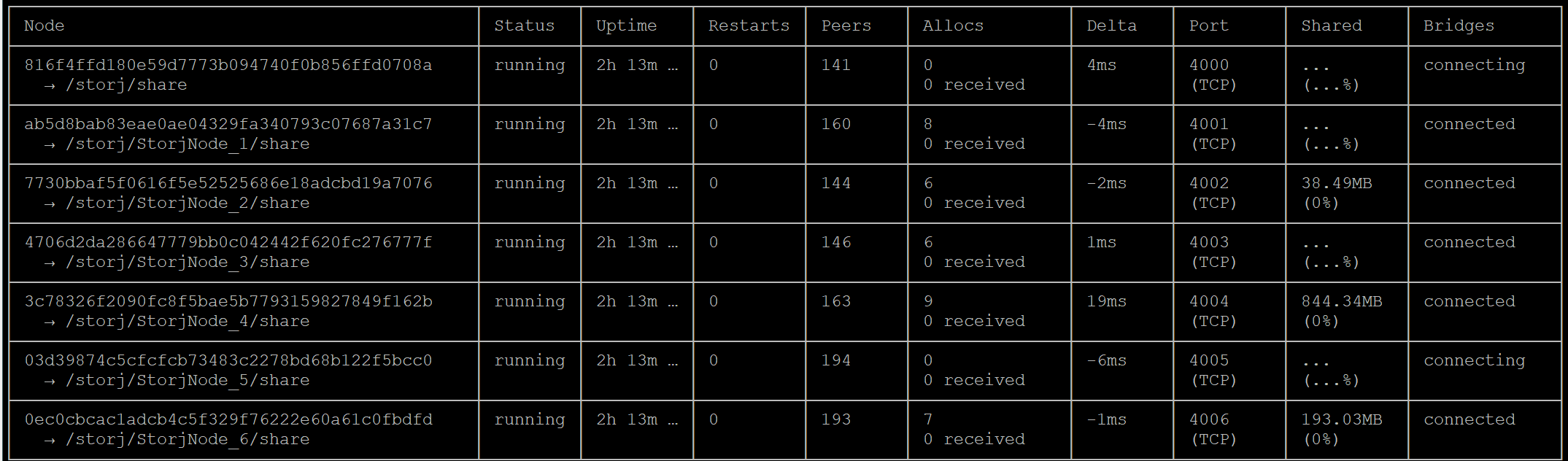

Anyone else experiencing this? image.thumb.png.1d7384b6efcd4f706d7a50d5073825e7.png
all but 2 nodes are connected and working fine.  The other 2 are "connecting".  Odd right?
Are you running container as bridge or host mode? And yes, definitely odd. Also, for S's and G's, double check your firewall to make sure it includes those ports.
EDIT:
I'd also look at the different config.json files of node0,5, and a working one like 1 -- if these were imported from another container.
But, my gut feeling says firewall, or at least starting there.
Edited by Jcloud
br0 w/ fixed IP.  Worked fine for my other version (and the rest of the nodes).  Just odd those 2 won't connect.
oh interesting, just checked and now only 1 is "connecting", the rest are connected.  I'll just give it more time :)
"Slow node" perhaps? Honestly, IDK.
EDIT: Hmm have an idea about that since you you're on bridge. I need to look at if it would a change on my end or something you can tweak.
Edited by Jcloud
