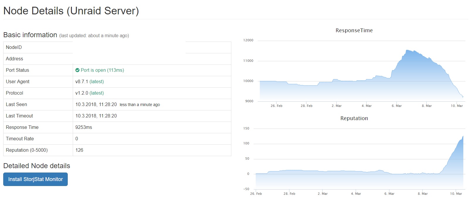

@TE would be cool if u could add https://github.com/calxibe/StorjMonitor so you would have advanced statistics on https://storjstat.com/
lastSeen	"2018-03-13T22:58:39.032Z"
port	4000
address	"HIDEN"
userAgent	"8.7.1"
protocol	"1.2.0"
spaceAvailable	true
responseTime	10487.266912038152
reputation	162
I have attached the log
https://ssdynamite.com/
Response Time: 10454.3882845237
Last Timeout:
Timeout Rate: 0
Your node is reachable.
Delta: 45 | Good
Status: Your address is public and traversal strategies are disabled. Good.
Receiving: ...
You have received 1 alloc requests. | Good.
You have sent 1 alloc responses. | Good.
No shards have been reaped. (Removed)
I have change the log configuration to produce more detail, lets see tomorrow what I can read.
Delta was a problem but since yesterday I applied this changes to unraid (minpoll 6 and maxpoll 10) and now is working better  <- @limetech
https://access.redhat.com/solutions/39194
I don't know what else I can do? any idea on what could be wrong?

Why u think something is broken? Looks fine to me. (just because the dots? I wouldnt care)
I haven't gotten a single bit to store after many days right now I have 40 allocs 0 received a 0 stored, everyone else is getting something after a few hours or a day
21 hrs more and 0 bits... I am gonna kill this
If you not patient then just remove it.
Its random.
Its no mining.
Its real ppl storing their data. They dont store 24/7.
Its random.
Its no mining.
I have kill it and created a new one, now is working 5 MB in one night at least. I think there was something weird with it.
