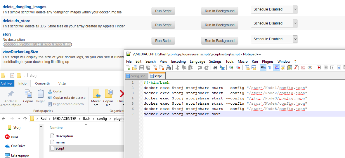

For the script this is the setup (image)

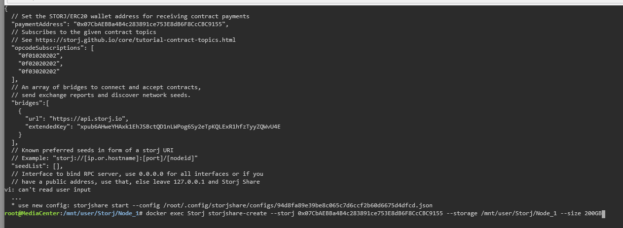

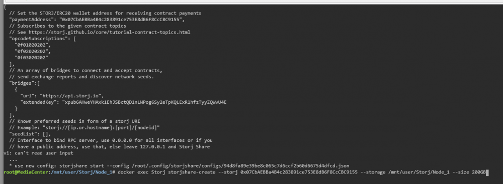

If I run the comand below in the screenshot I get the output above the command
Every time I run the command it writes a new Json file but I don't know where it is stored
Every time I run the command to create a new node I get this error
The path are fine, is case sensitive, I don't now what could be failing, I have found this https://github.com/Storj/storjshare-daemon/issues/122
but I don't know how to use it to fix this issue
Any idea?

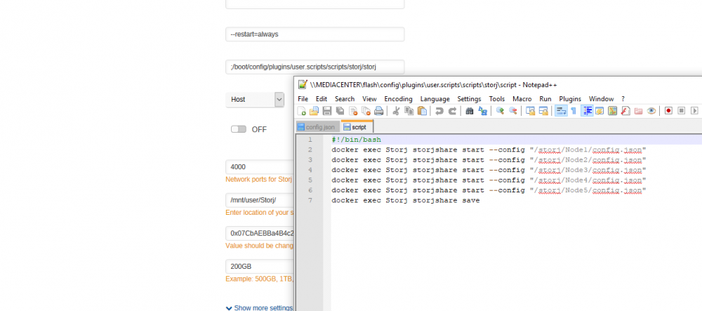

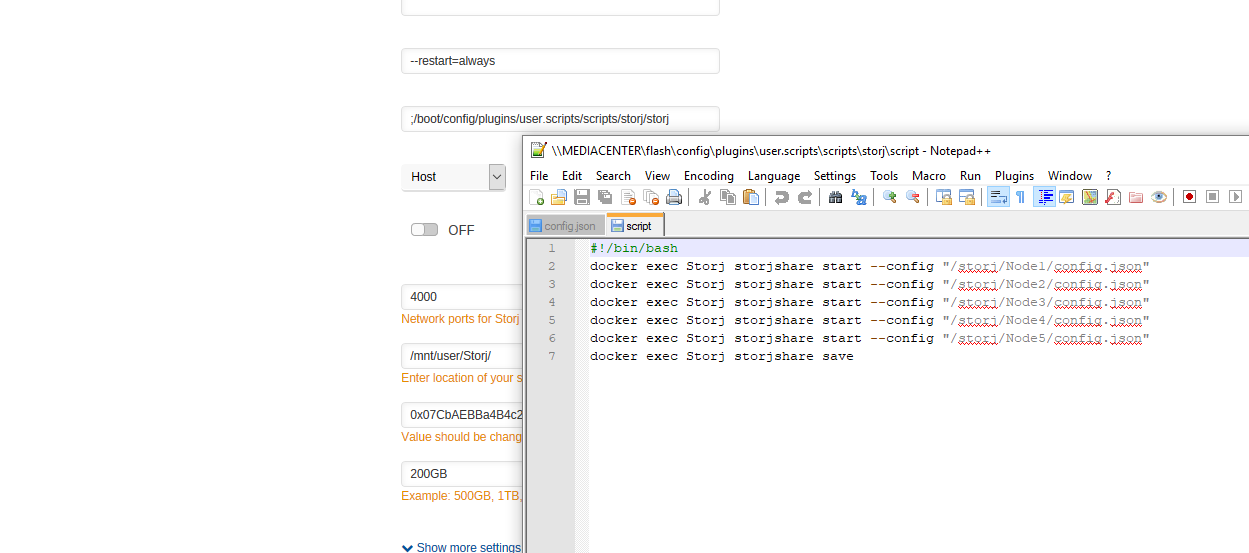

I am trying out multiple nodes, is there a way I can configure them to automatically start after an auto update to the storj docker?
adfsafds
Arg forums and cutting/pasting. @L0rdRaiden check that command line, Linux is case sensitive  (Sorry, you know that) also it's the the path with respect to *inside* the container so try changing:
--storage /mnt/user/Storj/Node_1    to:
--storage /storj/Node_1
This will make it the config file go to (in unRAID host) to: /mnt/user/storj/Node_1
I know, sorry, it's command-line version of "Inception" (the movie; or 13th Floor for you purists ;) )
I've been trying to work on this too, I don't have a great working solution yet. My first attempt at doing this (seems to work about 50%) is outlined here
Yeah I saw it earlier after I wrote. I will try your solution, thanks! :)

Thinking about this at work, since I've been away from box for a few days, I think this works for when one updates the template, but doesn't actually work for the automatic updates. Which I think is why I thought, "it worked 50% of the time."   So, my mistake. I think I was looking at CA userScript plugin, making a "stupid" scheduled task, about 10 minutes after the update Window, which would kick off loading the multiple nodes.
Yeah I am doing the "stupid" script now aswell, but there has to be a better solution.I will continue to research.
