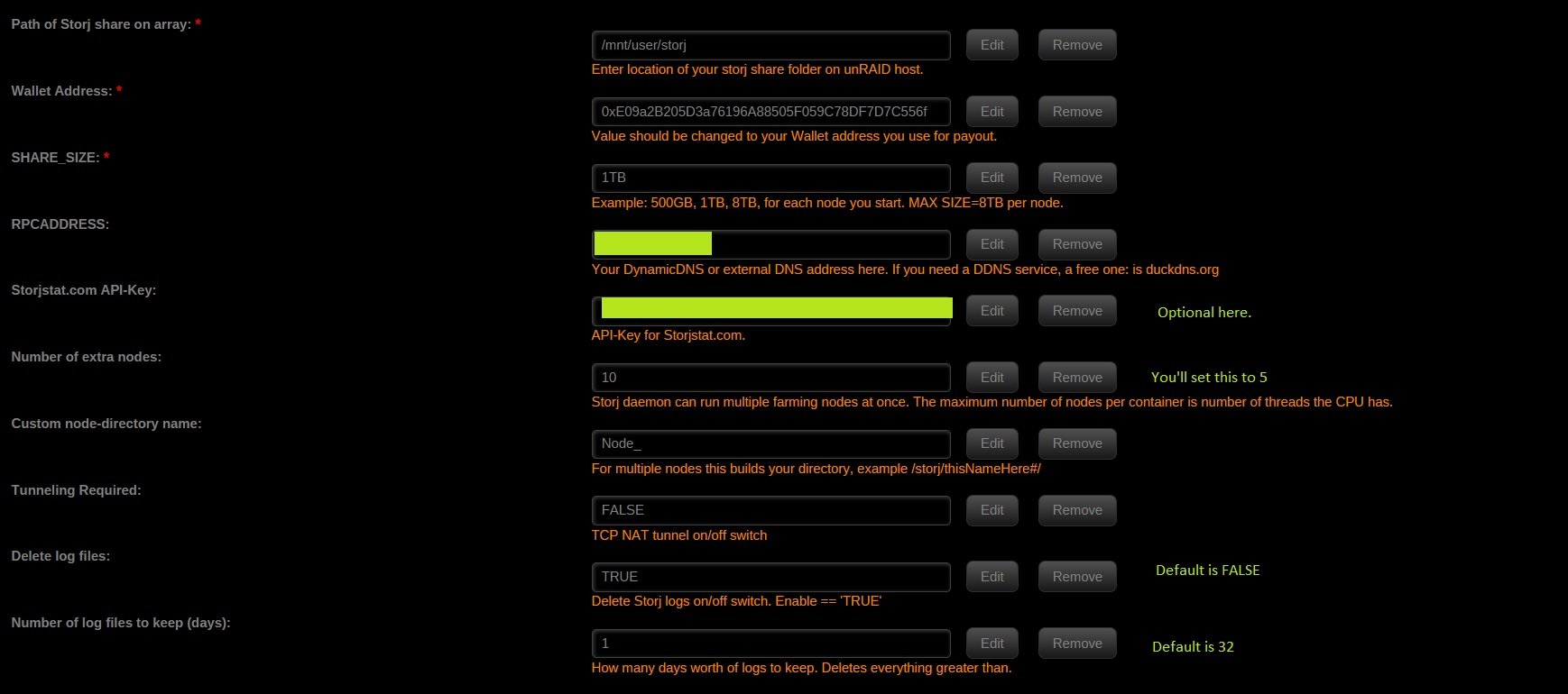

hmm all im getting is bridge is connect and in logs, "{"level":"error","message":"Unable to connect to bridge: https://api.storj.io, reason: Bridge request failed (500)",""
iv open ports 4000-4003 also

  • The Docker reports tunneling due to a choice I made making template,  If you want to remove that tunnel, in the template settings change "Network Type" from, "Bridge" to "Host" and then remove "Storj

I have fix it adding the port mapping manually. But I think the problem is that it only map the ports the first time you create the container if you change the number after that the port mapping doesn't update
Yeah the template doesn't change auto-magically, you do have to make the changes manually. Correct, it will only list the four ports, because those are the only ones "exposed," by the Dockerfile, but since you've added the port field on the container; then listed 4000-4010 (or whatever is the range which covers your number of nodes) it will work - Should list (TCP) for all of them, if you see (UPNP) then in the config file for effected node change:   (from false)

For each node that is bridge go into its config.json file; look to see if "doNotTraverseNat" is set for true or false - if its on false, set it to true. Repeat this for all effected nodes, then stop your container, restart the container, and then check status again.
If after making the changes, the nodes go from tunneled to broken, then your firewall needs to be opened up for the entire port range used by all your nodes, from 4000-40xx where xx is the number of nodes you're running.

oh i got it, dumb mistake on my part. For my external IP DNS i didnt put http://

Go to Community Apps plug-in do a search for, "StorjMonitor" and grab that; the template is going to look similar but have more options.
Before this will really work well, you'll want to open each ../storj/Node_*/config.json file with nano, vi (or notepad++  something which handles UNIX carriage-returns):
  1.    change: "doNotTranverseNat": false,    ---->  "doNotTraverseNat": true,
  2.    For each Nod_#/confi.json file  I recommend changing "rpcPort": 4005,  to  4001
    • rpcPort for Node_1/config.json    becomes    4001
    • rpcPort for Node_2/config.json    becomes    4002
    • rpcProt for Node_3/config.json    becomes    4003
    • way less network ports needed that way.
Hope that clarifies things. If something is still unclear just ask. :)
