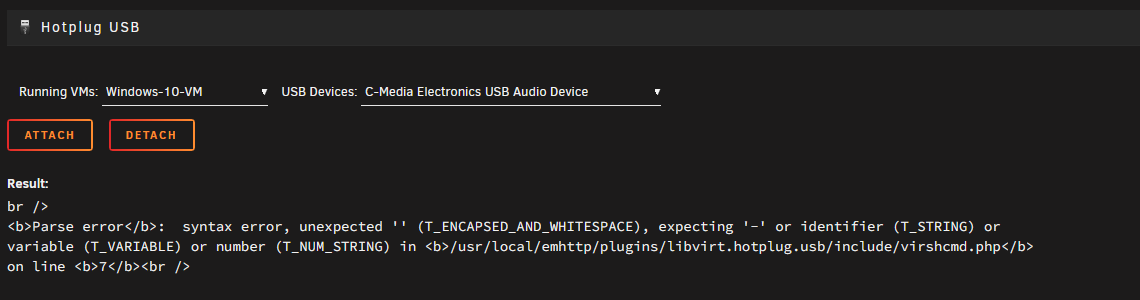

@dlandon I get with the new version a Error:
how can i downgrade ?

Thanks the last version works now.....

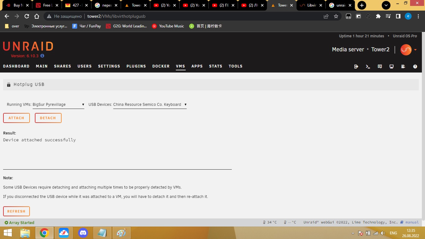

Libvirt Hotplug USB plugin in bigsur. In other MacOS all good. But in Bigsur i can only detach. Atach don't working. Libvirt write me "successfully". But keyboard and mouse don't working

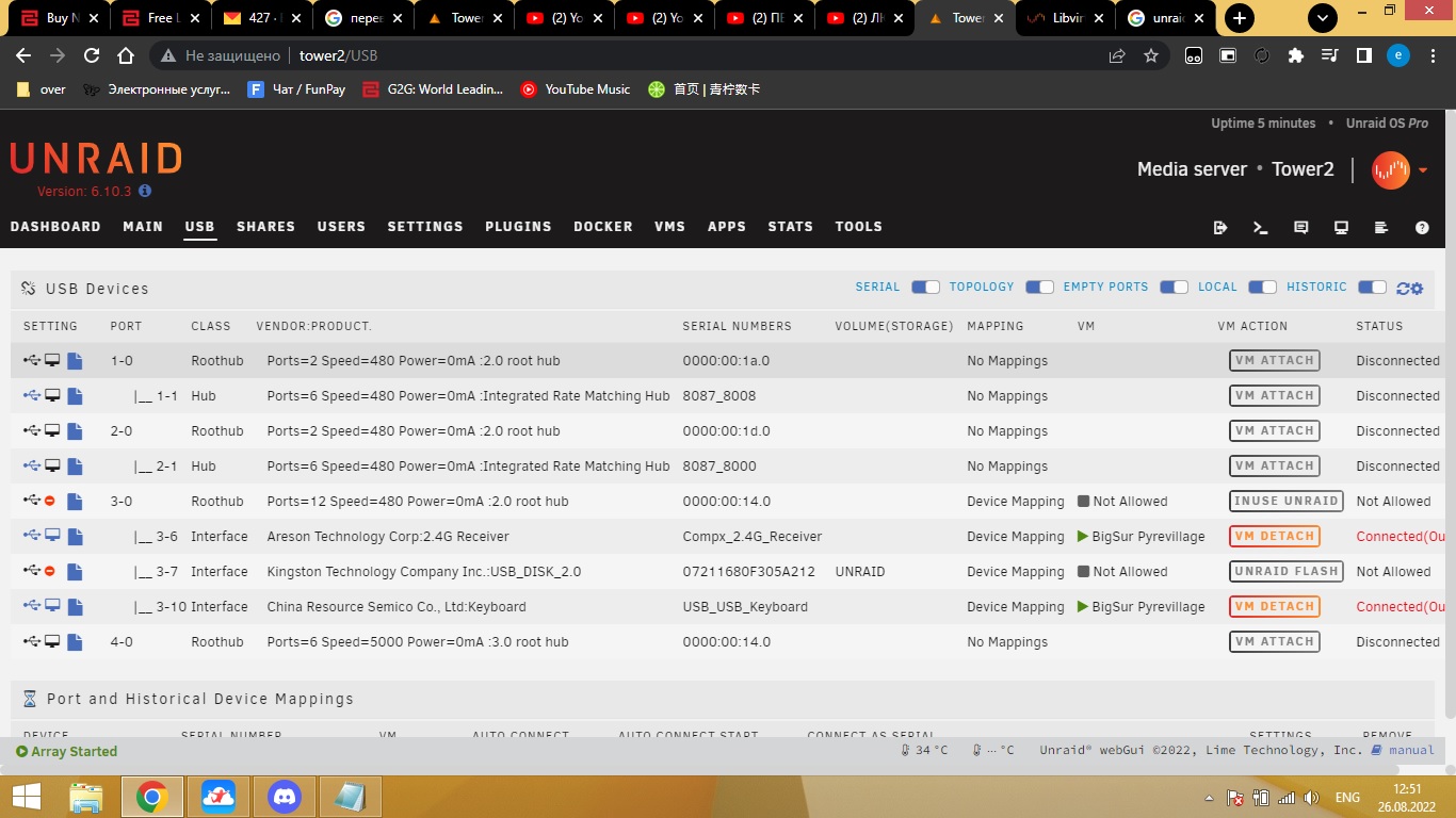

Go to the Libvirt Hotplug USB page and click on the device to be attached and attach it.  Then click on the 'USB Devices' to show the list of devices and get a screen shot of that whole page and post it here.

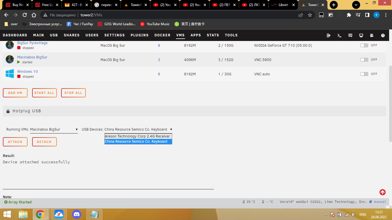

I wanted to see the list of devices.
The problem is that it says it attaches, but doesn't?  And no error is shown in the 'Results'?

In Results successfully. But In BigSur don't  working mouse or  keyboard
On High Sierra and Mojave all good working
Sounds like an incompatibility with libvirt and BigSur.  Stop your VM, edit the VM xml and select that device at the bottom where the USB devices can be selected, then restart the VM.  See if it attaches then.
