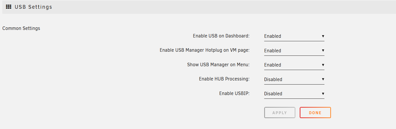

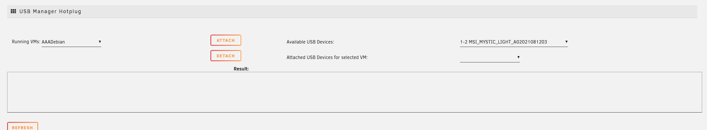

There is a VM page hot plug in USB Manager also does exactly the same as this plugin, you don't have to use the other functions.image.png.0f725a7d5fed23b96bca7ca8b2d779
Never saw that, looks like it has to be manually enabled.

If it helps, I had to disable, apply, enable, apply "Enable USB Manager Hotplug on VM page" to get it to show up in the VM page.  Just installing the plugin isn't enough.
Maybe an Conflict with the old libvirt Plugin.
I removed this and disabled/enabled the Options in the USB Plugin and I became all? Options showed.
