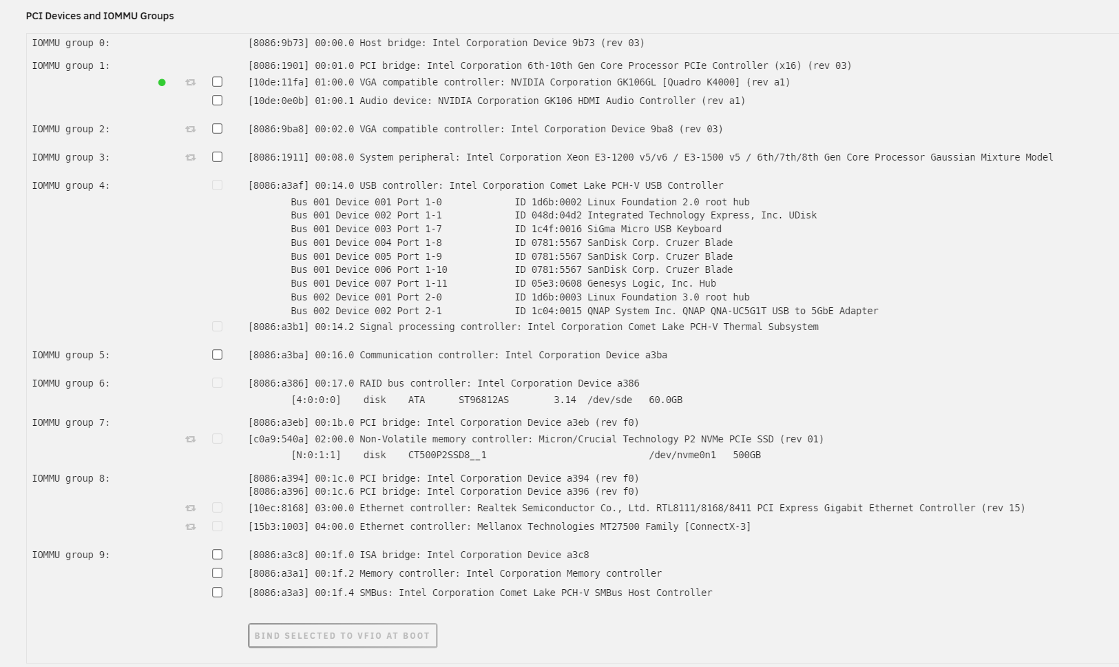

This app rocks.  Both of my USB controllers are in the same IOMMU group and I am out of PCIe slots so adding another controller would not be an option.  Not quite as good as hot swapping natively Windows, but certainly much much much better than nothing.
Thanks for pointing it out!

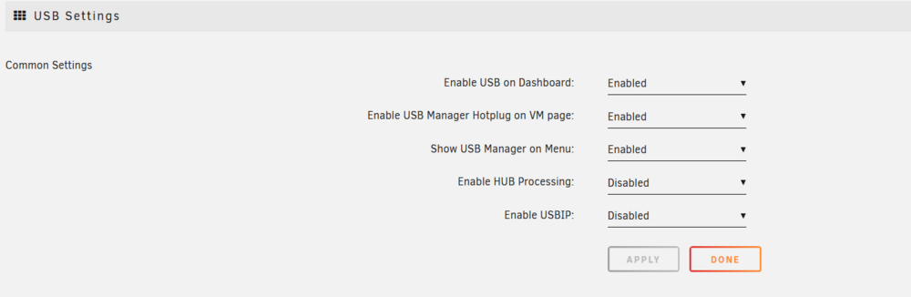

I found your plugin from the plugin menu of Unraid, installed it and went to the setting page, however it went to a blank white screen. I hit browser refresh several times, but no good. So I did a reboot, unRaid did not bootup. So I powered off my system.
I powered it back on, but it did not switched on - WEIRD!
After an hour of tinkering, machine did not power on still. What a coincidence.
Not sure what went wrong, but another prob of mine is how to revert back the unRaid USB. So noob of me
Have you tried booting in safemode, i.e. with no plugins? @garydapogi Maybe open a general support also
Edited by SimonF

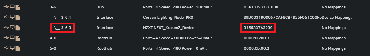

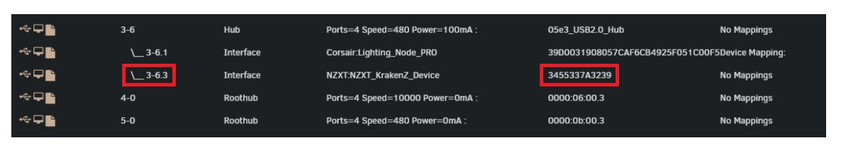

Trying to use this plugin to determine my NZXT AIO cooler and can't determine how to perform the following:
Installed the plugin and attached to VM, but no idea how to obtain the information posted above, and suggestions?
Thanks

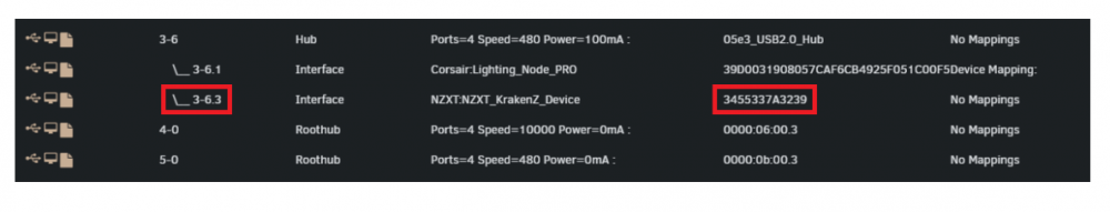

Thanks
What is it you are trying to do?

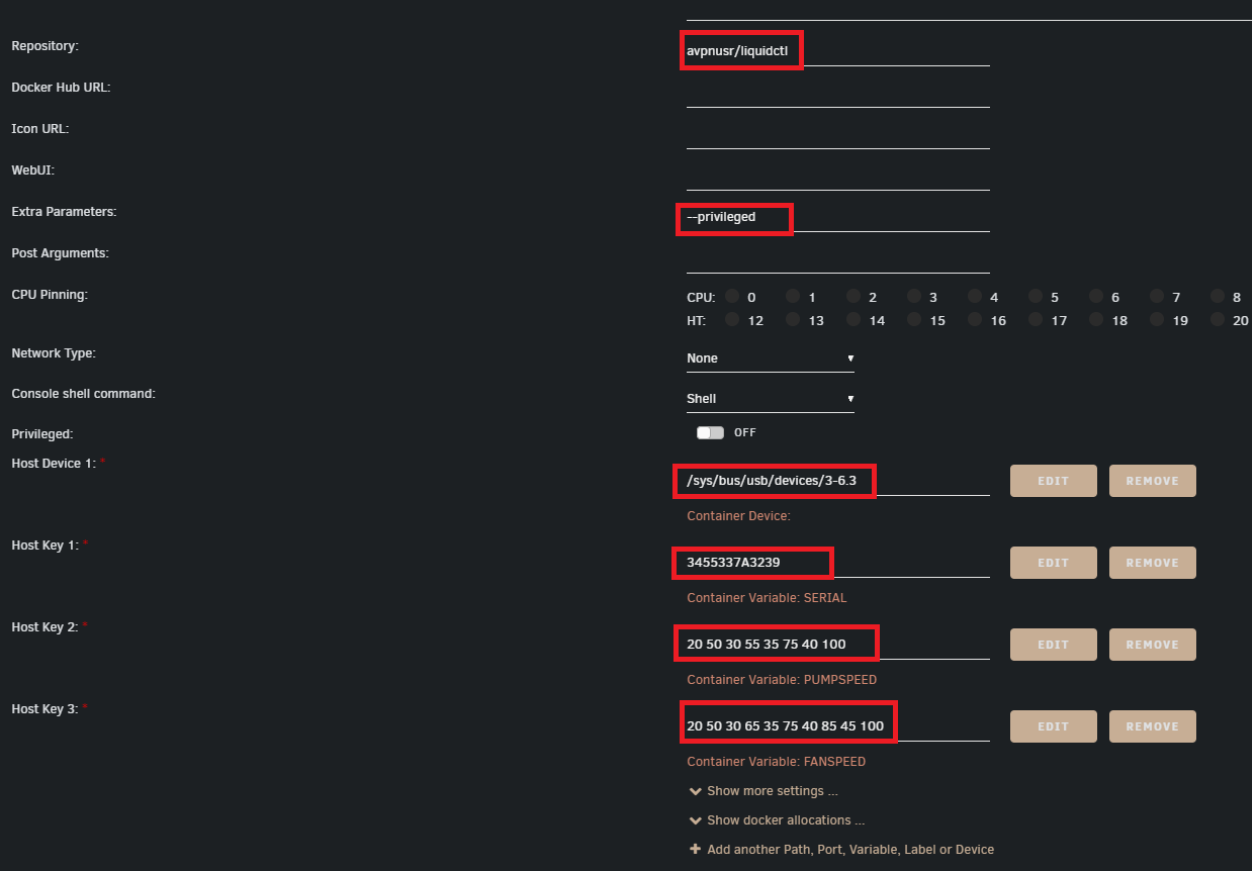

Us the Liquidctl docker app for my AIO cooler:
avpnusr/liquidctl - Docker Image | Docker Hub
Prerequisites
I highly recommend to use the following plugin for UnRAID from the Community Applications:
Libvirt Hotplug USB
Determine your USB-serial and "bus port"
I use this for easy detection of the serial of the USB-device, as which the AIO-cooler will be detected. As there is no guarantee, the AIO-cooler will be mapped to the container alone, the serial explicitly addresses this device.
Also you need the "port" from the usb bus, so you can map the device to the container.
In my example this would be /sys/bus/usb/devices/3-6.3
Prerequisites
Libvirt Hotplug USB
The image is from my plugin not USB hotplug.
Which version of Unraid are you using, on 6.10 the usb port number is now in system devices.
Yes, 6.10 RC1 and I will take a look. So the information provided
For the Serial I assume is: iSerial                 3 00000000001A
Based on the output below:

59 minutes ago, Govnah said:
/dev/bus/usb/009/004
have you tried this ^ or /sys/bus/usb/device/9-6.2 for device?

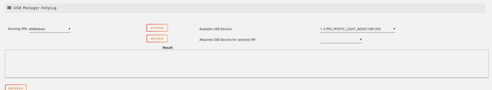

11 minutes ago, Shantarius said:
How can i passthrough automatically to the VM after turning on the Printer
Have a look at my usb manager plugin as can auto connect a device when detected by the system. You can specify by port or device.
Edited by SimonF
Wow this is great and exactly what i need. Now i can use a Debian VM use as a (AirPrint)Printserver. If the Printer is off, the printjob is waiting in the cups-scheduler until i have turned on the printer and the printer auto connects to the VM 🙂 Very nice!
