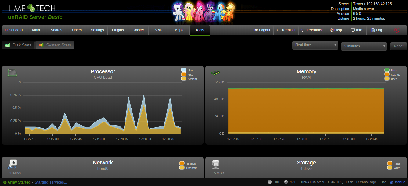

What are you doing to determine RAM usage? Are you looking at System Stats? If so, are you talking about the portion of the graph representing "cached"?

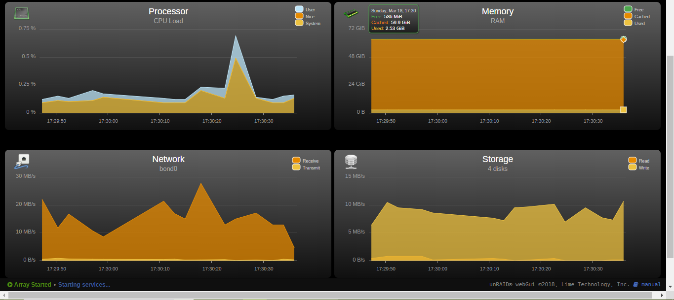

This is how i am seeing the RAM usage. The lack of performance is apparent in its inabiliy to run menus or even one direct stream (my laptop does better).
The RAM usage looks perfectly normal:  https://www.linuxatemyram.com

The memory utilisation looks completely normal.  Linux operating systems generally use spare RAM as cache since it's faster than disk drives.  The important part is the Used section in the lighter colour - that's well under 10%, so not a problem.  Also see the utilisation reported under the Dashboard tab.
Lastly, a basic outline here - https://www.linuxatemyram.com/

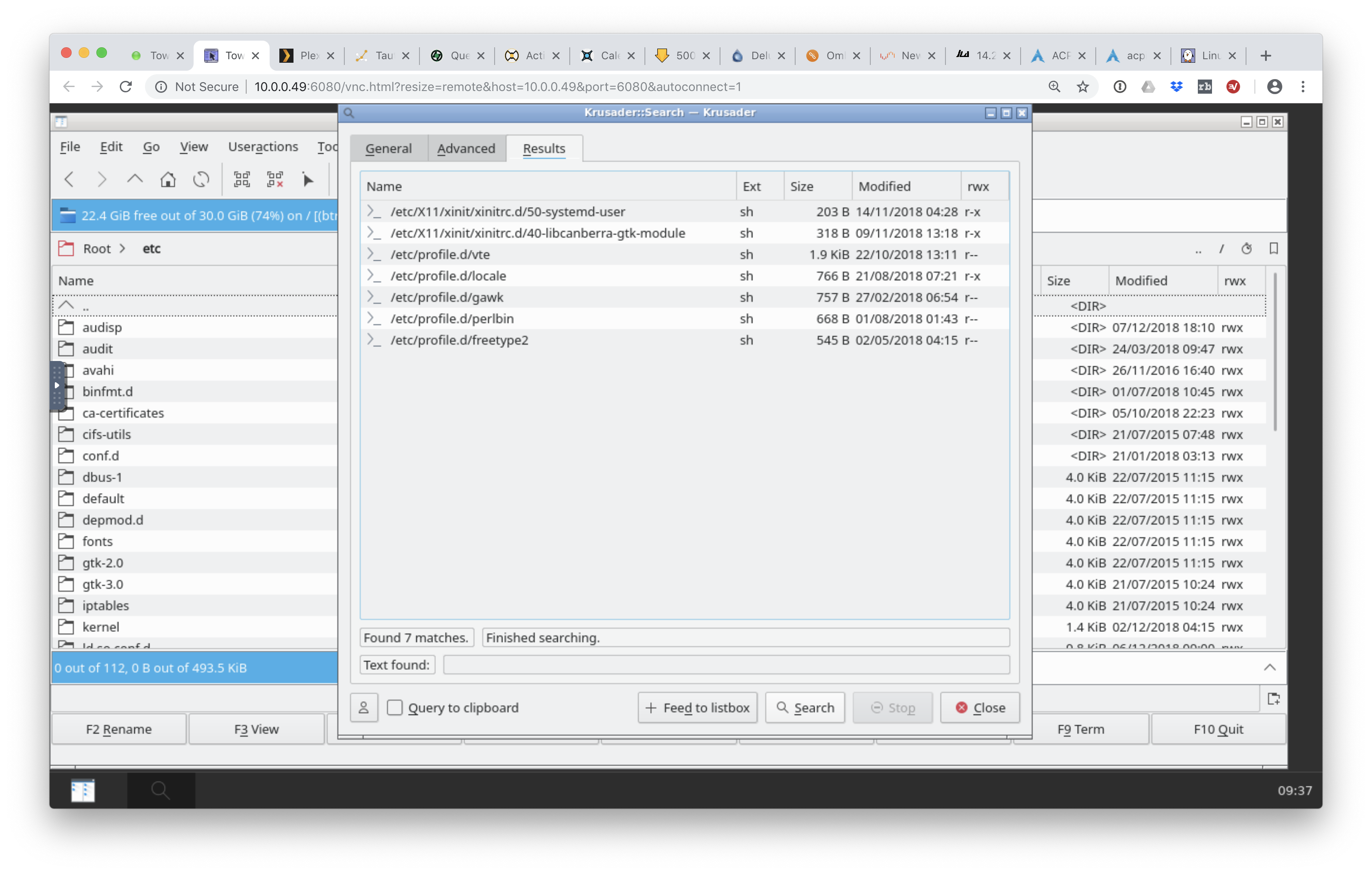

Now I have the problem that my system doesn't have an /acpi folder in the /etc directory and when I search for *.sh files there isn't an acpi_handler.sh file in my system???
Because you're using Krusader, you're looking at what's in Krusader's folders (its OS, not unRaid's).  You've got to use the command line as specified
