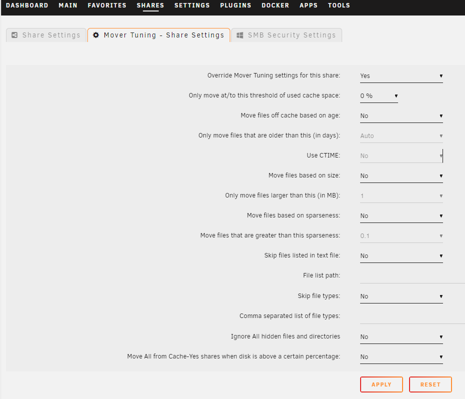

You can set Share B to Cache:Yes (Cache->Array) and a share settings for mover tuning like this:
Then ALL files from share B will be moved to Array
Files of share A that are on Array will be moved back to share A if any, and if there are not enough space on cache during moving, then the overflow from cache to array will occur for older files.
You may as well use these settings instead:
(not much tested for 2024 version, please report)
If share B is set to Cache:Prefer (Array->Cache), then the most recent files from A and B stays on cache. I believe that this is the most efficient way to use a cache: keep most recent files.
The difference (without setting a custom config for a share) from 2023 to 2024 version here is that Cache=Yes (cache->array) files can be kept if they are recent enough wereas 2023 move all files with no question.

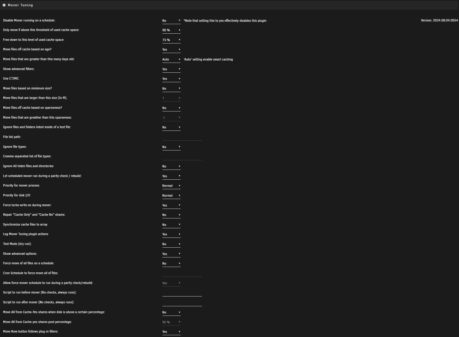

Update: 2024-08-04
  • Fix default Settings handling causing a "Unary operator" bug (R3yn4ld) (thanks to @alturismo)
  • Add freeing threshold option (R3yn4ld)
Coming next:
  • Fixing not ignoring hidden files bug
  • Better repair of shares when files out of there intended place (i.e. cache: only on array, cache: no on cache, cach2 files on cache1...)

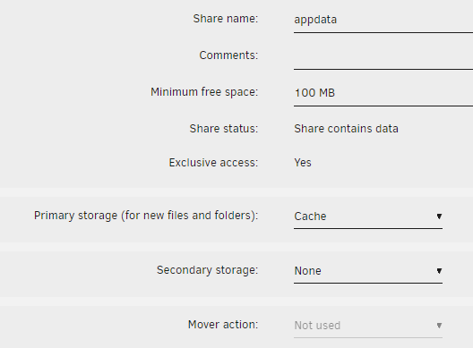

My appdata, domains and system shares are set to Cache:Prefer and when mover runs, VM images, docker and old files are now moved to array which is annoying to have them on HDDs (array) and no longer on SSDs (cache).
I want them to always stay on cache, not to move to array. It changes from the original purpose of mover (Mover action: Array->Cache) and from the 2023 version (all files remain on cache, old files are not moved to array).
You'd better set these Primary: cache; Secondary None, with a very low minimum free space. This is my setting:

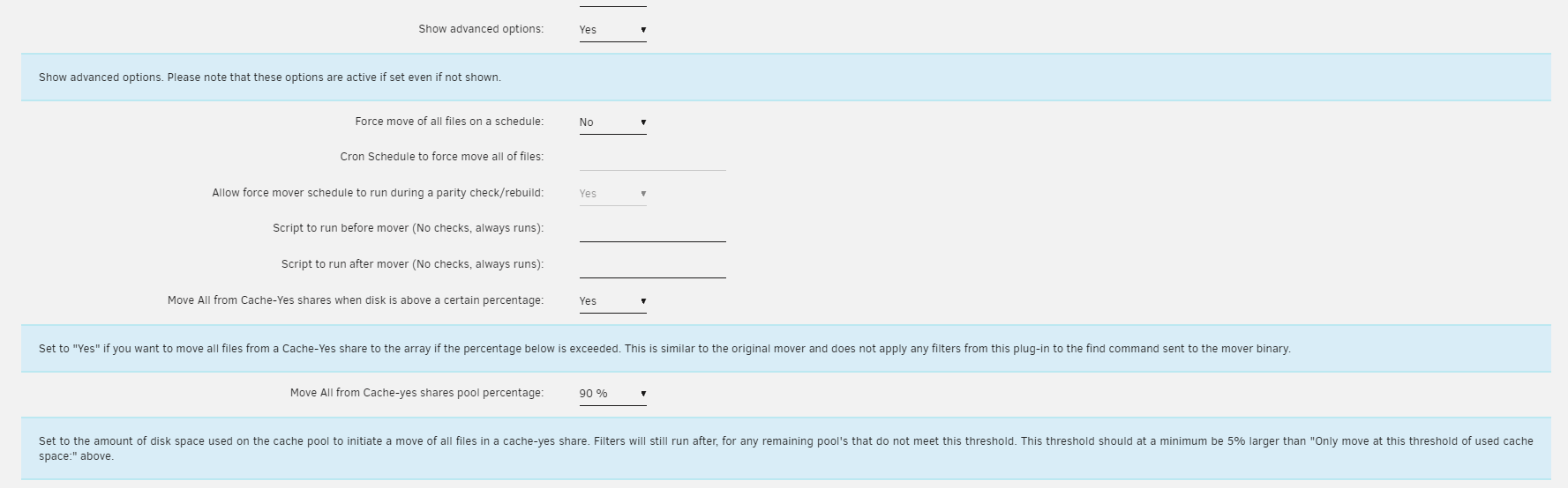

Only = Primary: [Pool name], Secondary: none, Mover action: not used
Prefer = Primary: [Pool name], Secondary: Array, Mover action: Secondary->Primary
 Yes, good point (It's already in the next version, will redo a pass to check on the UI)
If you set correctly the Cache:Yes and Cache:Prefer shares (sorry for using old naming, it's quicker) with larger Minimum free space (like xxGB or even xxxGB) you will never have out of space froblem for Cache:Only shares.
That's what I've done before and ended up to issues after cache was full before mover run. Shares with Cache:Yes were writing on array once minimum free space was reached, then my appdata share (Cache:Only) kept writing on cache on existing files until there was no more space and apps crashed with some corrupted files.
Keep in mind that, following unraid manual, Cache:Prefer is the default behavior for appdata, domains and system shares. So if people are not aware of this, their files will be spread across cache and array.
Prefer: Write new files to the cache if the free space on the cache is above the Minimum free space setting for the share, and if the free space falls below that value then write the files to the main array instead.
When Mover runs it will attempt to move any files for this share that are on the main array back to the cache as long as the free space on the cache is above the Minimum free space setting for the cache
It is the default setting for the appdata and system shares that support the Docker and VM subsystems. Generally, you want the files/folders belonging to these shares to reside on the cache as it provides better performance for Docker containers and VMs if their files are not on the main array. This is due to the performance overhead of maintaining parity on the main array which slows down write operations.
Just now, Peuuuur Noel said:
But if set to "No" it should use mover.old and not age_mover like in 2023 version?
No, mover.old is not used by mover tuning anymore. It caused issue with hardlinks, plus the "Synchronize cache files to array" cannot work with old mover.
Then limits are not set correctly (I myself had this situation quite a few times, it can happen on any system)

Hello @Reynald,
When attempting to run the latest version of the Mover Tuning plugin, I am receiving the following error message:
/usr/local/emhttp/plugins/ca.mover.tuning/age_mover: line 421: * 75 / 100: syntax error: operand expected (error token is "* 75 / 100")
unRAID then shows that "mover is running" but I have to then manually terminate by running the 'mover stop' command as it does not complete or time out.
Also, I changed Mover Tuning to use CTIME (instead of MTIME) but some recently downloaded items were also being picked up to be moved when I would have expected them to be left as there were files that were downloaded many weeks earlier that I would have expected to be moved first.
Diagnostics and "Mover Tuning" settings attached.
Thanks.
littlebox-diagnostics-20240804-1447.zip

Hi @Reynald,
Could you advise where I set the value for the "global freeing threshold" please?
Thanks.

Hi @Reynald,
Thanks.
It's a little strange as I had already set this value to 75%:
And when changed to 80%, the same error persists:
move: /usr/local/emhttp/plugins/ca.mover.tuning/age_mover: line 421: * 80 / 100: syntax error: operand expected (error token is "* 80 / 100")
I also tried changing to 85% and 85% matching your settings but the same error occurs:
move: /usr/local/emhttp/plugins/ca.mover.tuning/age_mover: line 421: * 85 / 100: syntax error: operand expected (error token is "* 85 / 100")
Thanks.
