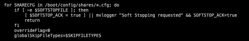

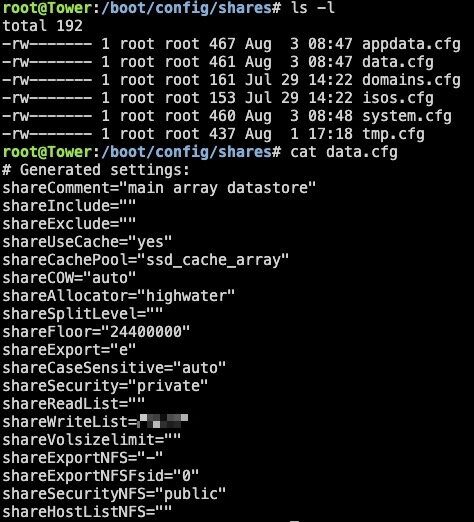

Ok, pretty sure I solve my issue.
TLDR - I only have 3 shares: data, appdata, system. Deleting the cfg files that don't exist fixed it.
However, as you can see above there were three .cfg files in the /boot/config/shares folder that don't match up.
tmp.cfg - i created a 'tmp' share thinking i needed it, but then deleted it in the UI a few days ago
isos - i think unraid created this automatially to support VMs but i don't use VMs so i deleted this folder form the UI too

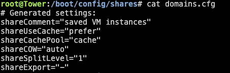

domains - no idea where this came from, maybe it was there on initial install of unraid a few weeks ago, probably deleted it in the UI too
Anyway, even those these shares no longer exist in the UI, these .cfg files are hanging around. And mover tuner uses them to do its work. You can see that here in the /usr/local/emhttp/plugins/ca.mover.tuning/age_mover file:
It is looping through all cfg files in that folder trying to get useful info out of them to set variables and such but the files are empty and worthless causing it to hang when it gets to the part of the script that requires those variables.
Possible solution: write a few more checks to make sure the cfg file is not one of these orphaned share configs and skip them if they are.
Very nice analyse @ZGief, and thanks for complements @alturismo
There is already a check on line 494:
if [ ! -d "$SHAREPATH" ] && [ $SHAREUSECACHE != "no" ]; then
# Do not process this pool if path does not exist
mvlogger "$SHAREPATH does not exist. Is the share still used? Consider removing $SHARECFG if not."
mvlogger "=> Skipping"
continue # Move to the next iteration of the loop
However, this adress a deleted or removed share, but deleted or renamed pool is not checked.
Is your cachepool still named cache? (that's in your domains.cfg)
You can modify the code like this, around line 438
        PRIMARYSTORAGENAME=$(grep "shareCachePool=" "$SHARECFG" | cut -d'=' -f 2 | tr -d '"' | tr -d '\r')
        if [ -z "$PRIMARYSTORAGENAME" ]; then
            PRIMARYSTORAGENAME="user0"
        fi
        # Check if the storage exists
        if [ ! -d "$PRIMARYSTORAGENAME" ]; then
            mvlogger "$PRIMARYSTORAGENAME does not exist. Is the pool still used? Consider removing $SHARECFG if not."
        fi
I'm going to add this in next version

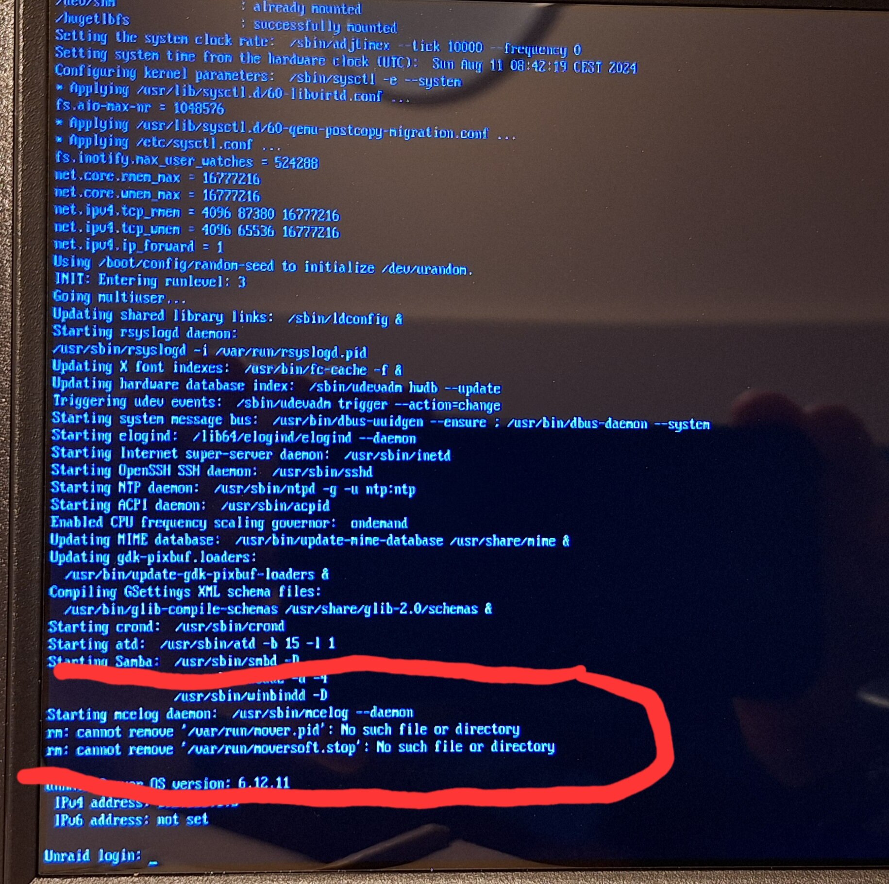

Issue: error message when booting Unraid
Hello,
I just installed the plugin and during booting the server I get this two errors:
rm: cannot remove ´/var/run/mover.pid´ : No such file or directory
rm: cannot remove ´/var/run/moversoft.stop´ : No such file or directory
Please see enclosed picture.
Is this normal or a problem?

3 hours ago, motoflyer said:
Unraid Version: 6.12.11
Mover Tuning Version: 2024.08.10.1532
Hello,
Hello,
This is a bug. I added these command in install script to clean leftovers of a previous interrupted execution.
Added some controls for next version.
These two errors do not affect the program's functionality.

Fixed error message about mover.pid and softstop file when installing the plugin or booting Unraid
