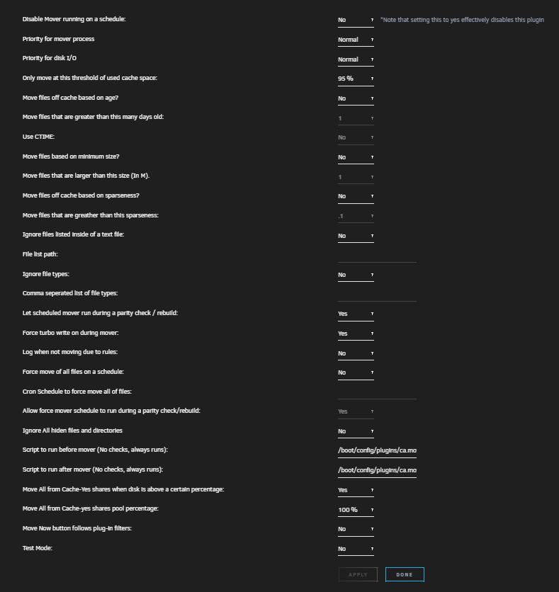

Hello,
I know there is a lot of posts about this awesome plugin, but it also hard to find answer for my question (tried with search feature).
So...
moverDisabled="no"
moverNice="0"
moverIO="-c 2 -n 0"
threshold="95"
age="no"
sizef="no"
sparsnessf="no"
filelistf="no"
filetypesf="no"
parity="yes"
enableTurbo="yes"
logging="no"
force="no"
ignoreHidden="no"
beforeScript="/boot/config/plugins/ca.mover.tuning/dockeroff.sh"
afterScript="/boot/config/plugins/ca.mover.tuning/dockeron.sh"
omovercfg="yes"
movenow="no"
testmode="no"
omoverthresh="100"
These are my settings for mover tuning.
I would like to stop before moving files few dockers, and after process is complete I want to start them back.
Here is my script for that:
#!/bin/bash
docker stop binhex-deluge
sleep 1
docker stop binhex-lidarr
sleep 1
docker stop bazarr
sleep 1
docker stop binhex-plexpass
sleep 1
docker stop binhex-radarr
sleep 1
docker stop binhex-sonarr
exit 0
and of course same code is for start (stop word has been replaced with start obviously).
Why my dockers don't want to stop, or even if I manually stop them, they won't start after moving process?
image.png.28955f7e3fb85144b43e7ea971471214.pngimage.thumb.png.c119395fdf775726b86fe7f36c65edbf.png
thank You.

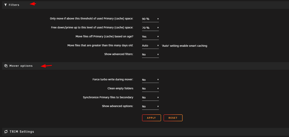

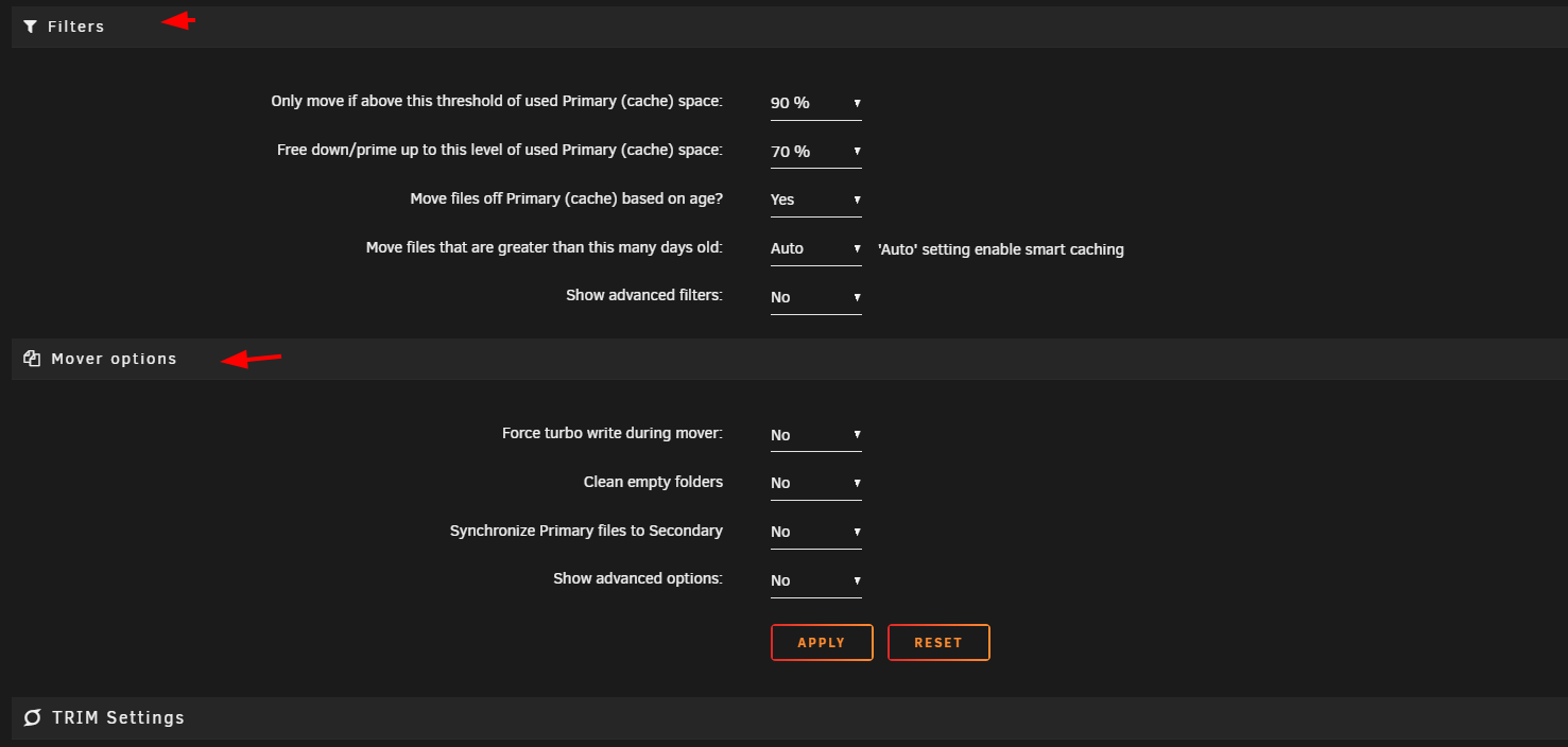

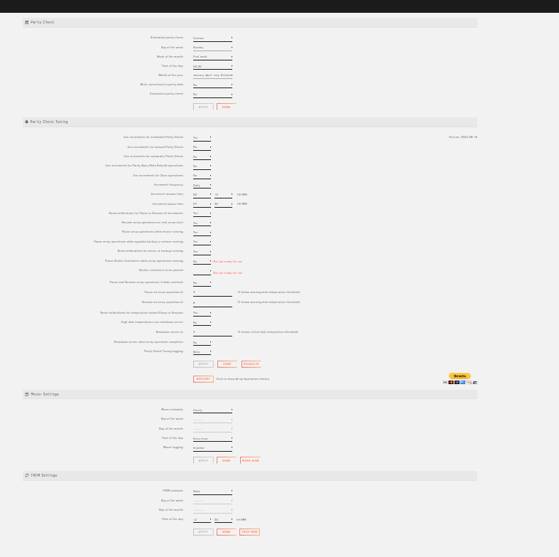

For some reason since the last update, mover tuning settings is empty:
What could be wrong?
Not seeing this issue:

Hello all, thought I would share since the recent plugin update as of today, 8/19/2024:
I thank all that are working on this CA Mover Tuning Plugin, most recent @Reynald.  I noticed a bug when running the Mover manually on a share, in my example "/mnt/user/media".  The command below has a slight typo near the end, where "move" should be "mover".
Original/Before:
"find "/mnt/cache/media" -depth | /usr/local/sbin/move -d 1"
Correction/After:
"find "/mnt/cache/media" -depth | /usr/local/sbin/mover -d 1"

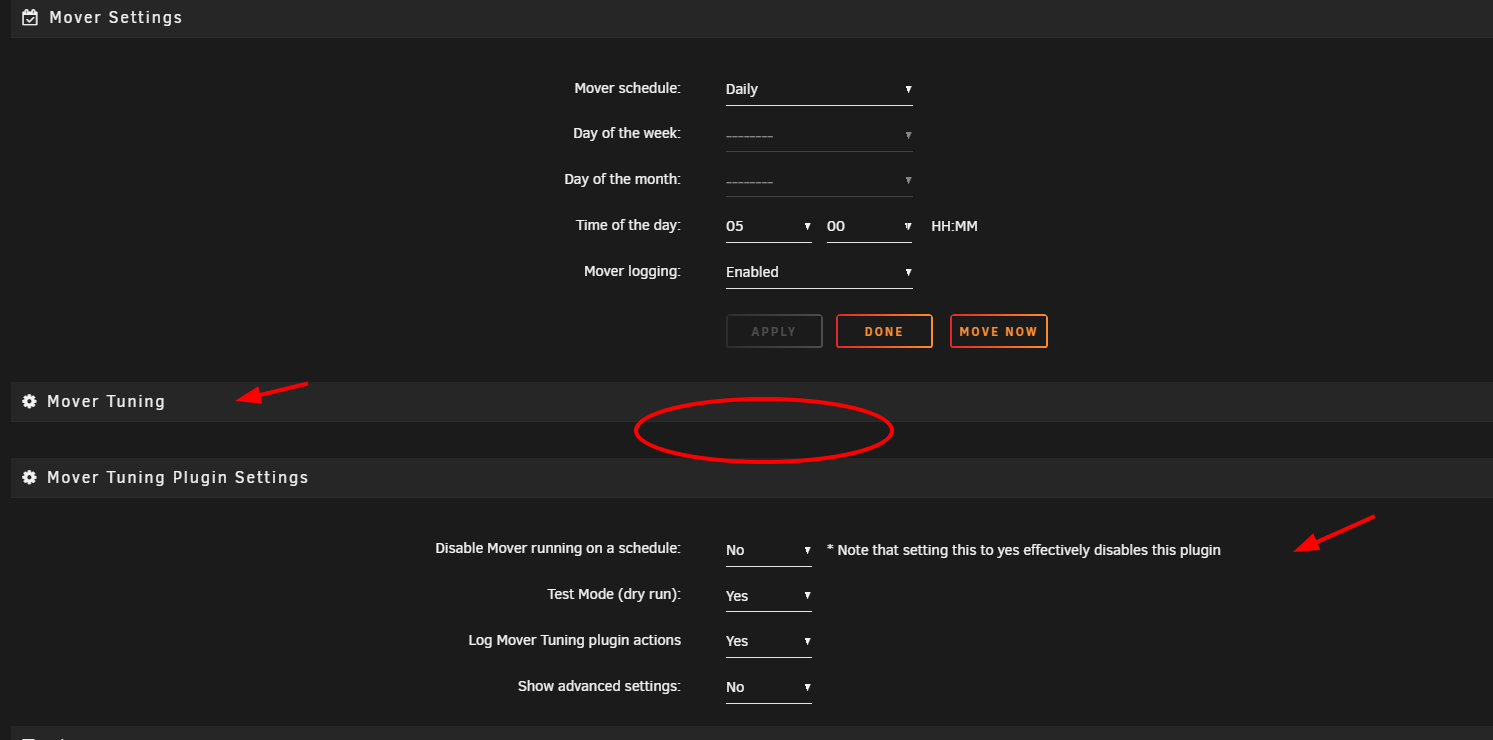

Same thing for me.
3 hours ago, BeefIsForDinner said:
Same thing for me.
Same for me. Mover settings are gone.
V7 rc2
Edited by Raider_M
Same thing for me.
here it changed the layout, more strctured in seperate ... may also on your mashines and didnt noticed ? scrolled down ?
Sorry for being so zoomed out, but just to show there is no mover tuner section at all in schedule.
The plug in is installed, I also tried a reinstall.
