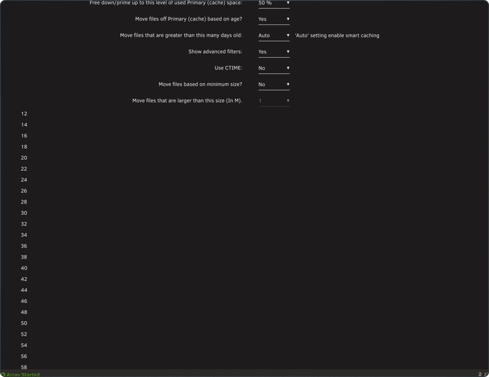

21 hours ago, droid said:
display error

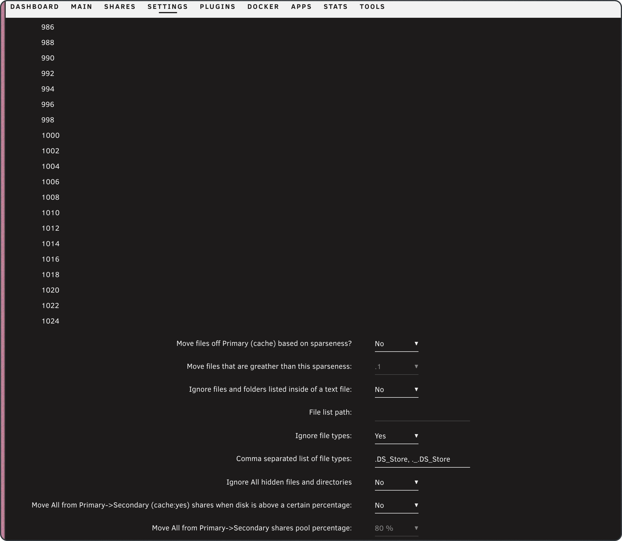

I'm getting the nearly the same...numbers listed from 1 to 1000 (each a new line). Mine are fully left-aligned whereas yours seem to be nested under the "Move files that are...:
2024-11-19_22-25-02.thumb.png.b2b6210ac1d5d4720f50d6e8f0caeff7.png2024-11-19_22-25-17.thumb.png.a4054f4d6416a4a32ded276cc93ff2dc.png
does it do it in every browser you try?
perhaps there is an issue with the theme you are using, or some browser plugin (an ad blocker trying to block scripts for example?)
I reinstalled and switched browsers but nothing worked

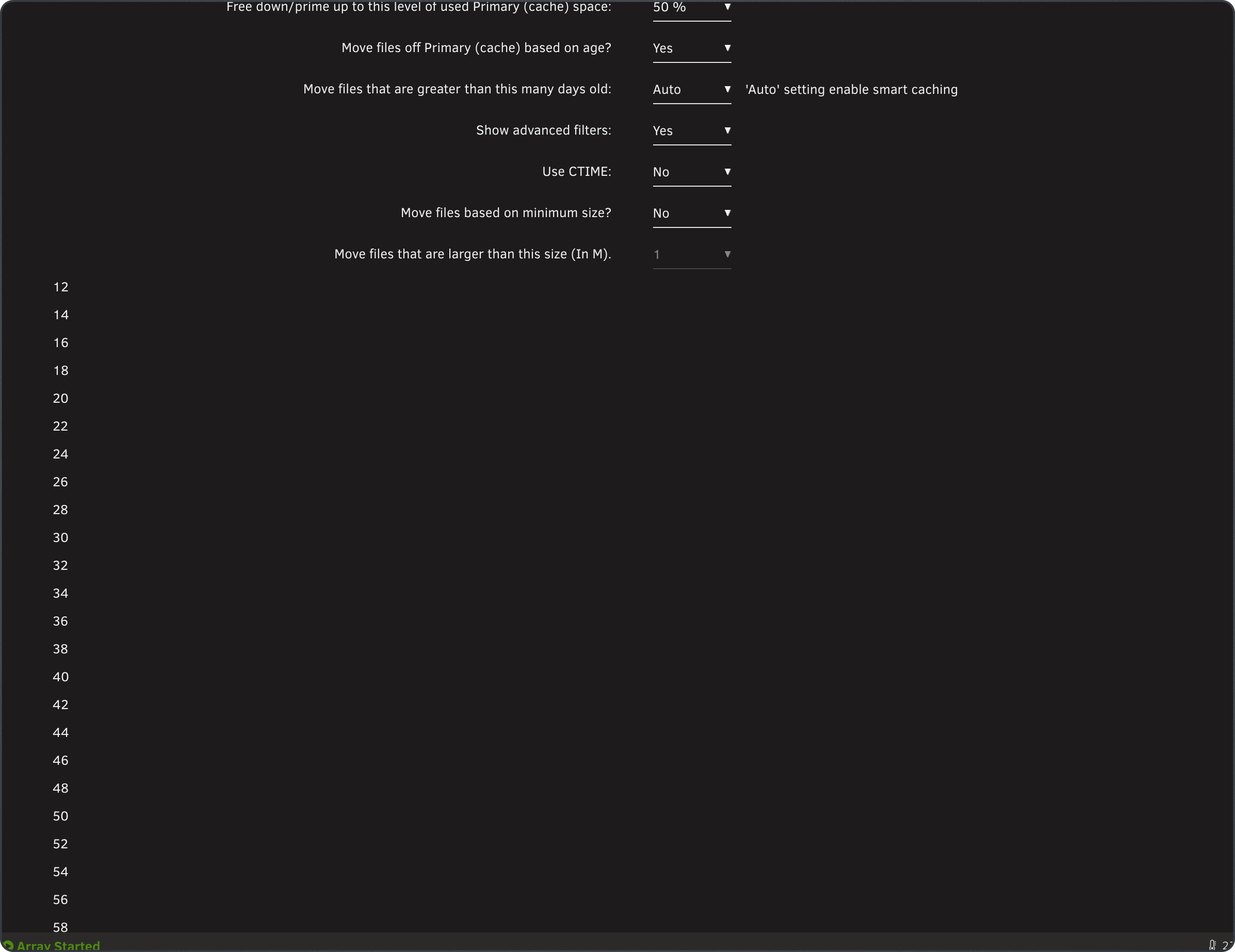

I'm getting the same numbers carrying on forever. I'm running it on unraid 6.11.5.
I still can't get it to ignore files in a list either on the newest build.
Same here, ignoring files doesn‘t work. (7.0.0-beta4)
I can see the line in the code that is definitely causing it, but I don't know why that one is behaving differently to the age drop-down that works.. PHP is not my thing, my web dev experience started and ended with HTML4.
Unless its sensitive to the line break and tabbing in the .page file and that's somehow breaking it out of the <select> tags its in?
That's the only difference, and I didn't think any of that mattered for html, but I guess .page files for unraid are handled a little differently?
we might have to wait for a proper dev to get back onto this project. @Reynald has been away (he was moving house, then had some hardware failures etc)
I cant get my systems to render it wrong though, it all works fine on every machine and browser I have.

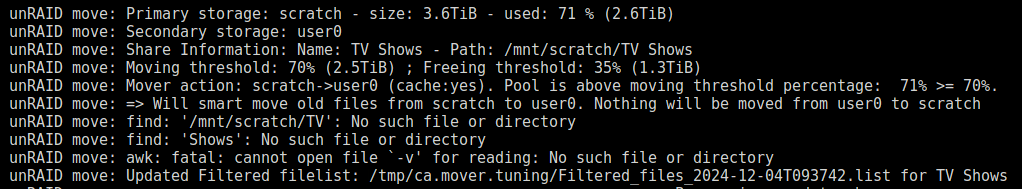

I'm running into an issue with this plugin, I assume, not correctly escaping a "space" in my "TV Shows" share name, thus producing an error (see attached). I searched for this topic and found some others who have experienced similar issues recently with "special characters". The advice given seems to be renaming shares or filenames, which frankly is not an option I'd like to consider at this point - primarily due to breaking other functionality.
Is there really no other solution than re-naming shares/folder/filenames? I've used older iterations of this plugin that did not have the same problem, so I'm just curious what may have changed that would be causing this. I'm very appreciative of the functionality this plugin can provide, so I hope there are alternative solutions to this issue. Many thanks!
rewriting some code parts  ... im sure @Reynald will look into it once he has some time.
btw. "special characters" and spaces are always not a good Option as note as they pretty often are interpreted as "funtion" ... but yes, a space shouldnt be too hard to solve ;)
and about renaming, a simple TV_Show (underscore instead space) helps already ... and almost looks the same

So I did end up making the change to only the share name ("TV Shows" to "TV_Shows") and it seems to work with all underlying files! Many thanks!
Now I have a follow up question. I did a trial run in test mode and without going into all the details it definitely looks like it wants to move the files I most recently moved onto my cache pool, instead of the much older (up to 3 months) worth of data. I'm talking about things that have been moved onto cache within the past week. I'm using the 'Auto' setting for moving files based on age. Any thoughts why this would be happening? I was expecting the opposite behavior
EDIT: I think I've answered my own question. Many of the files don't have recent modification dates, despite being transferred recently. I'd probably need to make more deliberate attempts to re-name files (or similar) to reset the modification date.

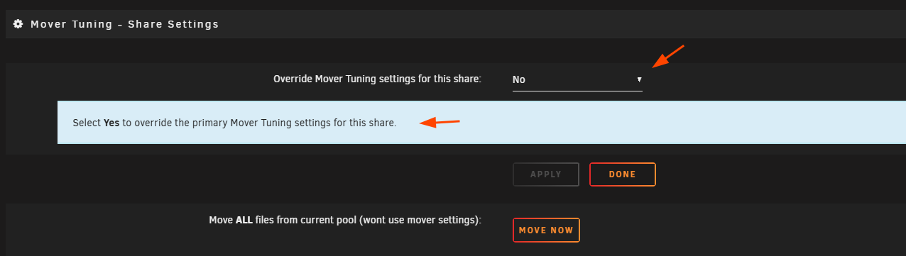

Is there a way to use this plugin to force any contents of a specific directory to be moved?
I like the idea of allowing some recently created files to sit on the cache, speed up access, etc, which this plugin seems to allow (using filter threshold percentages). But there's a directory in my share that gets large files added regularly, which can be moved straight off cache into the array. They're backups, and won't be accessed again for weeks or months. So I'd like the mover to move those always, and then maintain a % buffer in the cache of recent files.
I suspect the way it's written wouldn't really allow this, and I almost need 2 different mover configurations. One that just moves the backups, and one that then manages the remaining files at the desired threshold %.
if its a seperate share ... yes
inside the share settings, scroll a little down
would always move like without mover tuner ...
Edit, sorry, there you set your individual settings for this Share ... ;)
