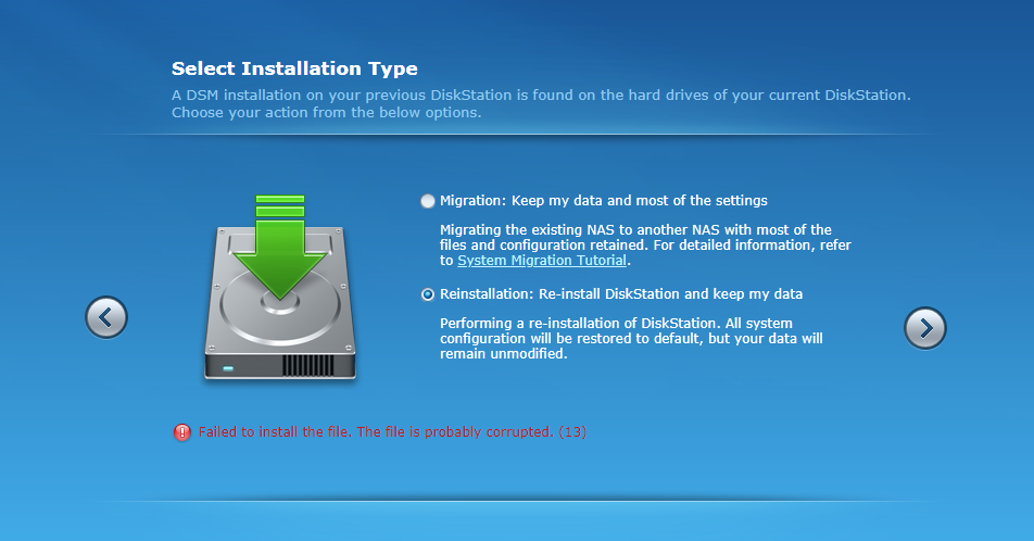

    Update: Was able to install 6.2.2-24922 DSM as a VM.   This is what I did:   - Used bootloader 1.03b. - Used DS3615 - Installed DMS version 6.2.2-24922 (also tried DSM

    Just saw this thread and I would like to share my previous experience. (I installed it months ago and dont remember all the details, hope it can help)   - Linux VM - I assigned 1 core (

Hi everyone
I seem to be stuck - the "find.synology.com" dosent work? but if I go to my router I can see a new Diskstation with a IP that I cant access?
Have read this thread over and over again and the solution eludes me?
I am using the standard bridge? (And my Unraid server works perfectly with other VM's)
I also need to pause and do a force stop - normal stop of the VM doesn't work? is this normal?
BTW: I also tried changing the Bus to 4
<domain type='kvm'>

OK finally managed to get it found by using the actual IP
But any package I try to install I get this:
Do you have any special setup for inputting a VID and PID? (if then how?)
(I also added the serial generated and I added the mac address to the synoboot.img still get the same error?
Only thing I didn't couldn't update was the VID and PID (Is this needed on a virtual USB stick?)
Edited by casperse
Ok after contacting the Xpenology forum I decided to go back to DSM 6.1.7 and it works!
https://xpenology.com/forum/topic/24168-dsm-621-on-unraid-vm/?tab=comments#comment-129798
But any attempt to use any of the loaders used for DSM 6.2.X gives above error?
