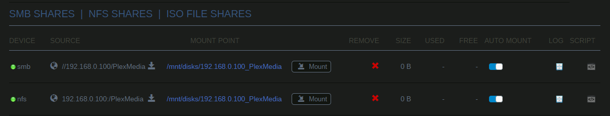

Hey Squid,
So I created the /mnt/disks/192.168.0.100_Plexmedia share created with Unassigned devices and added it a Host Path.

I think I may slightly undereducated on UnAssigned Devices. And I may be lost with Unassigned Devices.
Once I create an SMB / NFS or create a new - Access Mode is not an option

Possible solution found. Not sure if this is the actual solution though.
I was trying to work out the issue after looking at both replies.
There are probably other factors involved.
What I did was:
- Add the Unassigned Device Shares (/mnt/disks/192.168.0.100_PlexMedia)
- Remove the Plex server without removing image
- Removed my Grafana dockers that I was working on.
- Go to Apps
- Search for binhex plexpass - This is the one I use
- Installed as default ( I did add Host Path 2 as /mnt/user/PlexMedia but I don't think this part is relevant)[This is still set as Read/Write)
     - Name: Host Path 2
     - Container Path: /mnt/disks/192.168.0.100_PlexMedia
     - Host Path: /mnt/user/PlexMedia
     - Access Mode: Read/Write
- I logged into Plex web gui
- Went to my empty Library that was already made
- Edit
- Add folders
- Browse for media folder
- Click 192.168.0.100_PlexMedia (which finally showed my subfolders and click the one I needed)
- Add
- Save Changes
- Scan Library files and it started re-adding them in

Why are you involving Unassigned Devices? There is zero need to mount a local share via SMB.   In the end, what you're doing does work, but it's working by luck since you're probably not understanding path mappings properly on docker containers, and the naming of your container path reflects that.
I would suggest to review https://lime-technology.com/forums/topic/57181-real-docker-faq/#comment-564306 and @gridrunner's video
https://lime-technology.com/forums/topic/54834-video-guideall-about-docker-in-unraid-docker-principles-and-setup/
The container path is just something you make up and then refer to inside the container. So that container path, while it looks like it refers to the Unassigned Device, is really just a path you have invented that happens to be named like that. It has absolutely nothing to do with the Unassigned Device. If you were going to refer to the Unassigned Device, it would be with the Host Path, since it is only the host that knows about the Unassigned Device. The mapping you have is just making the docker container use that IP-named-but-not-really path inside the container reference the Host path /mnt/user/PlexMedia.
You really need to understand volume mappings or you will just continue to be shooting in the dark.
