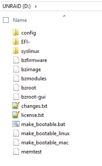

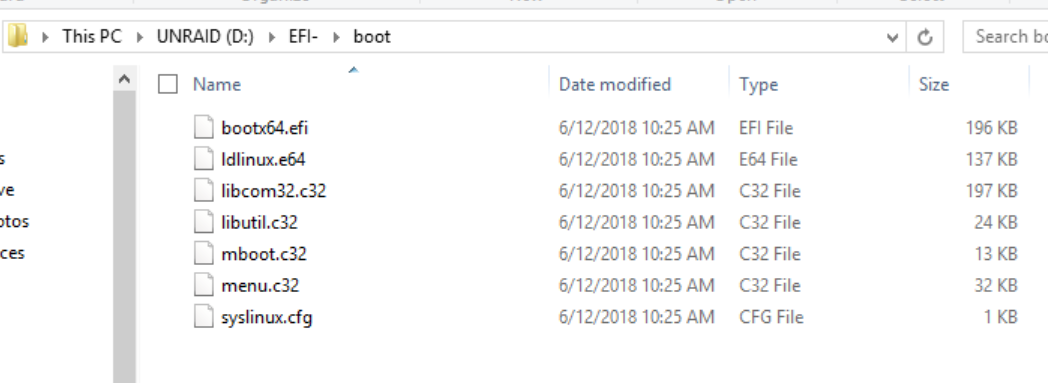

Except that when i plug the USB stick into my (Windows 8 for the record) laptop that directory doesn't seem to exist.
The closes i can get is 'EFI-/boot' but there's no /logs directory
I'm sure I'm doing something wrong. Appreciate the assistance.

/boot just means the root of the flash drive.  Is there the logs folder in the root of the flash drive?
Nothing there either
Sounds like the stick was not prepared properly, or is incompatible. Are you SURE it's FAT32?
