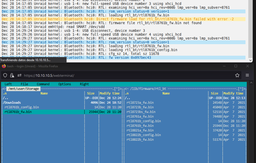

  • That worked, I adde the below to my /boot/config/go:   sudo curl -L https://raw.githubusercontent.com/Realtek-OpenSource/android_hardware_realtek/rtk1395/bt/rtkbt/Firmware/BT/rtl8761b_config -

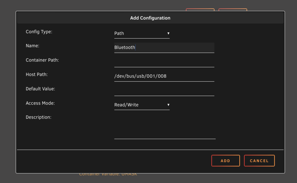

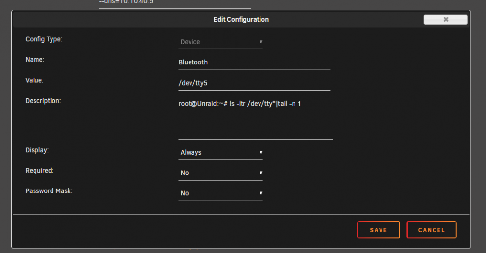

    After messing with this for a bit I realized I could in fact pass the specific USB bluetooth device as yayitazale attempted above.  The key was to pass it as a path.  Instead of doing  --device='/

Let me know how this works out.  There are a set of realtek bluetooth devices which require firmware and I've had a hard time finding the "official" firmware bin files.  We'll keep an eye out for them but if the device doesn't work and it's realtek, check the syslog to see if there is a message indicating "can't find firmware".
