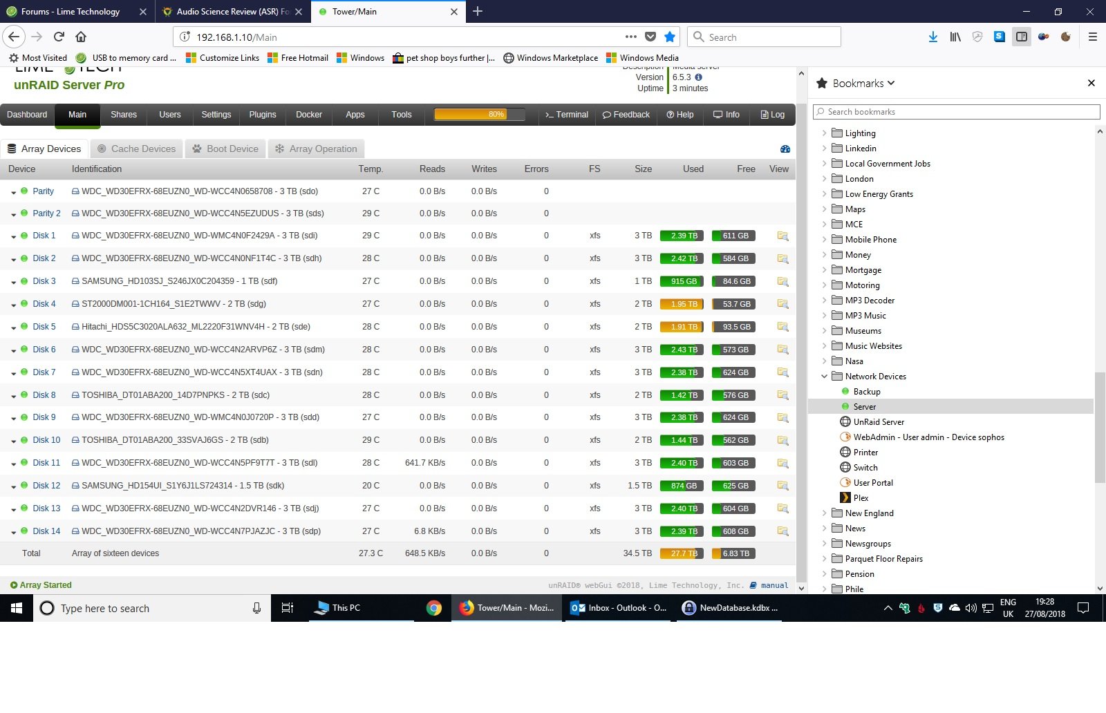

I woke this morning to find an email stating that Disk 1 had a read error.
Quick and Extended SMART tests were carried out, which finished without error.
Hoping that the drive was OK, I planned to stop the array, unassign the disk, stop the array, reassign the disk & let it rebuild.

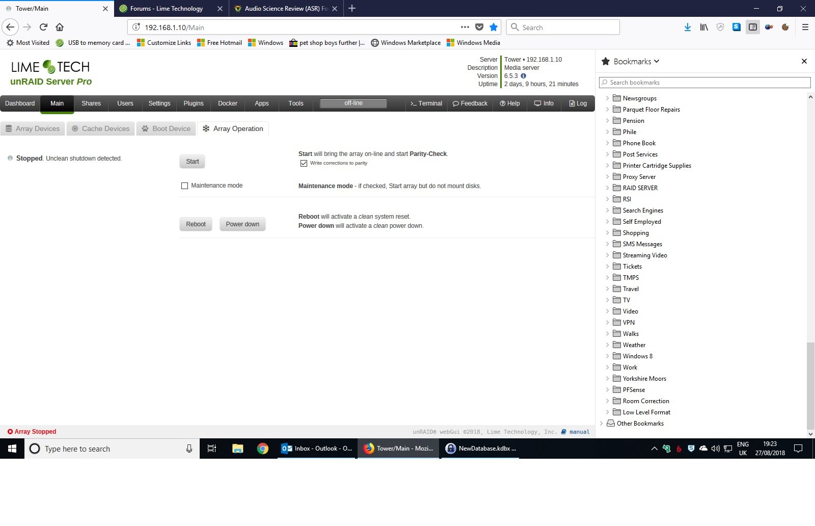

However after stopping the array, unRaid indicated that an unclear shutdown had been detected and that a parity check was required?
I decided to reboot the array to let the parity check occur, however it started up without running a parity check and no errors are now shown for the drive on the main page???
I attach a copy of the SMART report
On reboot I have just recieved an email to state unRAID Status: Notice [] - array turned good

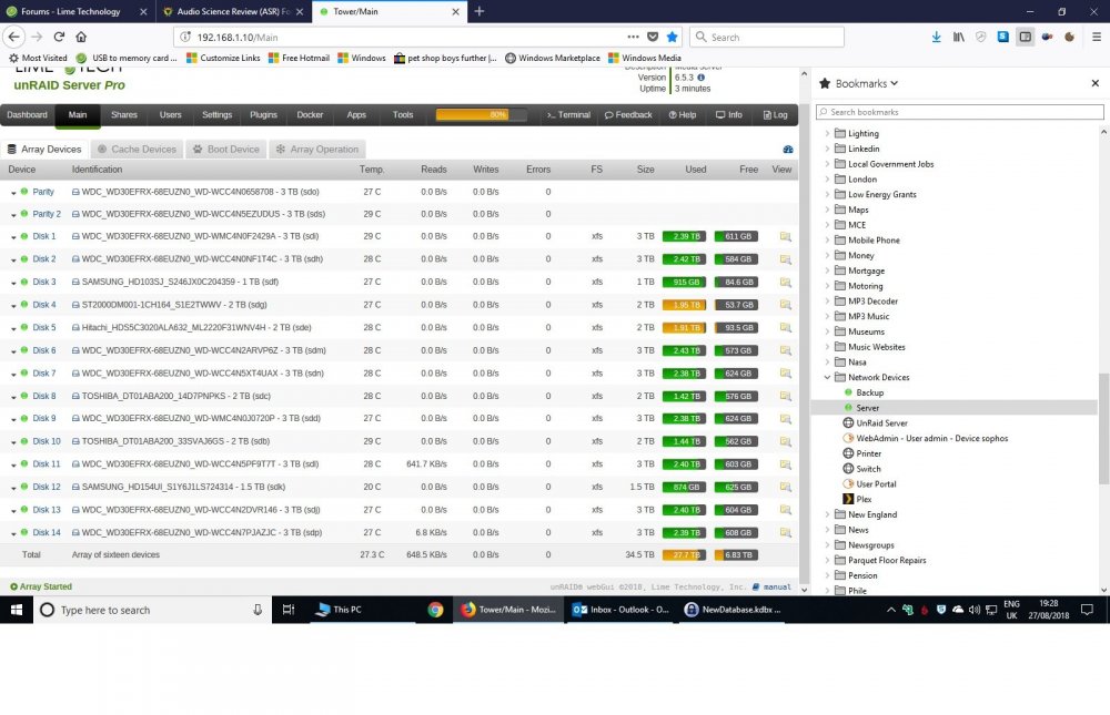

OH, one more thing was there a big red  X  in front of the Disk 1 on the Main GUI screen?
Please attached syslog.
The drive did not have red ball (thought that this only for write errors?)

unRAID itself does not notify about an unclean shutdown, you probably have one of the CA plugins installed, reporting about it.
